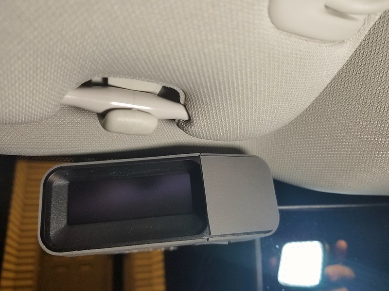

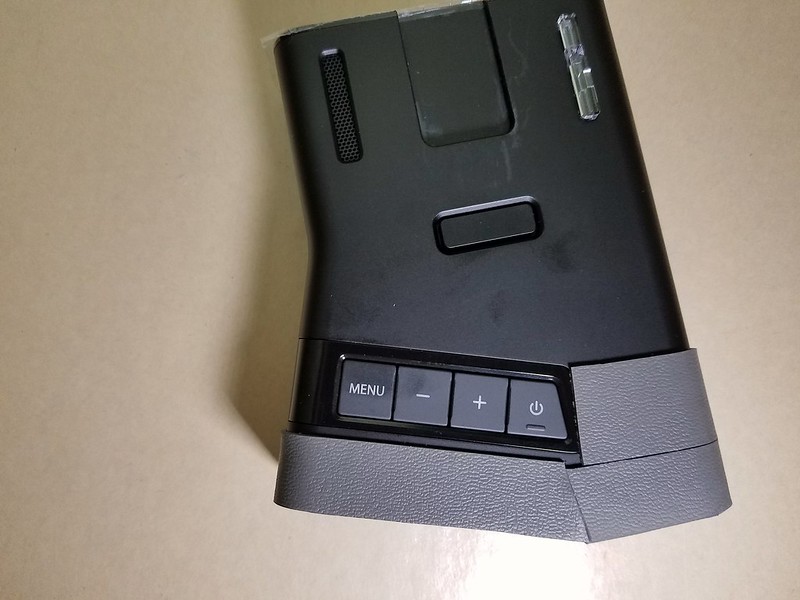

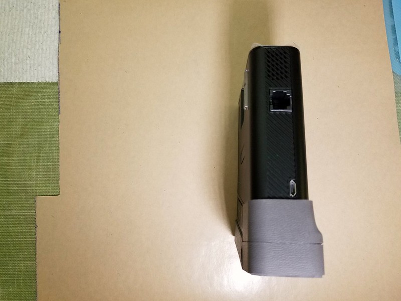

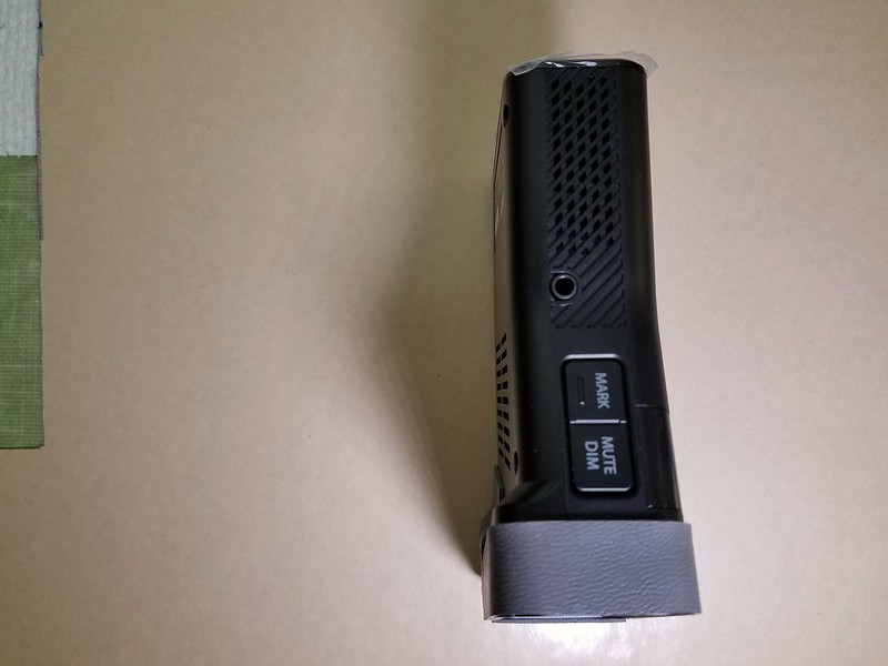

I have a CX5 2017 GT. I was using Uniden R3 since the day it was released. It works great with firmware 1.37. Latest firmware 1.48 will cause the annoying onboard K band falsing if you set the MRCD on. Just set it off . Right now I am using the Uniden R7. The first time I used it I was getting a regular onboard K band falsing from the RD's rear horn coming from the cars BSM. It was just not possible to use it. I had to tweak the RD and had to attenuate the rear horn to decrease the K band sensitivty.
I have it on Advanced. K band 50%/ K wide/ K filter on/ MRCD off. I installed an attenuator for the rear horn. I had 4 layers of the attenuator on the rear horn.
