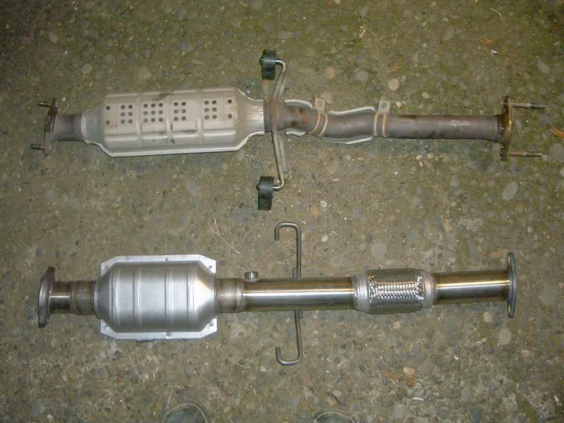

Alright, I received my SS midpipe w/ cat yesterday. Everything looked good - it comes with a gasket (for between the midpipe and catback) plus hardware. Unpacking took a little while because the ends of the midpipe were left open (so I had to pick out the compacted shipping peanuts).

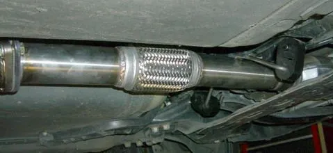

After a few confusing moments yesterday, I finally got it installed today. The confusing thing to me was the the only way the midpipe would install is with the cat forward (which brought it very close to the crossmember). After a call to MAM this afternoon, I was assured this was by design (I would have thought the flex joint would have been in the forward position... but hey, what do I know).
Note: For RB Catback owners, you will need to slot the provided gasket a bit for it to fit properly.

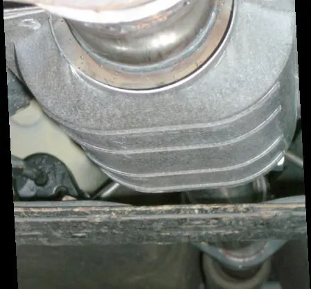

Note2: You will almost certainly need to chuck the heatshield under the shifter (that continues to the first bend in the exhaust) or you will almost certainly be guaranteed to have rattling issues. Do yourself a favor and take it off BEFORE you bolt on the midpipe :).

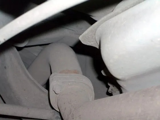

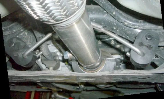

Once I got the midpipe in place and loosely bolted, I noticed the cat was sitting on the crossmember (zero clearance). I played with bending the hangers on the midpipe and ended up with about 1/2" of clearance. Don't bend them too far or your exhaust will end up hitting where it goes up and over the axle (see pics below). Once I had the clearance set, I tightened everything up.
Note3: Kartboy hangers are REQUIRED (IMO).
Note4: You will need a 18mm x 1.50 short bolt to plug the extra bung (I didn't pay for the extra bung, but got it anyway - so have one handy just in case). IMO, MAM should have provided this with the hardware - oh well.
Took it for a test dive this evening and didn't have any issues with rattling (although the bend over the axle hits the underbody when starting the car - no biggie). If it is louder than the OEM midpipe, it isn't by much - a little louder at the lower rpms. There was no increase in freeway droning that I could tell. Won't really know if I have gained any HP for a few days or so (via buttdyno).
