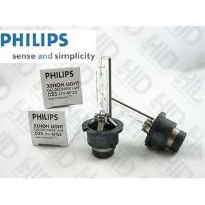

I know our light bulbs are H11 for low beams. But i've been looking at D2S bulbs that come as the factory installed option.

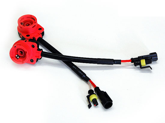

Can i use these D2S (philips made)? will they fit our regular head lamp? i know i have to use one of these adapters
http://store.ijdmtoy.com/AMP-Convertor-For-D2S-D2R-HID-Xenon-Bulbs-p/hid_adapter_01.htm
but will i be able to use regular after market ballast's?
will not work. the H11 and D2S bulbs are not interchangable.
if you want the best output, you will need to get a set of stock full replacement HID headlight housings. if you only want some crap HID's, you need to get an H11 replacement kit.
