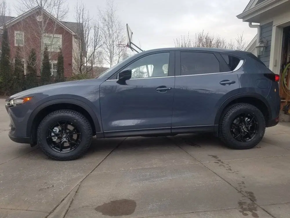

I just setup our new CE Turbo with Enkei Vulcan's in 17x7.5 45 and Wildpeak Trail 235/65R17. We have been running the WP Trails on our Highlander for a couple years and they work really well here in CO.

Those look great, exactly what I'm going for. Did you notice any significant change in road noise / handling / MPG ?
No road noise that I've noticed and the ride quality is improved in all conditions. I haven't paid attention, but I'm sure MPG will take a small hit. The 235/65/R17 WP Trail have XL load rating so they should wear well and the sidewall does feel a bit firmer than the SL rated 245/55/R19's we have on our Highlander. Worth any tradeoffs IMHO for more sidewall and a solid all season tire that does awesome with CO and WY roads and conditions.
