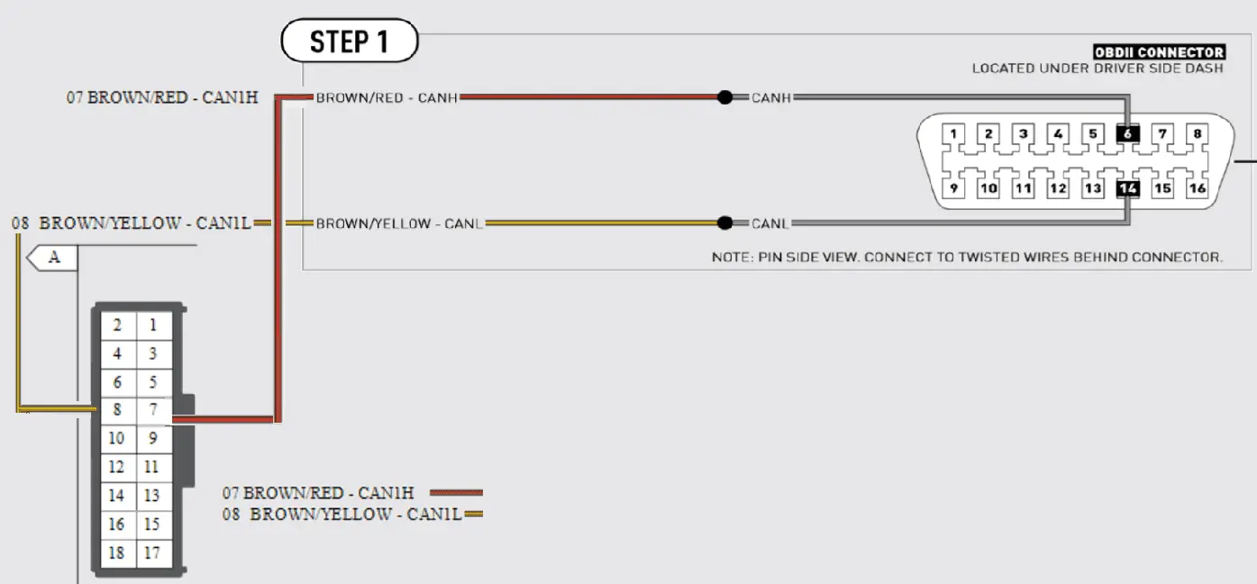

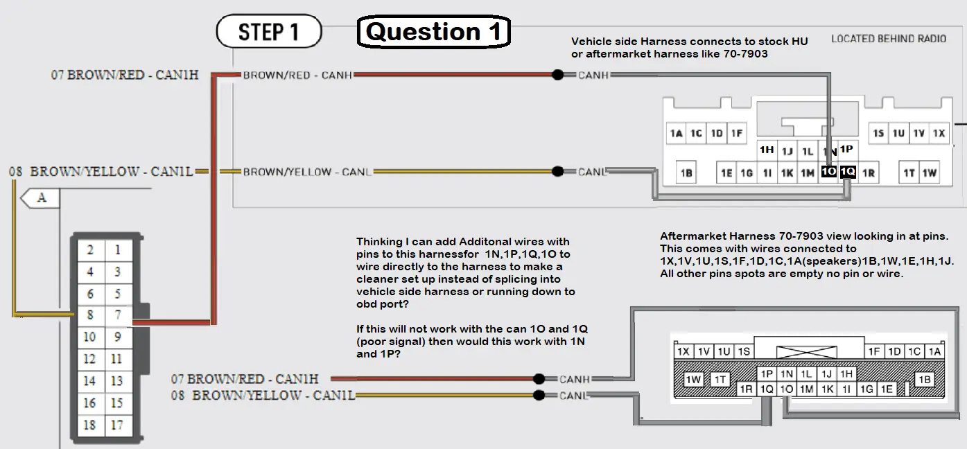

Step1
Step1>
Connect RR A connector pin:
07 Brown/Red wire >> to OBD reader port pin 6 wire spliced so pin6 still works with shop OBD reader
08 Brown/Yellow wire >> to OBD reader port pin 14 wire spliced directly spliced so pin6 still works with shop OBD reader
question 1> was if I can connect these to either vehicle side or radio side harness on pin 10 and 1Q which is labeled can_h and can_L?
I think the official response from Maestro will be what has been posted in there forums which is they use the odb port specifically due to signal strength etc.. even though they both run all over the vehicle connecting anywhere may not work due to well other items connecting etc.
I can live with that if that's the reason.

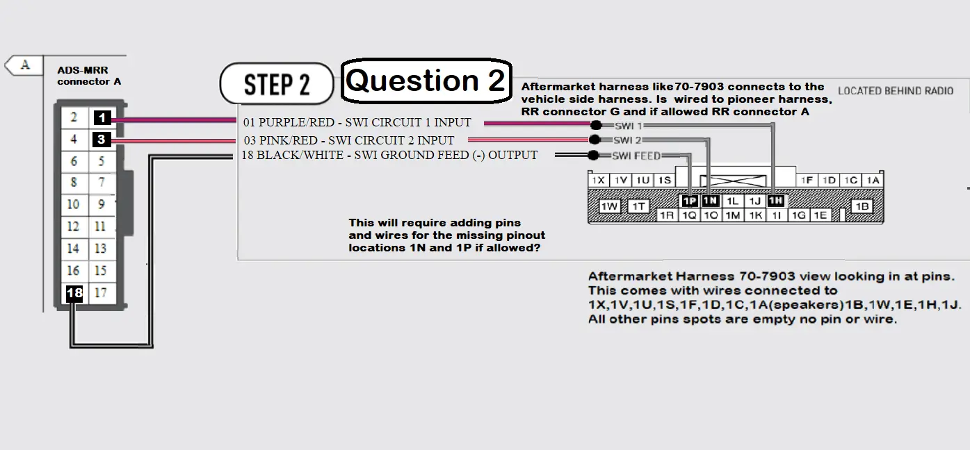

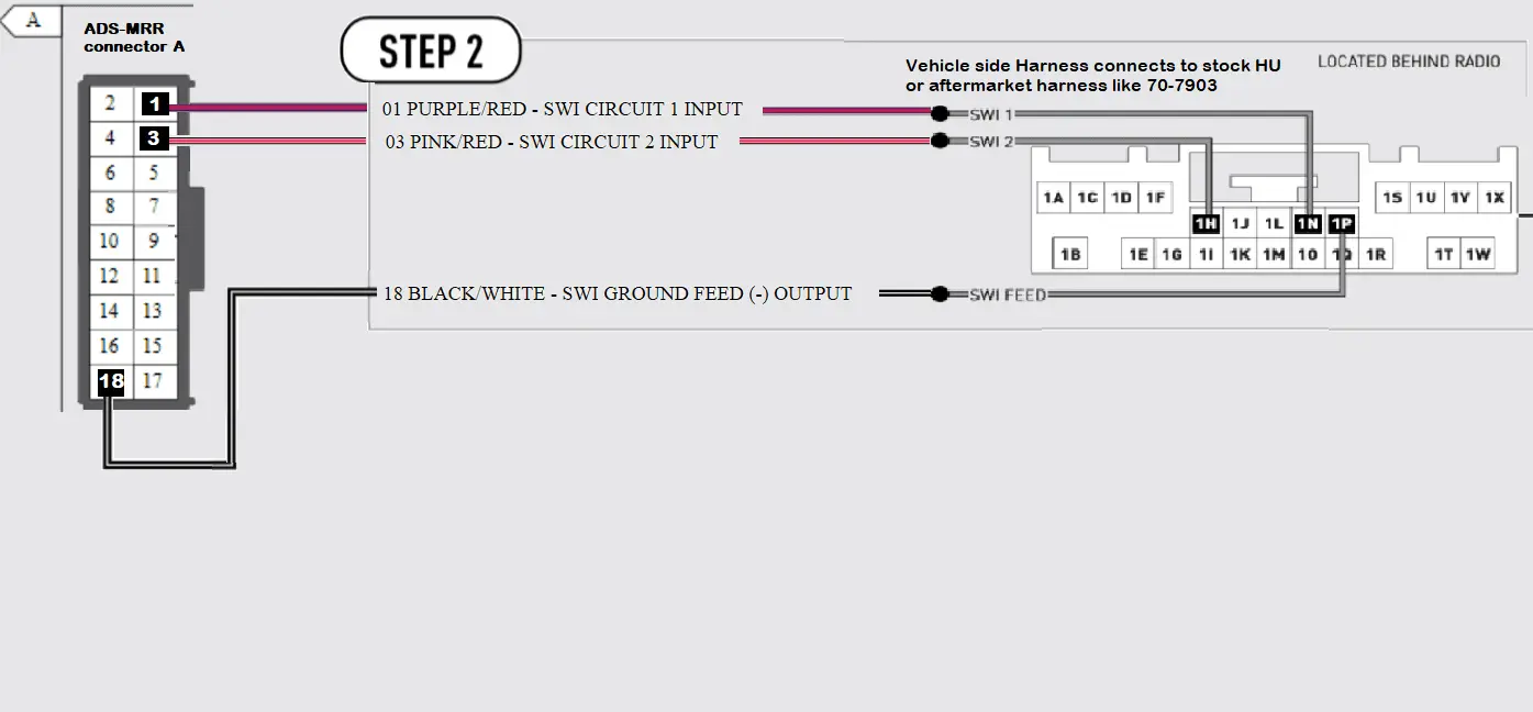

Step 2
Step2>
01 Purple/Red SWI circuit 1 input >> wire spliced to stock (not 70-7903) side of HU wire harness PIN 1N.
03 Pink/Red SWI circuit 2 input >> wire spliced to stock (not 70-7903) side of HU wire harness PIN 1H.
18 Black/White SWI Ground Feed (-) Output >> wire spliced to stock (not 70-7903) side of HU wire harness PIN 1H.
Question 2>Could these be wired to the aftermarket harness like 70-7903 at these pins if additional wires and pins are added or do these need to be wired and spliced to the vehicle side of this cable?

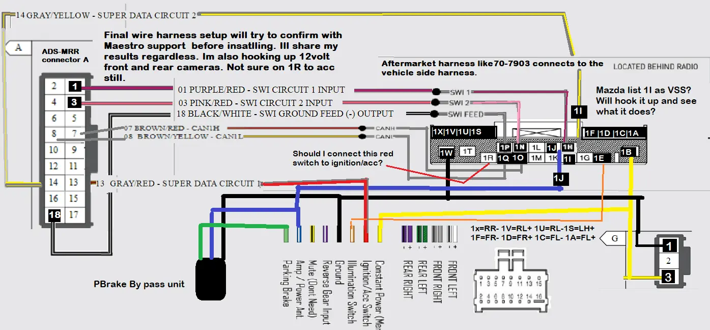

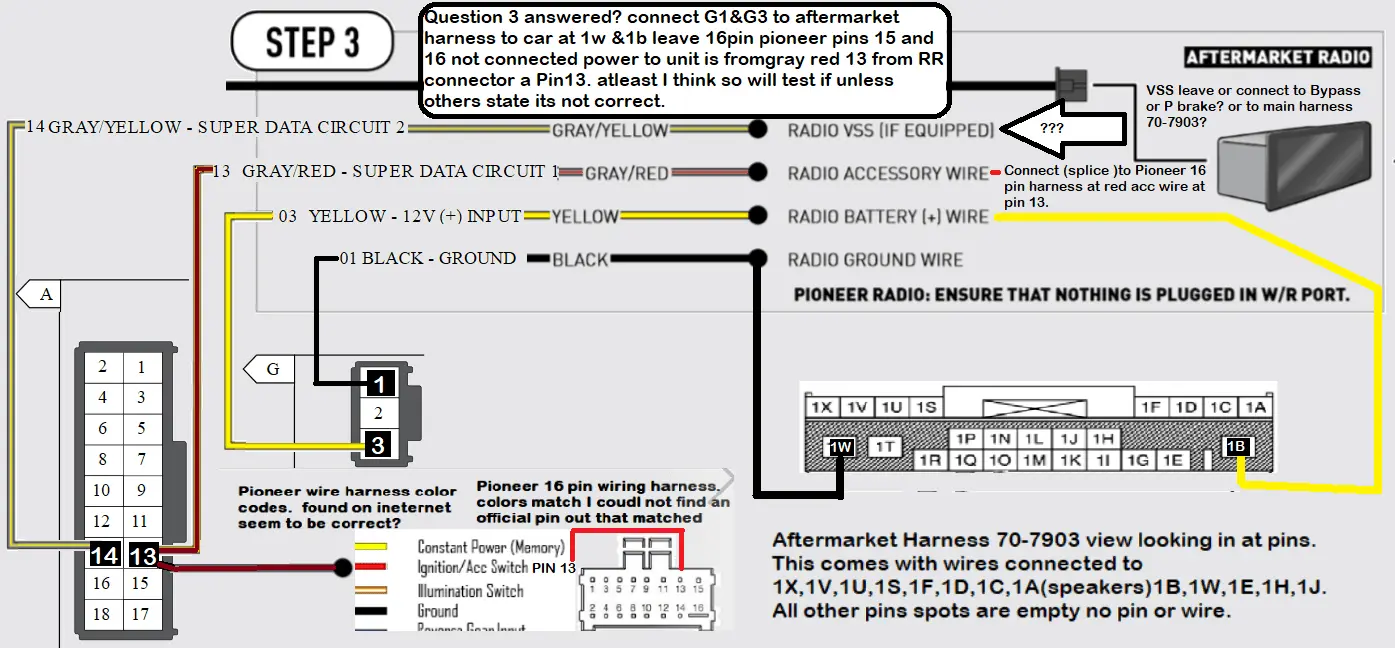

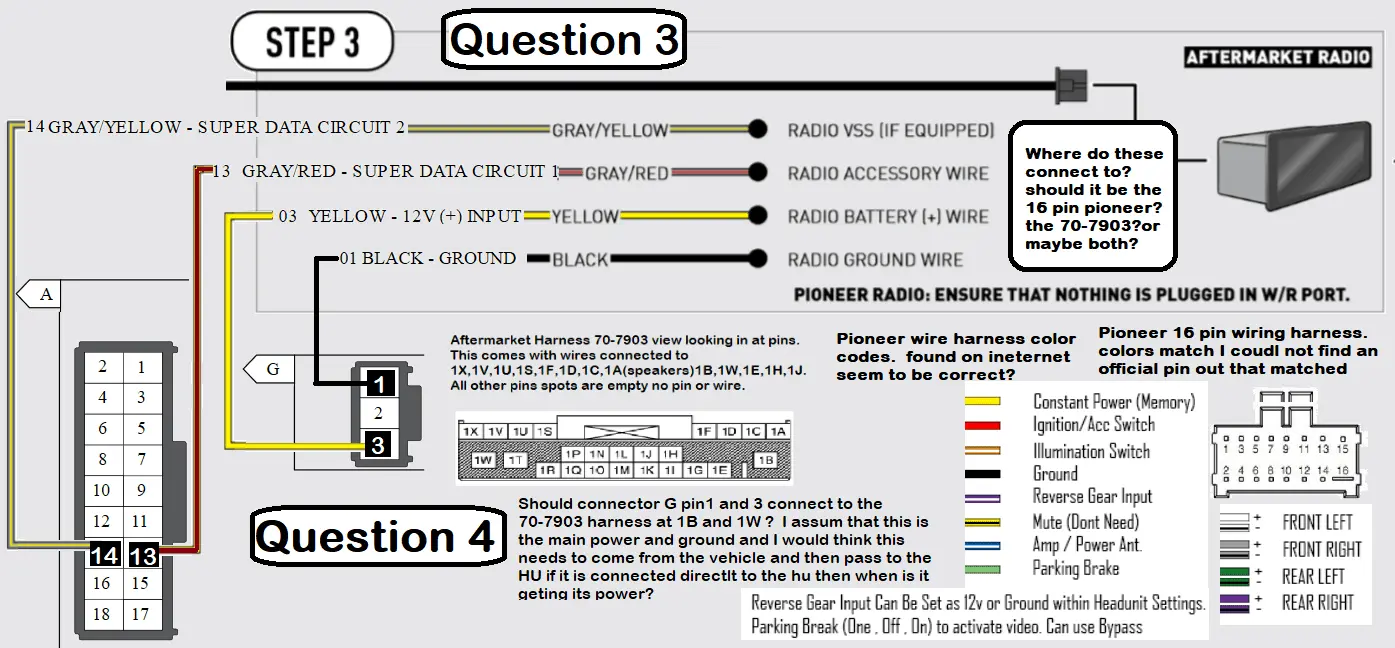

Step 3

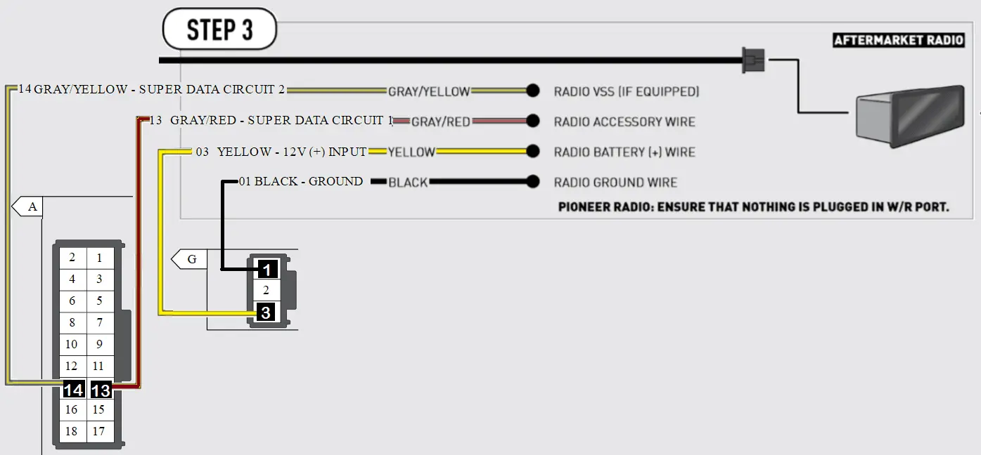

Step 3> Connect RR A connector pin:
14 Gray/Yellow-Super data circuit 2 Radio VSS(if equipped) > pioneer harness Pin 15 Yellow 12+
Gray/Red Radio Super data circuit 1 Accessory wire > pioneer harness ?
Question3-6 really to many random combinations of the above to make visual aids for
Question 3> would it work connected to (green)parking brake wire or (purple) reverse gear? none? On pioneer 16 pin cable?
Connect RR G connector pin:
02 Yellow Radio Battery (+) wire > pioneer harness Pin 15 Yellow 12+
01 Black Radio Ground wire > pioneer harness Pin 16 Black Ground
Qusetion4>should these be also connected to aftermarket harness same color wires?

I think I figured out Question3 and 4..
says battery wire so direct to vehicle with the harness found a forum response on the RR forum stating that power comes in to G and then out to head unit from 13 grey/red so I'm connecting it that way and leaving the pioneer 12+ yellow and ground black wires not connected at the 16 b pin pioneer harness that connects directly to the head unit but have 13 connected from RR a to it on the red acc wire. still not sure on the VSS will leave it disconnected until its sorted.
Think this is correct? will attempt a call to Maestro before hooking up. the support techs seem to confirm some users to splice 12volt constant to g connector harness and radio as correct but then others state they did not hook up radio and they also confirm that's correct? these devices can be customized per vehicle which may account for the mismatch setups so not sure?

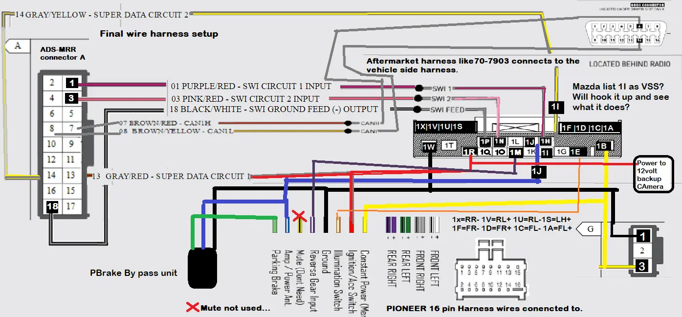

wires not connected to anything still
70-7903 Harness connect to auto and pioneer harness and MAestro plugs
Red 12volt Switched PIN 1R.
Should I connect this to the pioneer red ACC plus 13 gray/red or leave disconnected or use for cameras power?
16 pin pioneer harness to radio and 70-7903 harness.
yellow/black Mute pin?
Purple/white reverse gear signal pin?
Here is the final diagram and everything is working steering wheel controls and OBD2 gauges.

Step1
Step1>
In fact I tried this today on a Mazda CX-7, didn't work.
Running an OBD2 extension way up to the console didn't work either.
Neither building a custom connector did work.
Can anyone post what was your working solution?

Turns out is easy to get the wrong wires. According to the Maestro's install guide:
Ensure the BROWN/RED and BROWN/YELLOW wires are connected to the OBDII (NOT the red/brown and yellow/brown wires).
Check connections at the OBDII connector. Make sure the BROWN/RED wire is on PIN 6 and the BROWN/YELLOW wire is connected to PIN 14 of the OBDII connector.
Do not use T-Taps. Soldering or military splicing methods are recommended. Reset the RR.
That was my case. After I used the correct wires it worked fine. I used a OBD2 extension, though, not the wires in the radio's harness.
