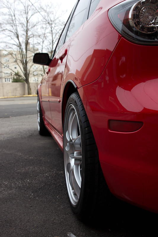

But yeah, like Lara I have 18x8 +40 and had to roll my fenders. And you can see why here:
This was with the stock suspension still (one of these days I'll take a new one to show the new ride height):
I only rubbed when I had people sitting in the back and went over a particularly nasty bump.
