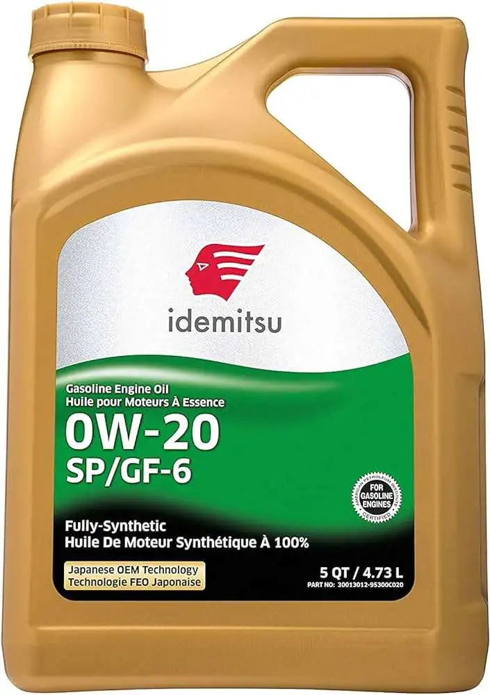

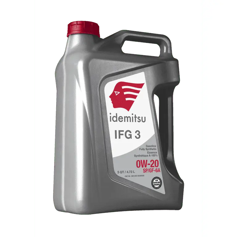

Question about difference between two engine oils
17 CX-5 Touring
I wasn't able to find any information in here.
Can someone explain or point me into the right direction.
What is the difference between these two type of oils.
What does IFG 3 means?
thank you.
ILSAC GF-6 will be split into two subcategories: GF-6A and GF-6B. The principal difference between the two subcategories of oils concerns viscosity grade and high temperature, high shear (HTHS) performance. The proposed ILSAC GF-6B will provide the same performance as GF-6A, but with the added aim of lower HTHS to deliver potential further fuel economy benefits. ILSAC GF-6B will be defined for 0W-16 viscosity grade oils only.
The silver bottle is GF-6A, which seems to be the same as the GF-6 of the gold bottle. Seems like it's just newer packaging with the updated specification.
Thank you.
I believe it is new packaging too. I just checked their website and they only have the silver bottle.
Also, one spec is backward compatible, and the other is not, according to what I read on the website.
