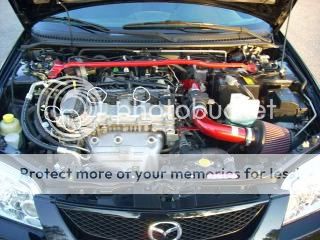

The circled connectors are the ones I disconnected. It is a protege 5 manifold. Where are these VTCS,VICS located?
On the side between the cruise control & intake manifold attached to the intake mainfold. Not seeing connection between unplugging the coils & now codes for VTCS.

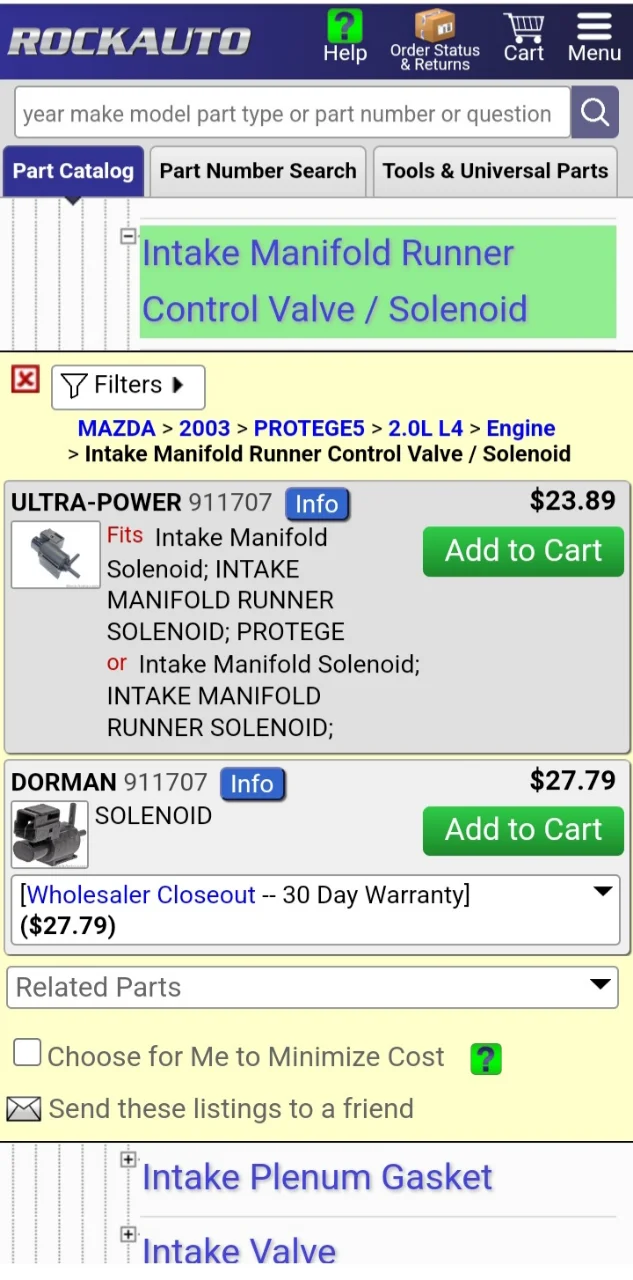

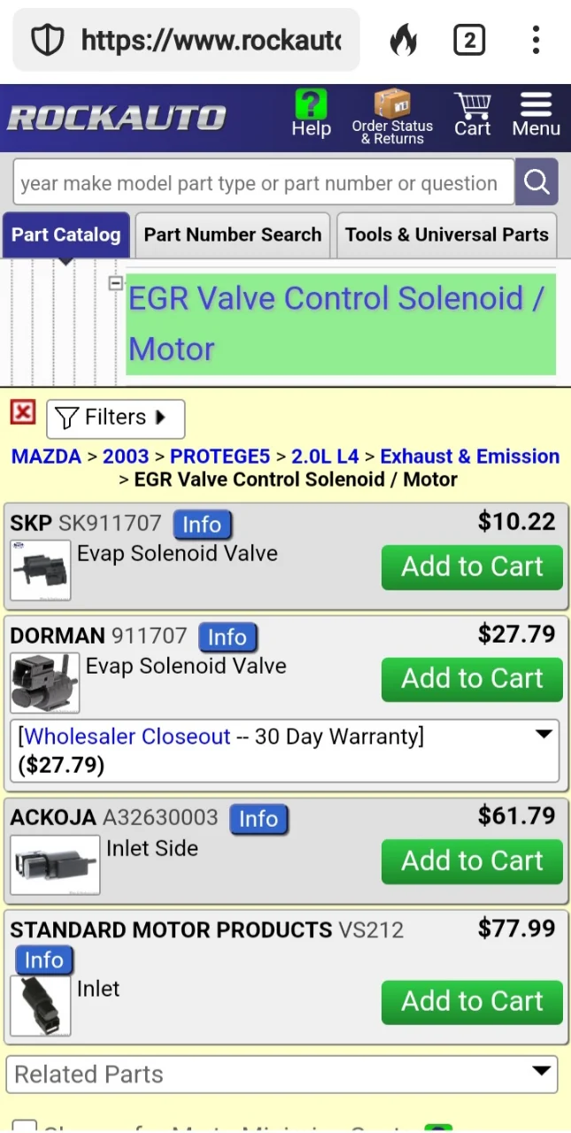

Replace your VTCS solenoid valve.
The code is telling you that the valve isn't working.
