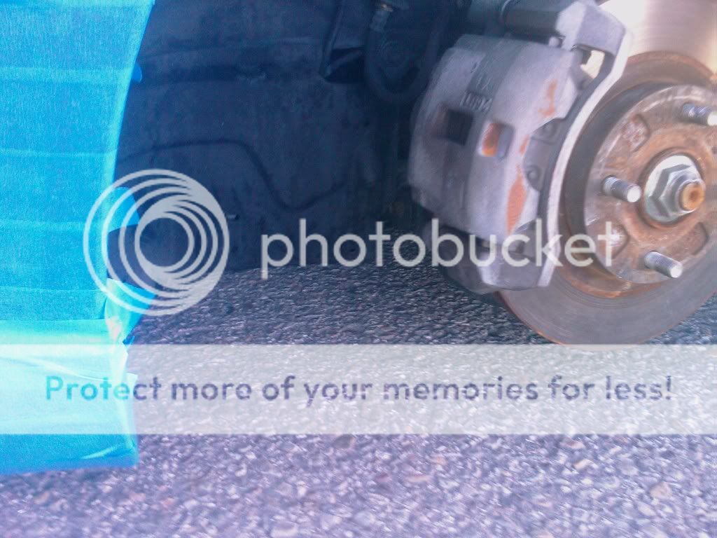

Had a major set back tonight. While making a turn my front driver side wheel literally flew off. The wheel continued down the road where hit eventually met a curb, the wheel is driveable but the lip is ****** up and curbed. My suspension was luckily unharmed and is fine. As is my brakes. One thing that isn't ok is my fender, it's gone. Unusable. The lip is folded over and crimped, the part where it attaches to the door is all pulled out. I'm so sad right now, right after I got it right were I wanted it, it's out.
I believe the cause was a mix of bad aluminum lugnuts and the spacers. The spacers left only 3-4 threads and it just is t enough All 4 lugs were stripped from the studs. So here's a warning, and please tell everyone who's bought, or is thinking of buying; Don't buy any lugs that are made buy "Vision Motor Sports"

Sorry to hear all this hope you can fix the car up again.On another note I've been rockin the same lug nut's for over two years so I really don't think that was the problem.More like the amount of thread that was left for them to grab onto.
Dang. Kind of scary to think about. I was thinking of going with 15MM spacers for my MSP for the RH's. Gonna have to check if the spacers will allow enough grab on the lugs. Thinking about using the full bolt on though so should be ok.
As long as you use the bolt on's, you'll be good
