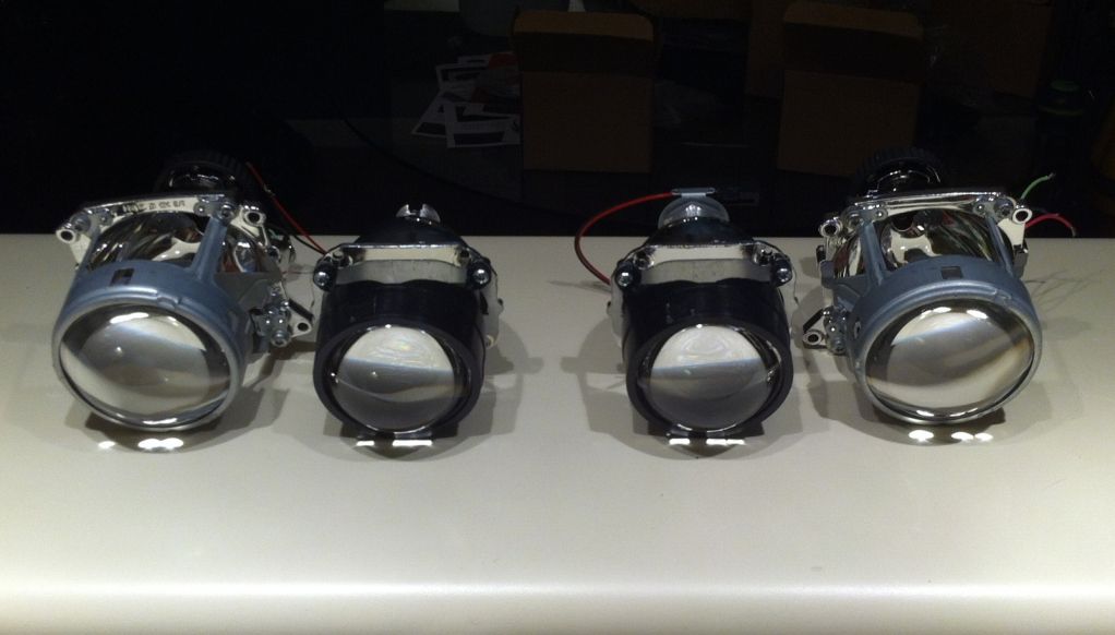

I've got quad mini gatlings already, but i might order a set of 2.0's for the outers and minis for the inside
Gatling 2.0 has a larger light vent and would definitely be better suited for CCFL's. I know it can work in a sedan. Do you think the P5's smaller lowbeam will handle a gatling 2.0?. The reflective lens in the back of the lowbeam is smaller than the reflective lens in the sedan. I don't know if the curvature is any different. If the shroud rests against the reflective lens in the back, a larger shroud may sit farther forward since it will be hitting different parts of the reflective lens that are curve farther forward. I hop I'm making sense
That totally makes sense. I really wish we had more ideas of what fits in the P5 housing without cutting. I would love to rock a Gatling 2.0 or G37R ...
^good god almighty my pants are tight. I know you were tinting the lenses red. That whole look is damn sexy
Sticky Notes FTW. Not sure the measurements on the shrouds or the P5 reflective lens vs the Sedan Lens. The website has different measurements giving the mini shroud a diameter of 120mm and a height. The website gives the 2.0 shroud a 120mm rear diameter and a 80mm front diameter. I know for a fact the base of the 2.0 is wider than the gatling
the problem i've got with the mini in the low beam is there is no way the mini gatling is going to cover the E46 projector

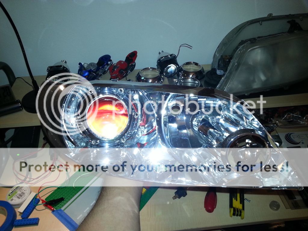

Are you putting the mini projectors in the parking light cylinder?
BTW, love the legos and the Xbox power supply for testing
nope, the minis will be in the high beams
Parking lamp will stay "mostly" unmodified. I'll be keeping the incandescent bulb for parking/turn signal but i'll be installing a 60mm XB Led halo around the outside (inside the clear lens) to operate as a DRL but will shut off when parking lamps or headlights are on
I was going to say, you should totally put the projector in the parking light spot and use the highbeam spot as a parking light/turn signal. Might look funky though. Are DTRL's required in Florida?
nope, but i'll take all the visibility i can get
It made a HUGE difference in people pulling out in front of me in the miata
but your idea is sounding more like a mazda6 looking headlight lol

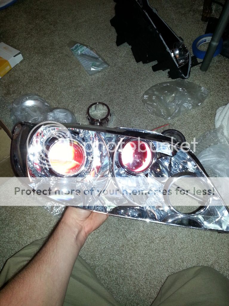

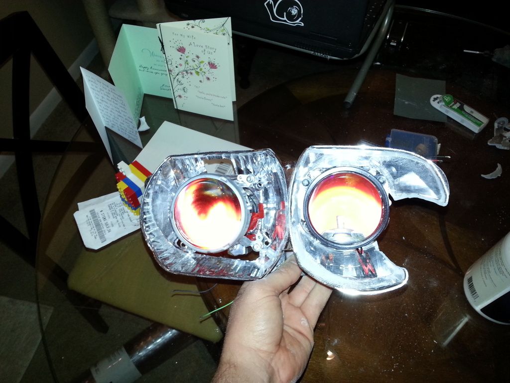

Cuts complete
Test fit both projectors
But I'm having a shroud issue. Can't use the same shroud for high and low
Thanks bud! Once these are done, I get to oen the Tl's to see how you did em
Oh and painted, but still unsure on a shroud for the mini

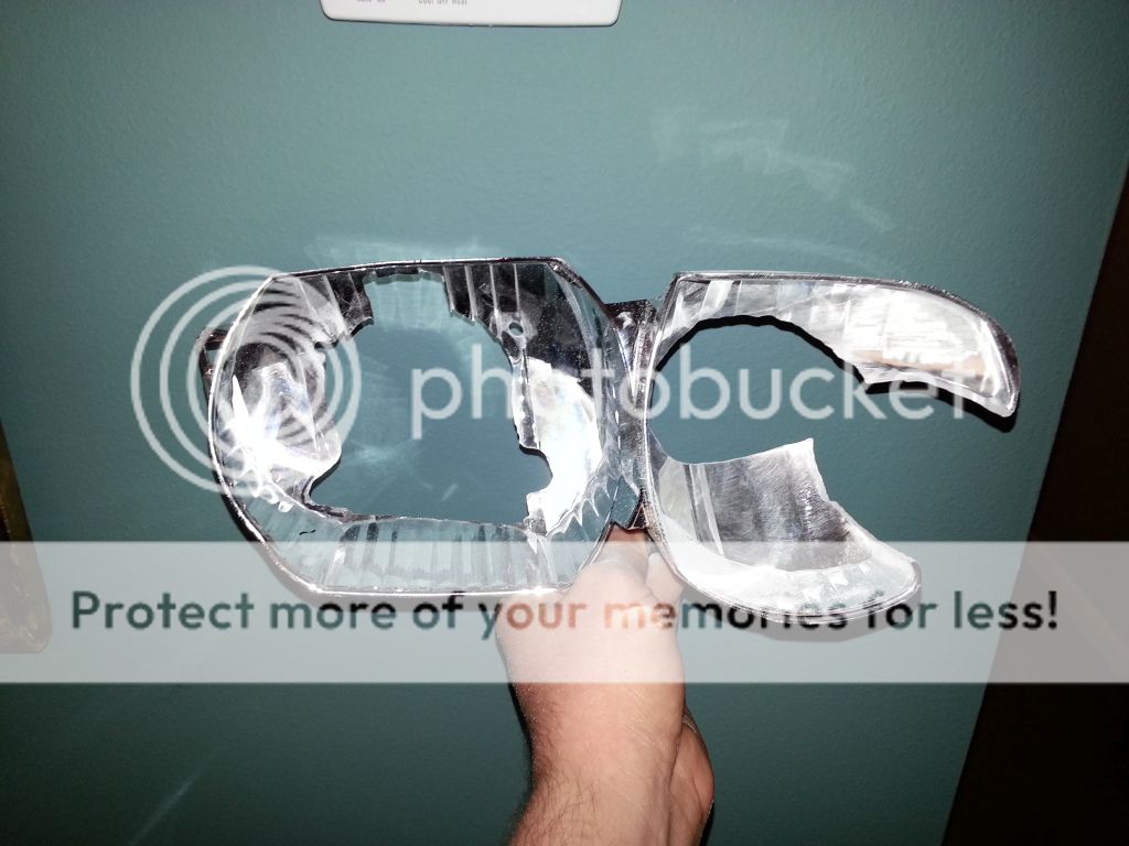

Also cut the holes too bigs so I also get to try to cove r the visible jb weld
But good news is both projectors are mounted and are parallel and look properly spaced but I won't know for sure till they're mounted on the car
