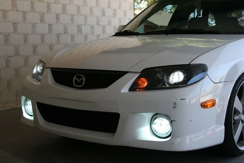

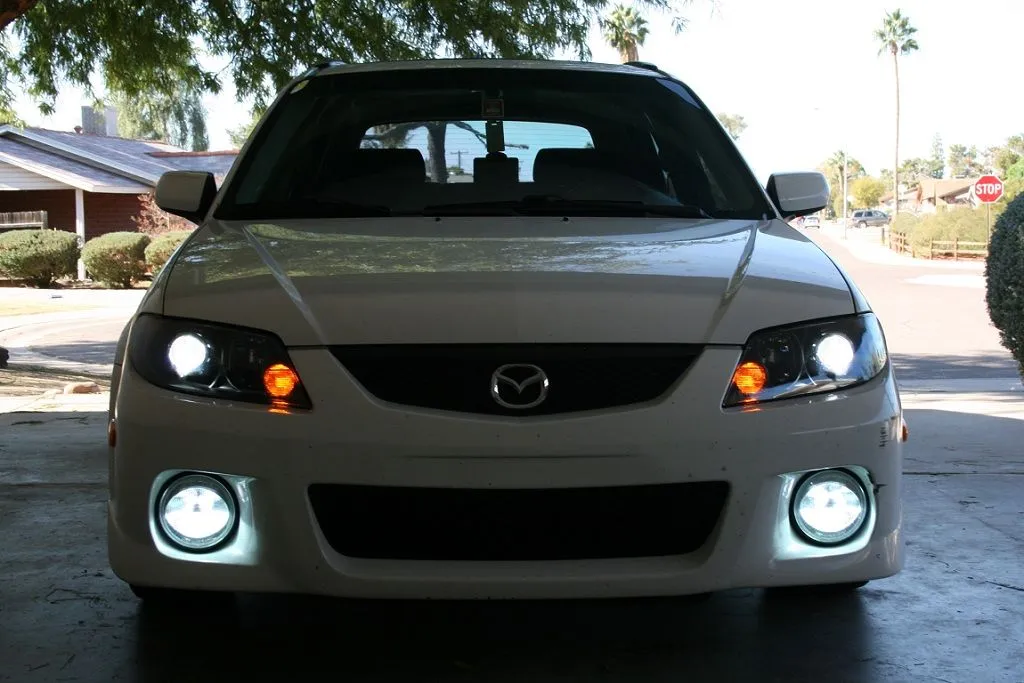

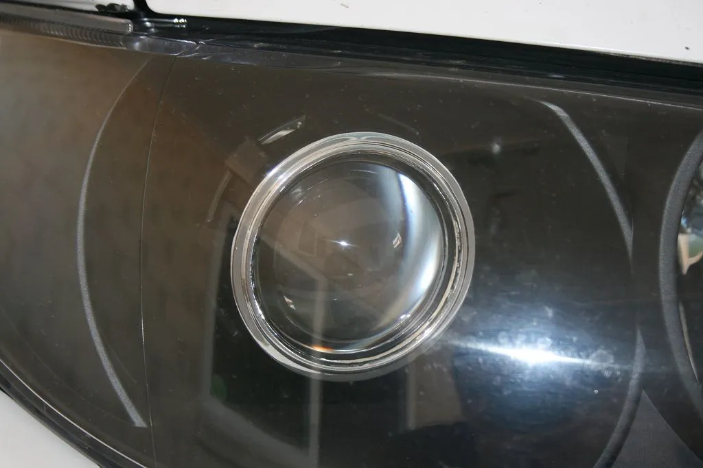

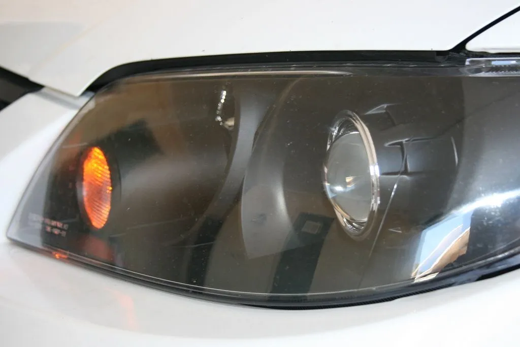

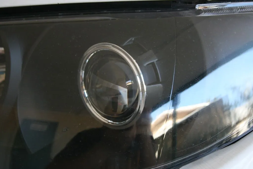

My Mini H1 Retro-fits
Pics of my HID proj retro's:

Love the retro! Digging the chrome lipas well
Jdm, you get a set from 808?
What HID's do you have? Like what temp? I love the color of your fogs.
And great retrofit, looking awesome.
Thank you guys for the positive feedback.
Morimoto Mini H1 Ver 5.0 with mini-gatling shrouds painted flat black but left the front tip chrome. Ballasts are also same brand with power harness all from The Retrofit Source (TRS). H1:Morimoto 3Five 6000k and H3C: Morimoto 3Five 6000k for the fog lights
