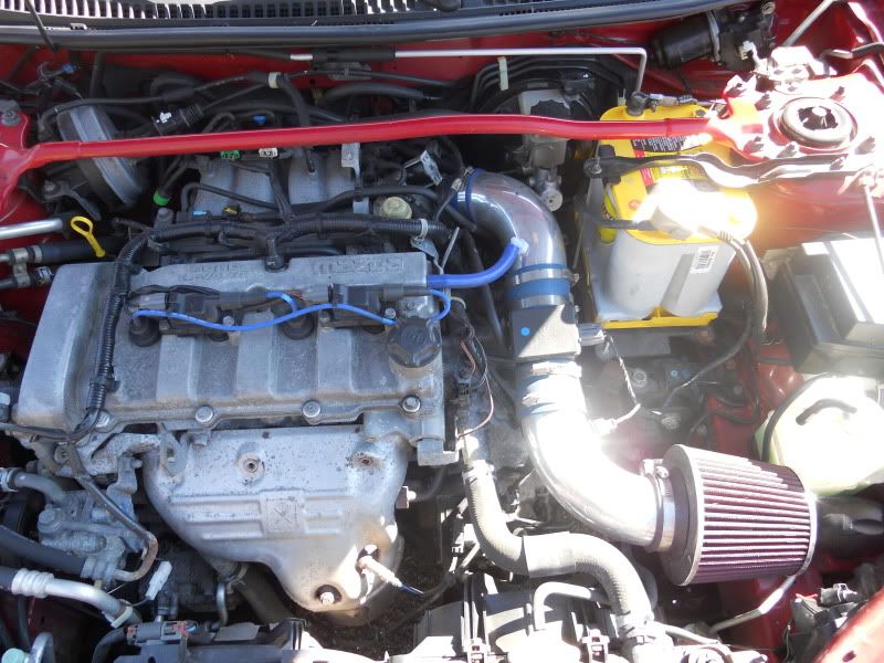

Installed the SRI, and took a quick test drive. Definite gain, and a nice deep sound with a faint whistle now and again. Only annoying thing is that the purge solenoid valve has an obvious clicking sound because it is no longer encased in the rubber brace that is removed with the stock intake system. Currently finding a work around. I'm sure someone on here has a work around...Vamp?
Lol, I just let mine hang, there really is no where to mount it anymore. I pretty much just left mine to hang/lay in the vast open pit left behind and am just waiting for it to go wrong to find a better fix, but for now I have had no issues
You can kind of see it in this pic that I took yesterday of the engine bay, there is no mount made, everything just kind of laying there where it would've been had the stock intake was still there:
Nice. I just needed to reposition mine. First, I tried to zip tie it to the sway bar, but that put it too close to the ventalation system, and that did not absorb or supress any of the clicking. It is all good now because I cut the original mount out of the stock intake system, and wedged it in between a couple things. It is no longer clicking. I'm loving the new sound and the little extra power I'm getting. SRI works well in Colorado!
