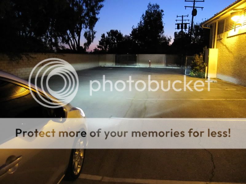

Oh boy they definitely are bright enough for me! Especially the driver side headlight that beams like a 2000 watt searchlight! :D I would love to have both of my headlights beam like that. Guess this is the really fun part about mods, the tweaking, repositioning, all the fooling around, and eventually getting it right. Please do post your results as it will help the rest of us get it right. :)
After fiddling with several ultrastars, I know how much fun it is to get both the bulb sitting like it should, as well as getting the wire spring clip to the correct second position.(drunk)
Yah the bulbs are slightly out of position... you really have to get the retainer clip to secure the bulb. It took me about three frustrating tries, but the end result should be a bright uniform light with not bright spots except a teeny one just around the centre of the cutoff. Good luck!!!

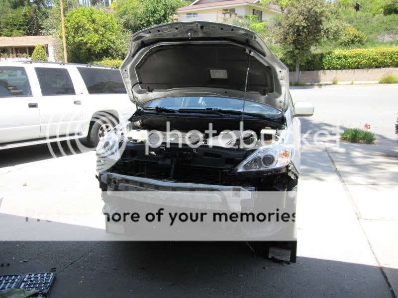

So right after the shoot I decided to try and wiggle the Pass bulb and boy did it make a difference! It wasnt seated properly like I had thought. So as I was fooling around with it the bulb died. :( I hope I didnt fugg it up. Ill check it out tomorrow.

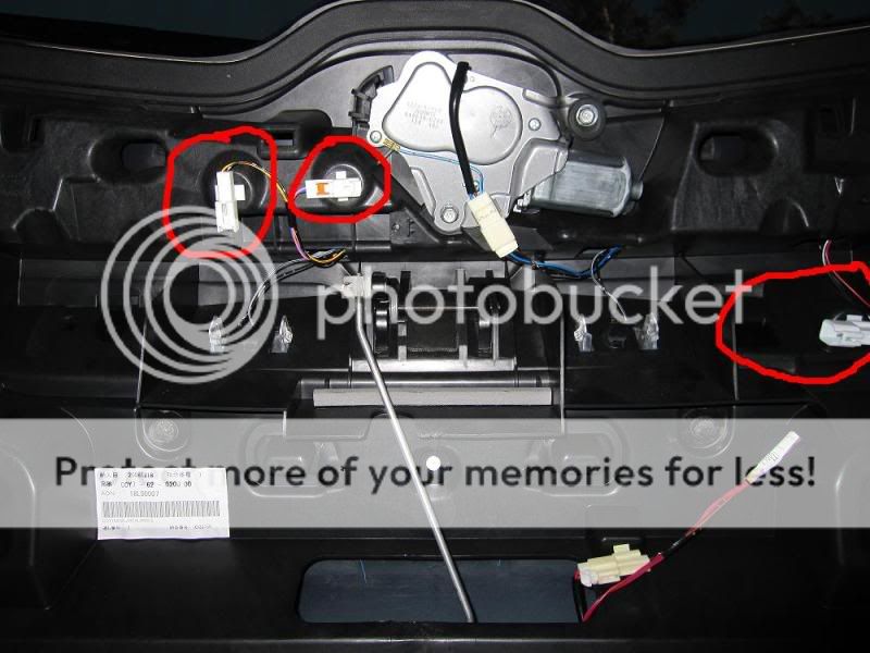

It turns out that when we lock the car either key fob or any other way, the hatch DOESNT LOCK!
Anyone know how or WTF is going on here?
If the hatch is not completely closed, it will not lock, but likely, neither will any other doors.
This may seem kinda basic but I know I've had similar problems when I've had a small piece of fabric or shopping bag in the latch for the hatch. It allowed the door to close but not lock.
Thanks for the heads up. It has not happen to our mazda5. But I think it is a flaw. And a security issue. Mazda should have included a 'manual locking' mechanism to the hatch for emergency situations. Just like the manual lock lever on each of the doors.
OK, I fixed it.
I pulled off the back panel to access the locking mechanism and thank go dit was something simple.
The harness was unplugged. So I have come to the concllusion that sometimr in our 5s life the rear has been taken apart. I just wish I knew why.
I also noticed this...
3 unplugged clips. I assume the one on the right is for the reverse camera?
As for the 2 on the left, Im hoping someone can answer that for me.
can you check the labels on the connectors?
Here's what I found so far from the wiring diagram:
connector 0920-310 is for backup camera
connector 0914-509 request switch(liftgate) (keyless entry)
connector 0914-506 keyless antenna (liftgate)
connector 0914-105 liftgate lock actuator
connector 0918-902 liftgate latch switch.

Fixed the HIDs so they sat correctly in the housing and know they are BRIGHT and even!

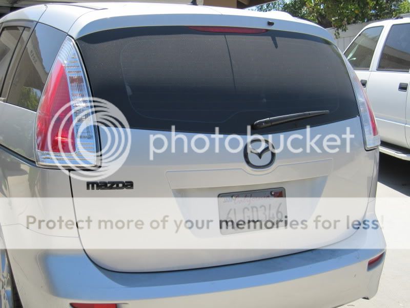

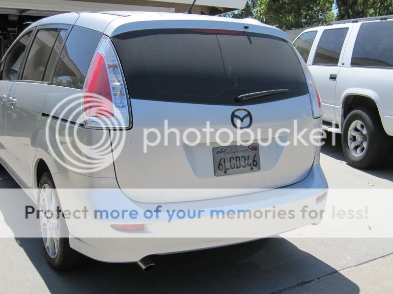

I removed the rear "MAZDA5" and flying M emblems. Blacked out the M and Not too sure what I wanna do with the "MAZDA5" yet so I have it off for now. There is 2 small alignment dimples for it so maybe I will see how much it cost to get those filled in. I like the clean No emblem look.

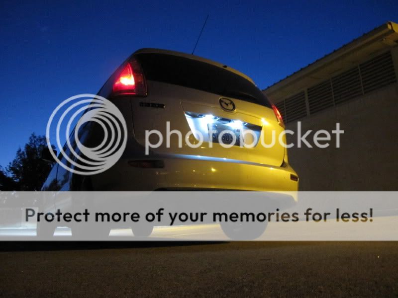

Since my Nissan is out of comission right now and it shares alot of the same bulbs as the 5 I swapped the LED bulbs over.
So now the Map lights and license plate lights are Cool white LEDs(2thumbs)

HIDs Fixed and operating perfectly!
Bright White LED plate lights

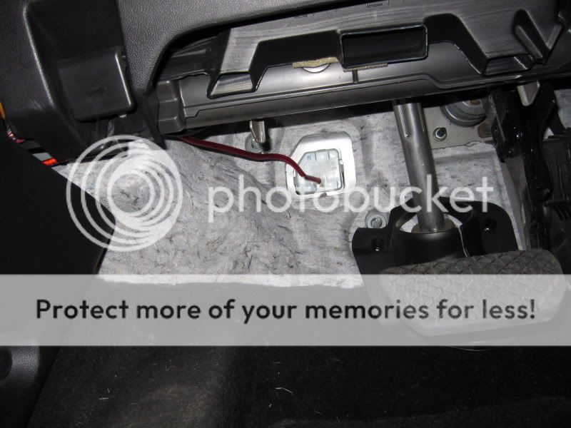

Amplifier coming soon, So Im taking care of the wiring now. Power wire thru the firewall ( Im guessing this is where the clutch pedal would be)

Blacked out trunk emblems
And stoopid alignment holes

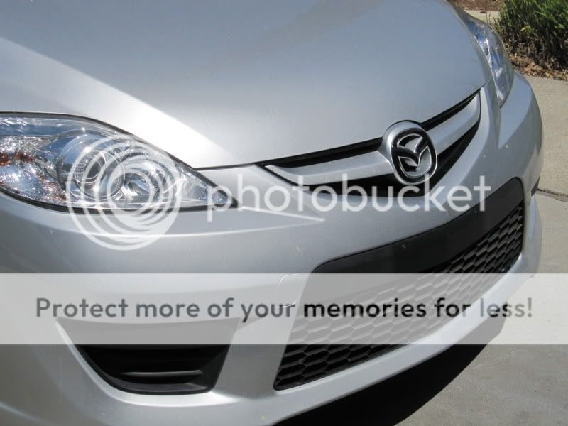

While I was at it I messed around with the grill and blacked out the emblem.
I think I actually like the black grill, This might be another coming soon project.
Anyway, I painted the emblem for now
