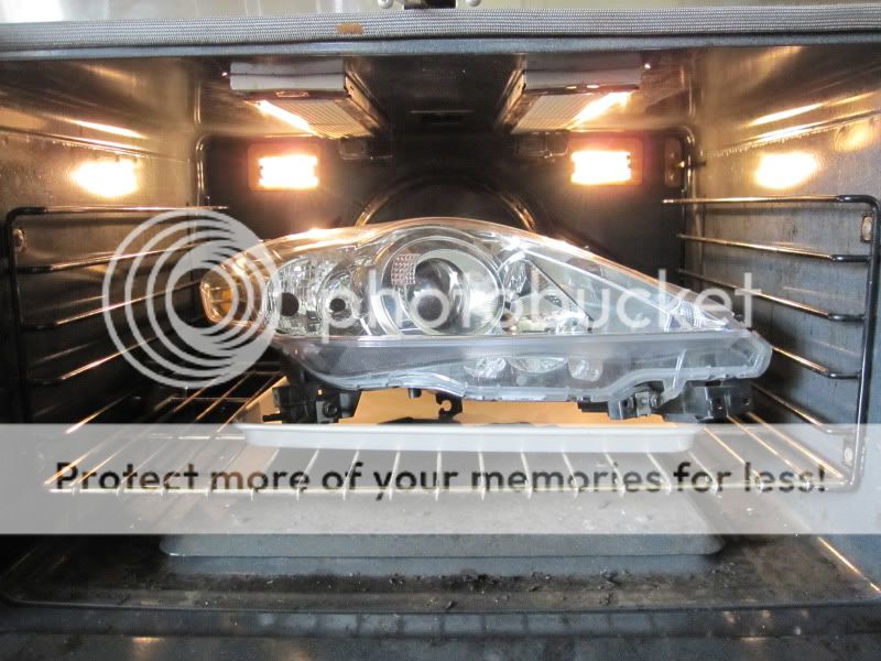

I just hope that oven only gets used for projects only, yuck! lol

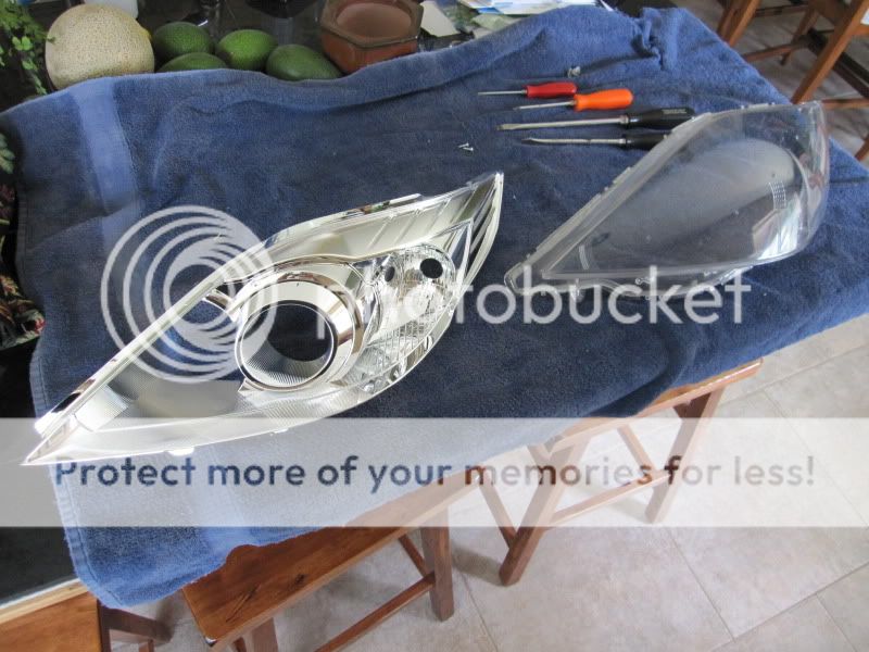

Yeah i was thinkin about that when i was doing it. But after i was done it was nothing to worry about. Only set to 200 degrees and for about 20 min and the light really doesnt get THAT hot. Just warm enough to loosen up the silicone. I was waiting to get some foul odor as well but nothing happened there either.
more tease....
Nice. Is there enough sealant left to where you can reheat both halves and stick it back together, or will it require additional sealant of some sort?

Yumm, melons and mangoes. Now that I see it, wife would be extremely happy to see an opened headlight in the kitchen, you are a brave man, LOL
Pretty sure those are avocadoes, not mangoes :p

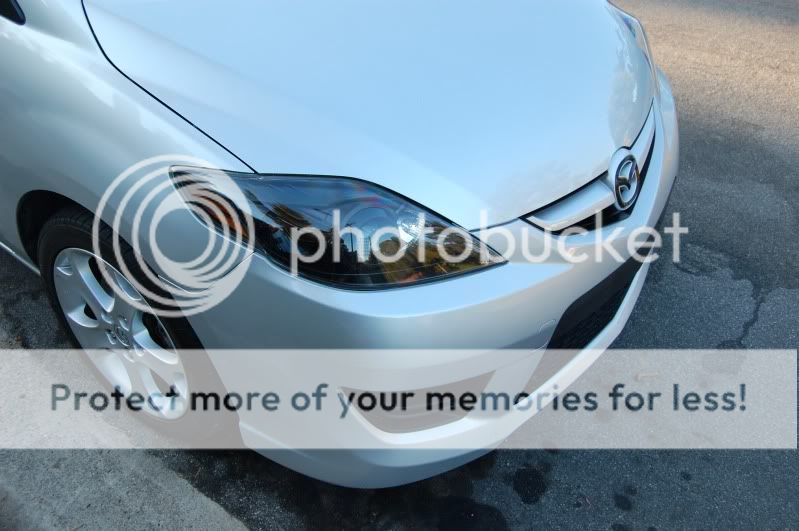

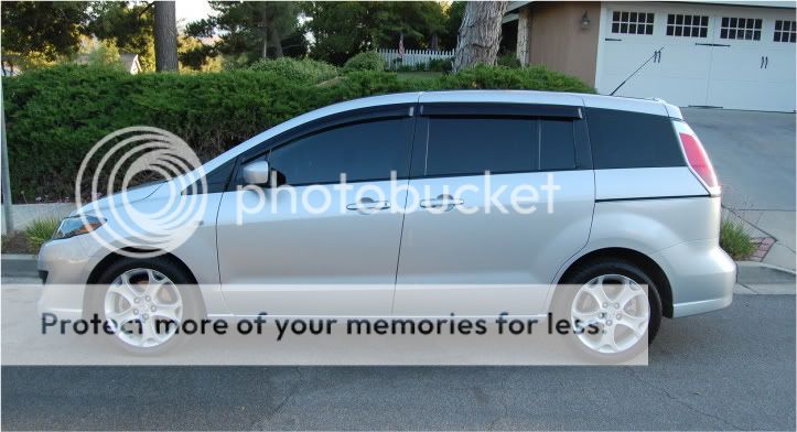

Looks like im gonna have to put the roof job on hold for a few weeks but the lights are done. I also installed some window visors.

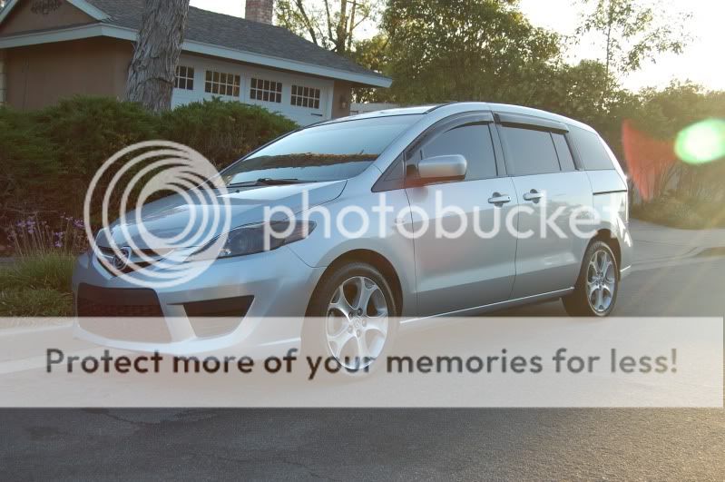

I had the side skirts installed. I used double sided tape instead of drilling holes for the push-in pins. It held for about 2 days then started coming unstuck so I pulled them back off until I can get the holes drilled.
And how come the more I look at this car, it seems as if the ride height is increasing!?!?!
