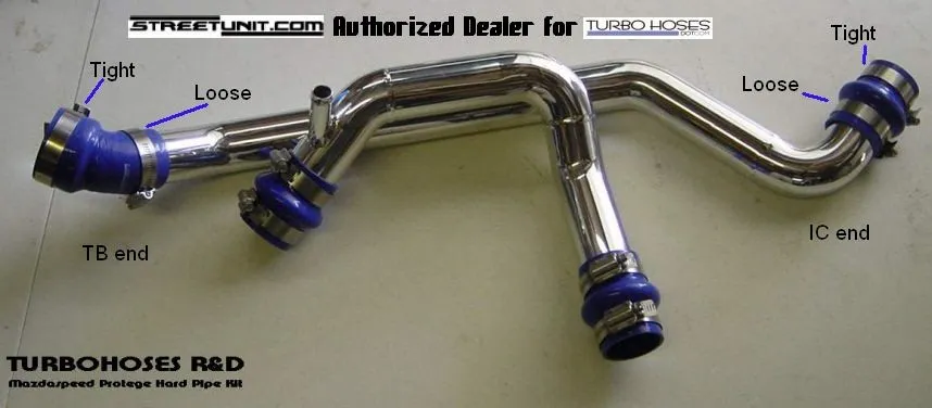

Thanks wiked and Cullen for your help. I talked to Cullen yesterday on the phone and it appears that i was trying to adjust them incorrectly. I figured they needed to seat more snug onto the IC and intake openings, but the real problem is on the pipe side of the couplers. Here is Cullen's instructions:
1. Loosen the hose clamps ont he pipe side of the IC and the intake (not the side attached to the IC or intake, but the other side of the coupler)
2. You might have to heat up the silicon hose couplers to get them malable enough to work with, but twist them back and forth until you get them to seat farther into the coupler. I got almost another inch of clearance out of mine. It takes some persuasion to get them in there, but they will go in more. I have about 2 inches now between the upper pipe and the master cylinder. I doubt it will hit now.
3. Get the AWR front motor mounts, Cullen says they are a must (and i trust him fully on the subject)
Hope you are in the clear now Chad... LMK

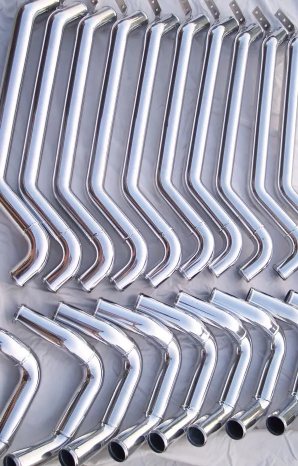

Please do not put rubber in between the cylinder and the pipe. This will close the gap between the cylinder and pipe making it hit more often if the pipes are on incorrectly. There is a pic attached which explains what CEldrige was stating to fix the issue. Adjust the pipes so there is plenty of room between the pipe and the cylinder.
As you can see in the second picture, all the pipes are the same; no one should have clearance problems.
Regarding the AWR motor mounts... It should be the first modifcation done before ANY other aftermarket parts, it is a must for the MSP. Even for a stock MSP with no modifications.
