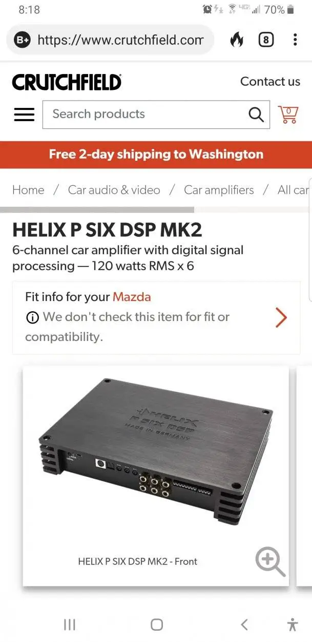

Had this amp/dsp reccomend to me by a local shop this week. Spendy at $1,500.00, but they felt that replacing the speakers in our 2020 GTR might not be necessary.

It's a amp/ dsp combined. They said because of the stock amps integration with the car, it might be better to add the Helix unit to the existing system to keep functionality. They said the increased power might bring the bose speakers alive. Maybe not. Thank you for the sound deadening advice. Appreciate the specifics.
The Bose speakers have some kind of ultra low impedance, like 1.5 or 1 ohms. Make sure that amplifier can handle impedance like that and survive. The great majority cannot.
