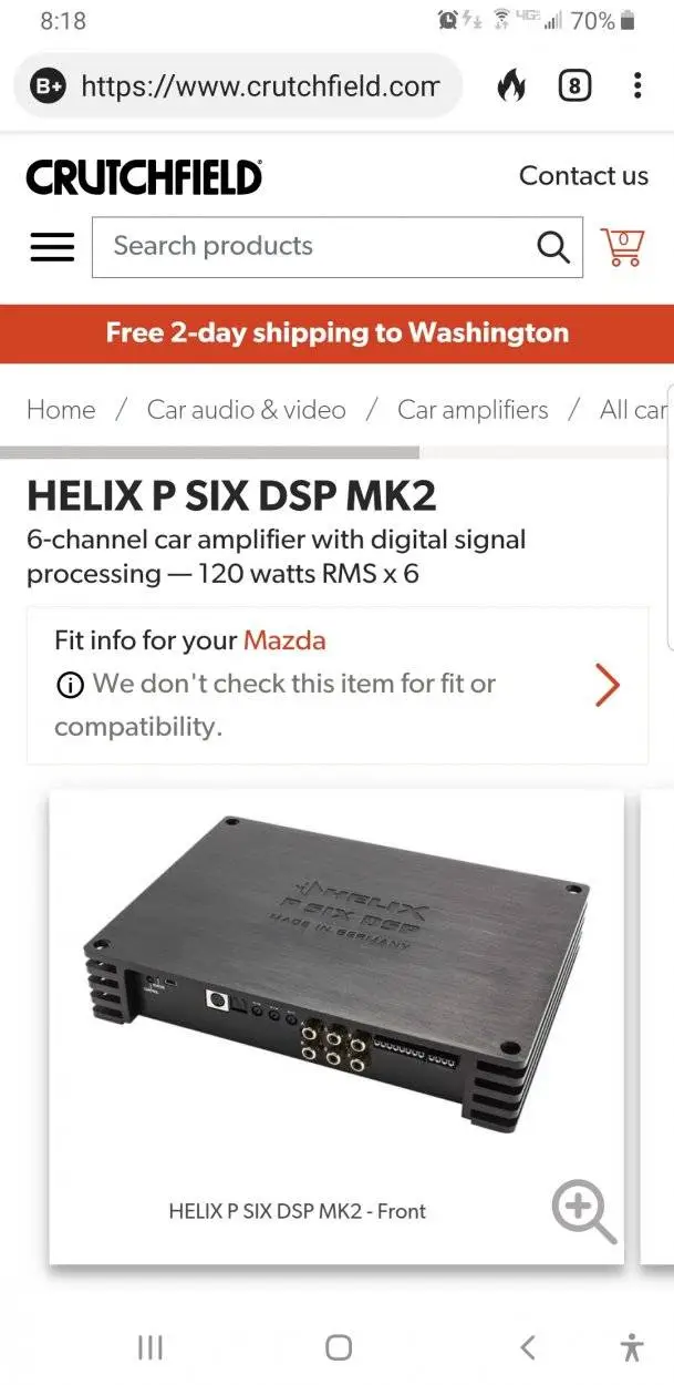

Musica Northwest has an article explaining that adding an amp/dsp does bring out the Bose systems. Link below;Had this amp/dsp reccomend to me by a local shop this week. Spendy at $1,500.00, but they felt that replacing the speakers in our 2020 GTR might not be necessary.

@theblooms , I completely understand overhauling the stock Bose system rather than spending $1500 on an amp. As a matter of fact, it's beyond the budget of what I would give myself to improve the system. However, I'm highly considering going the Musicar route that I linked above, as the amp/dsp costs about 700-900 on ebay depending. The thing about the Bose system is that they process the sound through their amplifier; this is to include things like time alignment (which I find extremely important, maybe even more than dampening itself). Adding an amplifier/dsp AFTER the factory amp will still retain that time alignment while adding a little more power and the ability to EQ the channels separately (this is another thing that I would like accomplished). Is it worth 700-800 dollars to gain this ability? For me, yes. But it's not worth $1500.
