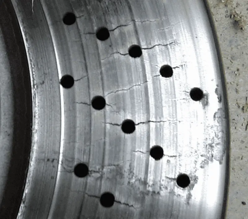

Drilled rotors are horrible. Not even actual race cars use them. Avoid.
They get worse than this. I've seen them where they disintegrated and fell apart into pieces on the car/truck. The mechanic was pulling them off the truck in fragments. The wheel and studs kept the large pieces from flying off the truck. But they destroyed the pads and looked like might have bent the caliper pins. Was on my way out so didn't stay to see all the damage.

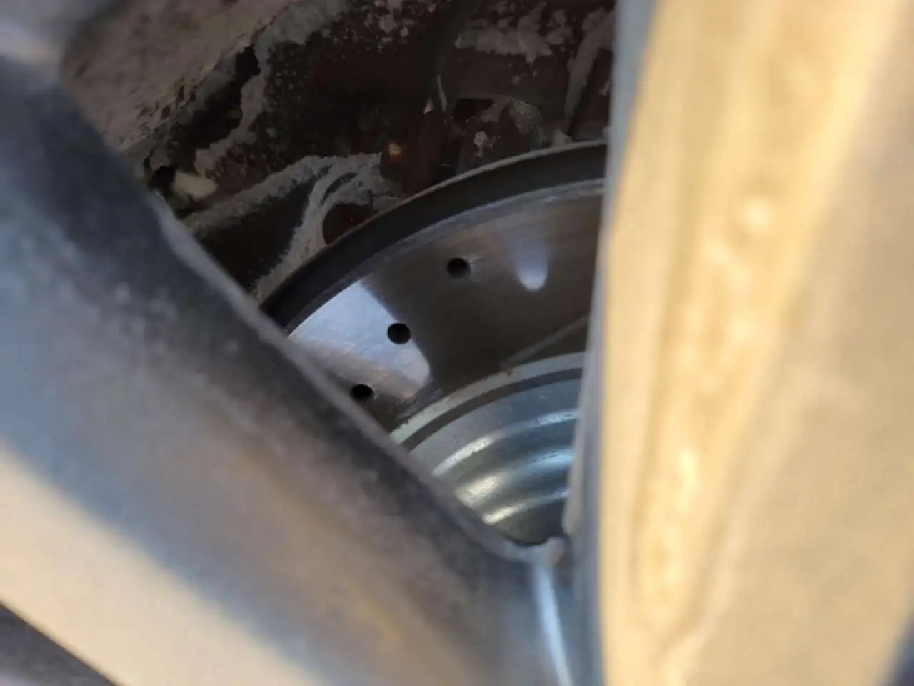

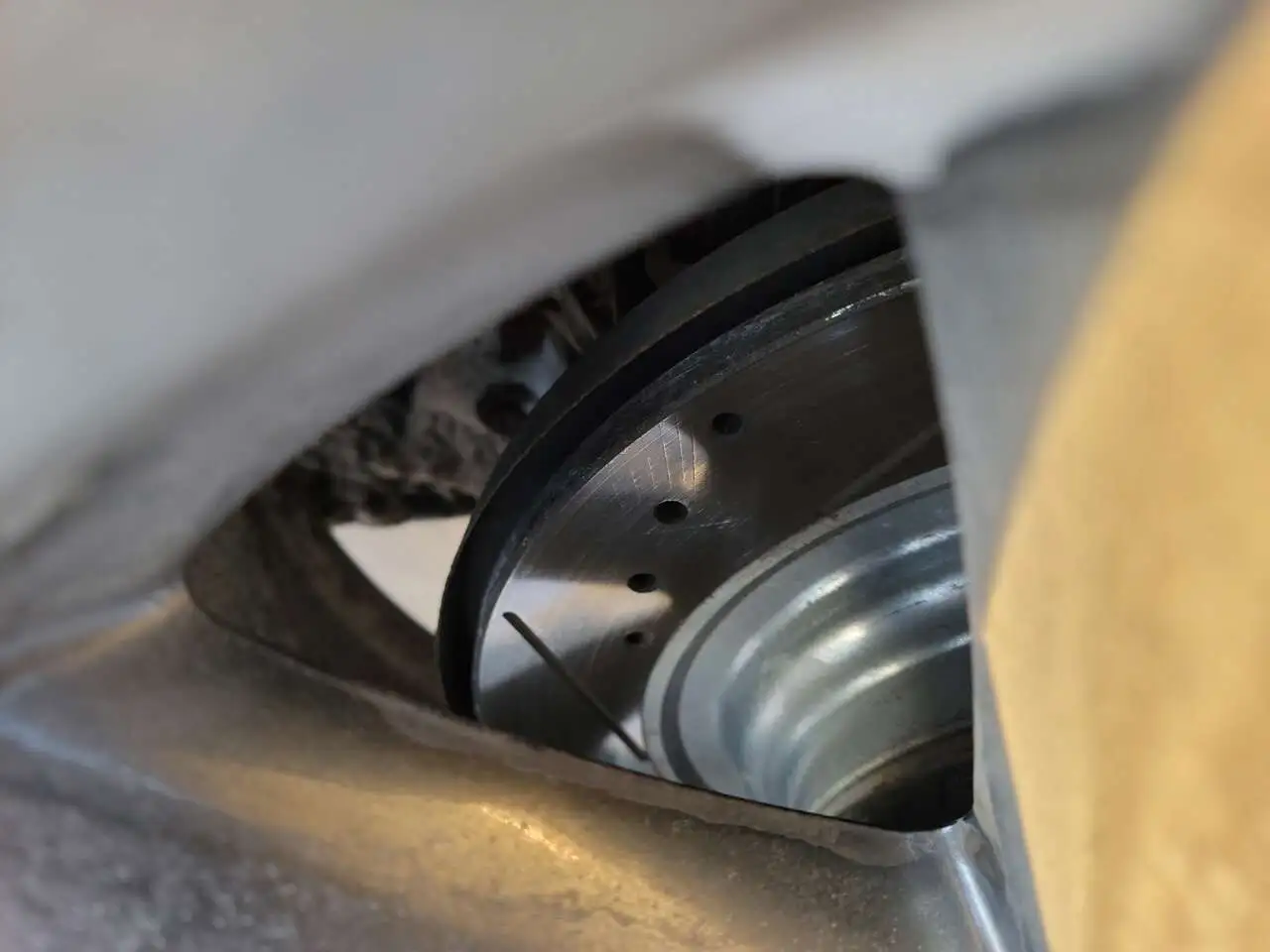

I have the same kit (Z23 Evolution Sport rotors and pads) on the rear brakes of my CX-9. It's driven daily, with a good mix of city and highway speeds during my commute. I've had them installed for only 3 months so far, but I've had no issues with them. I didn't even need to replace my rotors, I just like the look. I kept the OEM rotors as backups just in case.
Pics of my actual rotors, 3 months in with a lot of salt on the roads already:

No nasty rust on the rotors .
