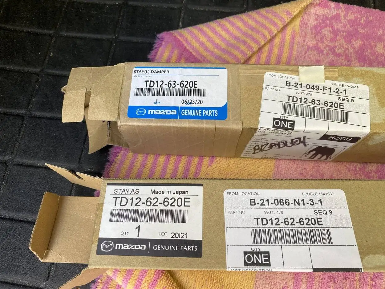

Went outside yesterday and "assisted" the tailgate, and it opened and closed. Went inside and ordered up two new gas struts (dealer only apparently), so will have those in a few days. Had to go out today, -3* outside, and I used the tailgate four times with no issues. Of course. LOL Guessing the colder weather makes for happier struts (colder/thicker fluid). Will let warm up before I swap them out, just to see if the problem comes back.

Usually cold weather is worst for bad strut (cold = less internal gas pressure). It is good to use dealer struts, i had ordered aftermarket struts for my Ford edge, but they where just a tad too strong and the whole car would shake when the tailgate would hit its hard stop at full open position. I ended up buying Ford struts that where just the right strength.

Parts are coming from Mazda. Being in a chair and not at work (buyer for a large auto parts company), I don't have the resources to do anything else right now. ☹️

The problem has not poked its head up, and I was hoping it would so I could confirm the struts were the issue. 3 months later and I'm tired of staring at the new struts sitting in my kitchen, so I installed them yesterday. Took all of 5 minutes.....
