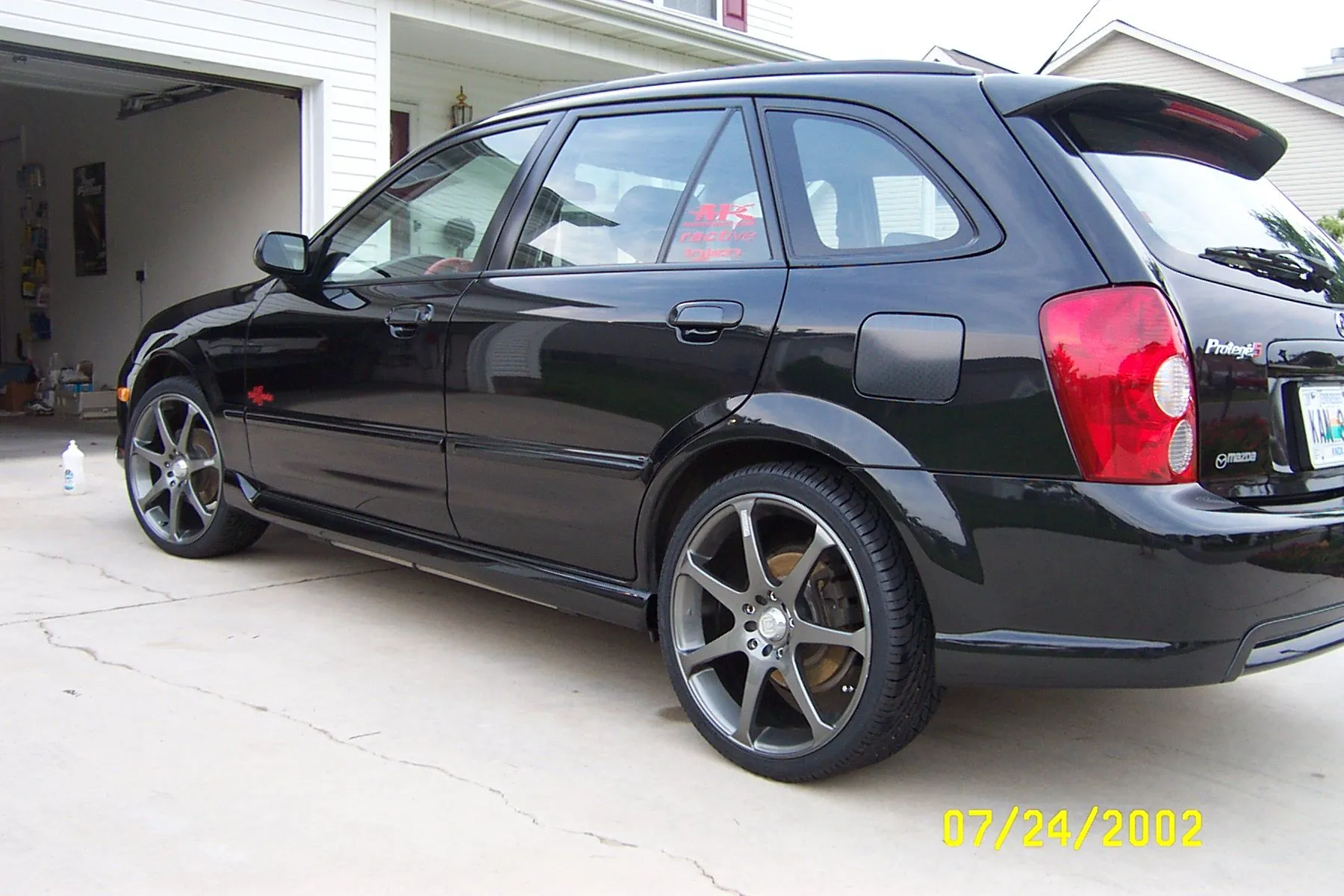

well as far as the pict . i know they are small but the maximum limit is only 512000 and the big ones i have are 648000so they wont fit .. I have some big pict on here of my car ... and you need 3 screens to look at it they are so big ... look at this one
montegi mr7s......sweeeet.........are those 18's?? i was looking to get something like that, but wasn't sure whether it would rub cause the offset was just so......do you get any rubbing??
wheels
nope...no rubbing at all and yes they are the 18inch Motegi MR7s ... the wheel offsett is 45mm and i can get you the best deal on them . I can get tehm for just about $500 shipped . there is only one tire that can be used ... its the 215/35/18... i go the NItto NT 450 extremes

Re: wheels
$500 for the pair, without tires?
Are you serious... all 4 rims w/ tires- How can you hook me up?
