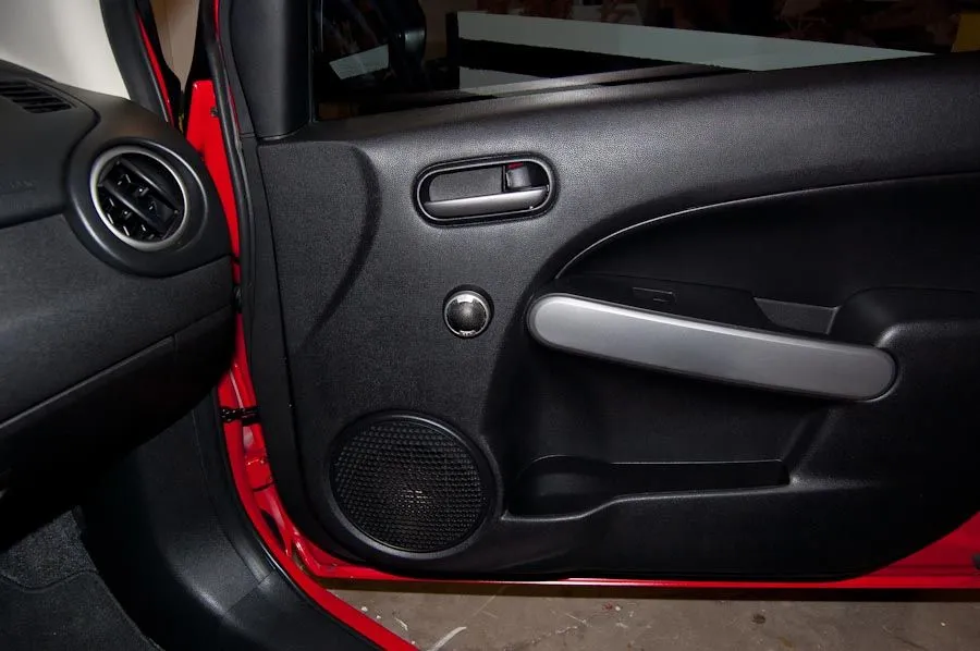

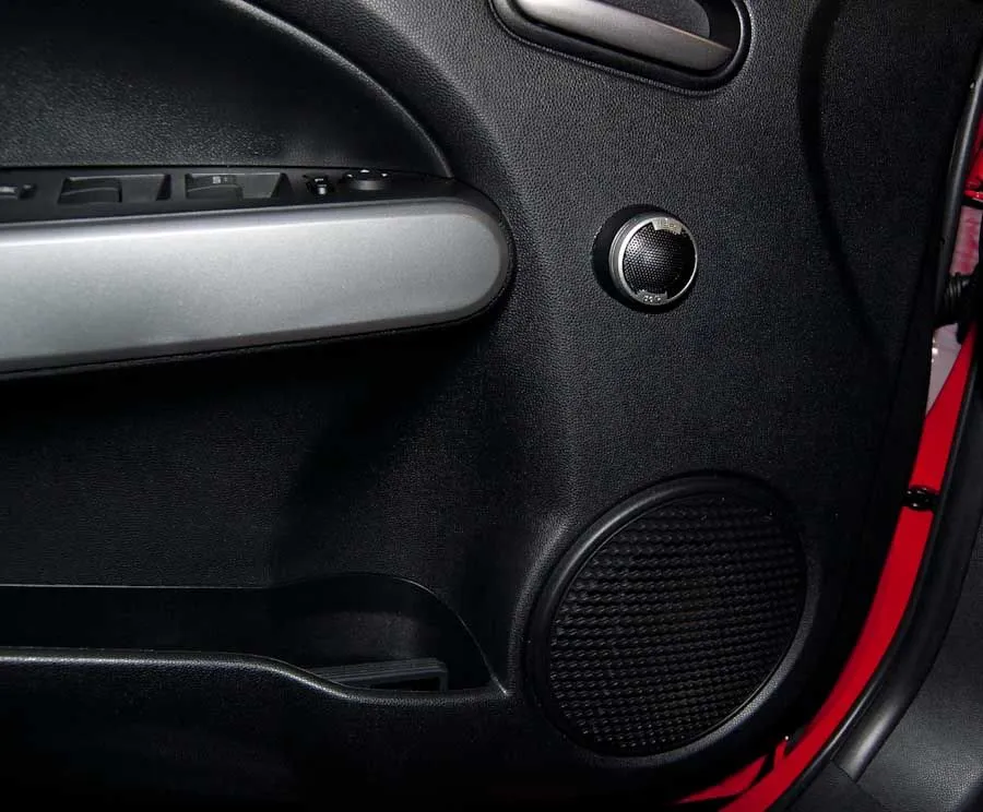

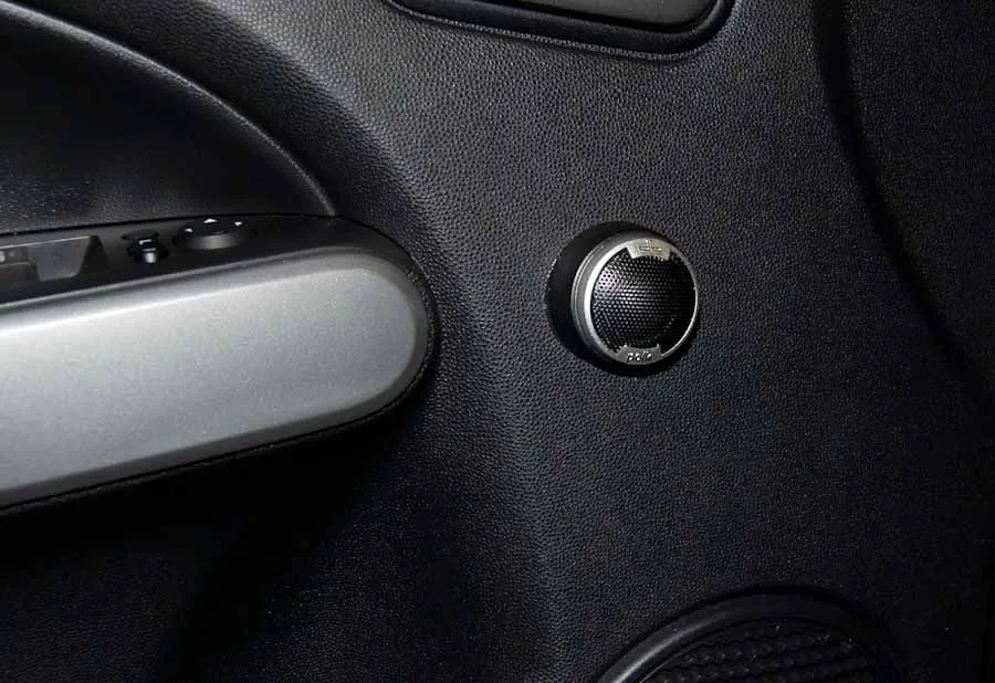

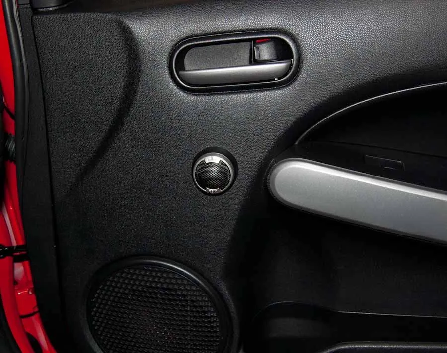

For those interested, I have installed the Polk DB6501 in the front and the DB651S in the rear. The DB6501 comes with a plastic adapter for the woofer that makes that install quite easy. You just need to re-drill one hole in the plastic adapter and then use the original screws to install it. The speakers then install onto the adapter with the provided 4 screws. The big question was where to place the tweeters; flush or surface mount. The speakers comes with both mounts. Since I did not have Touring model and the diameter of the either tweeter mount was too big for the blank tweeter panels in the door, I opted to surface mount on the door in between the end of the large door handle and the dash (I'll try to get some photos later). Flush mount would have required a 2" hole in the door panel and after looking at what was behind it (the motor for the window) I did not think I would have enough room (depth) to mount it. Requires about an inch of depth. So on the safe side, but not my first choice, I surface mounted it. Looks fairly nice and not in the way, although it does protrude.

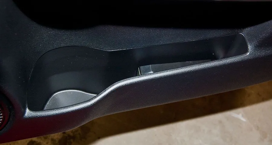

The crossover was placed in the bottom of the door panel in that skinny space where you would put maps. I wanted access to it in case I need adjustments to the tweeters and did not want to take apart the door. I adhered it with plastic mountable Velcro tape bought at HD. The speakers come with all the necessary wiring.

Note the tweeter is not centered on the door panel because the dashboard protrudes further out on the driver's side than on the passenger side. In order to keep them at the same opposite position, I centered it using the driver's door and kept it in a position that avoided contact with opening/closing the door. So far my experience indicates a good placement and a closer balance with the woofers.
Thanks for the detailed review. I'm looking for speaker install ideas myself as I'm dead set on using the stock tweeter panels from my touring edition to mount aftermarket tweeters. All I know is I told my friend who installs car stereo equipment at Best Buy that it looked too small for tweeters and he said it's not impossible so that gave me the shred of hope I need, lol.
The tweeter itself could fit in the panel, probably hot glued in without the Polk mounts. It is the Polk tweeter mount that is too big in diameter, especially the flush mount as it is about 2 1/4 in diameter and therefore the lip of it would stick out a bit. Even the surface mount is still too big. Mounting just the tweeter behind the panel could probably work. I just did not want to spend the additional money on blank Touring panels - less the Mazda tweeters (if available - only seen it with the tweeters already mounted for $80/pair). Overall I am very happy with the results, much crisper and cleaner in sound quality, nice bass for my taste, adjustable tweeters and all for a low price. Note the crossover is fairly large, a little bigger than a pack of playing cards.

I'm probably going to be swapping out my front speakers for a set of Infinity Reference components. I have a set of them in my 3 as well, and it sounds like the crossovers are about as big as the ones for the Polks. Any idea if there's room anywhere behind the door cards to mount the crossover? I don't want to give up space in the map pocket, and I'm not willing to drill holes to run wires either.
Behind the door there are some large pieces of hard foam I guess to deaden the sound and to act as fill. If you look at the fourth picture I have of the passenger front door, towards the bottom right corner where the map pocket and door handle ends you might be able to mount the crossover in there. There is the chunk of foam behind it, but I think there is space.
I used the map pockets as I rarely use it for anything else, wanted quick access to it, and the wires holes cannot been seen. The only down side is if you remove the door panel later on you must to remember that the wires are attached to.
