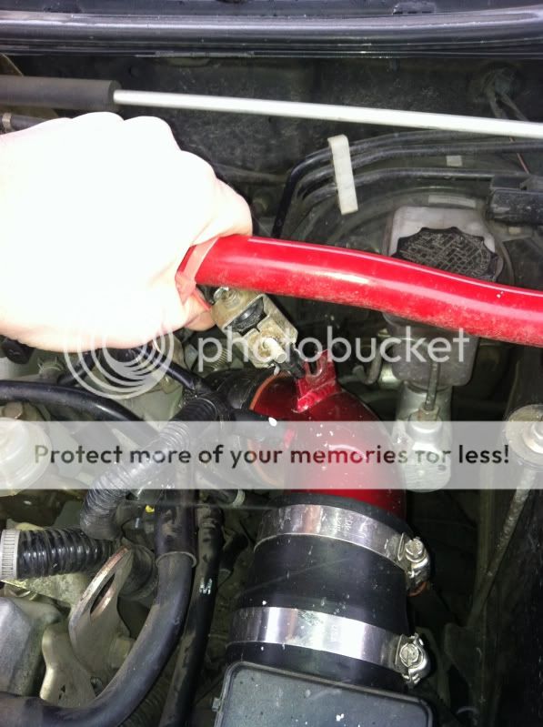

Secondly, I installed an ebay intake and mixed and matched a couple parts from a CAI I bought from Lewis on here. I have not reconnected or reattached the solenoid (I think it's a solenoid) that sits on top of the intake and under the strut bar and this thing starts making a loud clicking sound once my car has warmed up and I'm either idling or at light throttle. It drives me F'N CRAZY. I am 90% sure it's this solenoid that's making the clicking sound. Here is a pic of what I'm talking about...
I know this thing has a couple vacuum hoses, one leading to the Intake Manifold but I'm not sure whether the other end runs to. When I was installing the intake, I know the vacuum hose disconnected from the IM because I was getting a rough idle and such. What's weird is that when I reconnect it, the car runs COMPLETELY FINE, but makes that damn clicking sound! Should I reattach this to something that will ground it or what?

First off I wouldn't seafoam your engine, there's debate as to whether it actually does anything. I wouldn't let it sit overnight either. As for the intake try to ground it, see if it does anything. If the car won't run right without it then you should keep it on, driving around with rough idle or misfires could damage your engine; at least that's what I've heard.
the clicking is definitely the solenoid. I just got a piece of metal and made a bracket for it, connecting it to one of the throttle body screws. This solved the clicking issue.

I'll try to get that solenoid connected somewhere and update.
I believe that forklike section sticking up from your CAI is what you are supposed to use to mount the solenoid.
