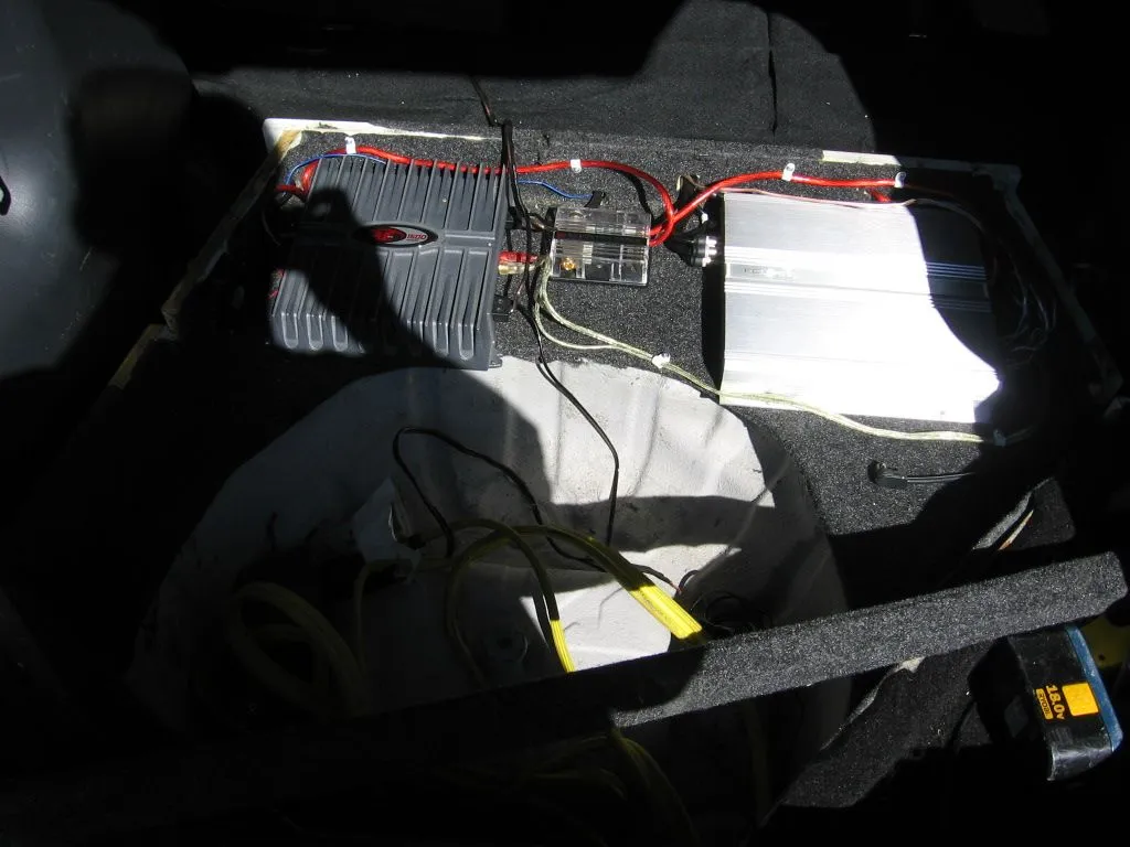

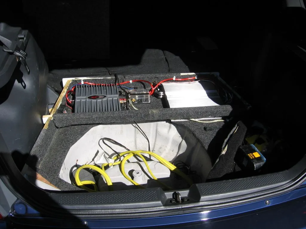

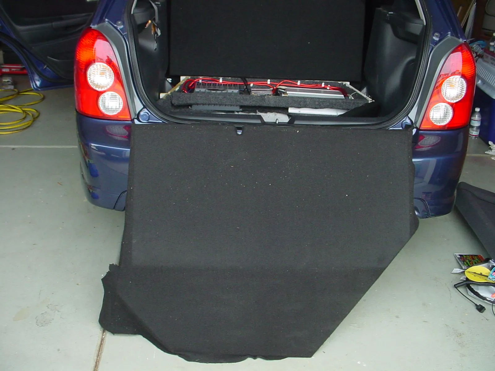

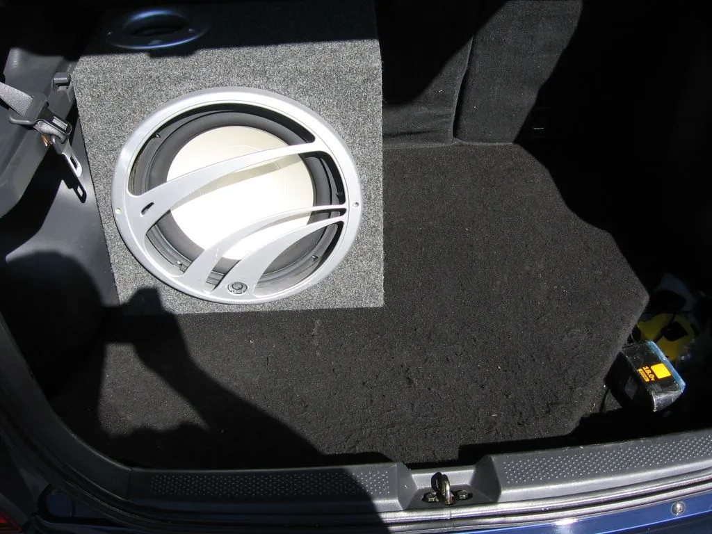

I have the hatch so much easier to work in. I did kinda a ghetto setup. It could be so much better. I made a frame of wood around the perimeter of the trunk. i then made a steel crossmember to hold up the floor. Then i made a floor outta 1/2 inch ply. Works very well. Totally quiet and easily removable when i sell the car. Hides my amps and fuses and noone would think to look under it if they broke in. And still fairly light. Plus it carries all my heavy tools.
