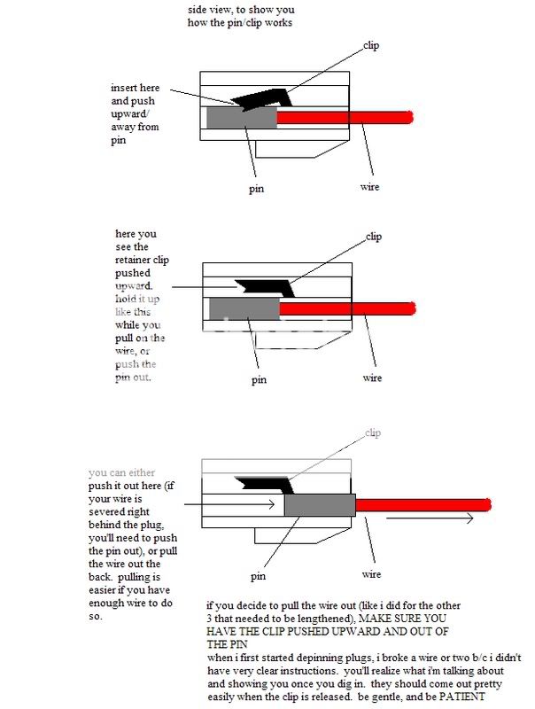

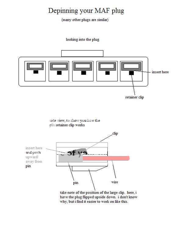

There is a way you can depin the connector and resplice the wire. Let me see if I can find a picture for you.
Edit.
pictures from Busted EJ1 from M3F
You would need to find a really small flat head screwdriver. Almost like about the size you would need to fix the arms on sunglasses.
