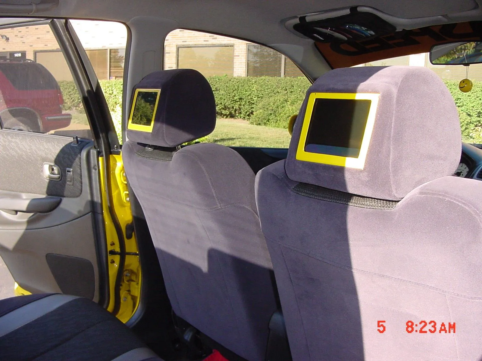

i am running the 828 in my mp3 along with a ps2 and 2 headrest tvs..i have the audio coming out of my ps2 going into the inputs on the 828..and the video going to the tv...works great..plus my kid likes to watch tv in the back seat all the time
here are the tv's..and also you can use any headunit with an fm modulator..all a modulator does is plug into the antenna which all radios have...

That looks great - So was it pretty easy? I love the color coded framing on the monitors.........so you said that you had no problem running the sound from the ps2 into you z828 deck? great. I sent you a pm asking some other questions....

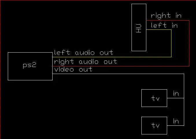

Its VERY easy to hook up sound to the headunit..all you have to do is take out your glove box which takes like 3 seconds and you can reach your hand behind the headunit and grab a pair of RCA's thaat say "aux Input"...all of the RCA's are labeled..BE CAREFUL not to pull to hard..you will pull the RCA's right out of the back of the headunit..(which I did and made Mazda replace it...shhhhh) plug in the aidui..and change the source to tv/dvd/game..whatever icon you have selected (look in manual for the radio to see how to change the icon) and you are in..nothing better that playing Gran Tourismo with the subs pounding!:)
so you need to take rca's out of the HU and replug them in to where? Sorry, I'm a bit cofused.......
in the back of the headunit, there are several sets of rca's they are all labeled front out, back out, etc. look for the pair that says "aux input" they should be a red and white rca with black rubber caps on them to protect the rca...take off the caps and then once the playstation is in the car take the audio rca's from the playstation (red and white are audio left and right, yellow is the video) and plug them into the rca's on the back of the head-unit.
ok, and then the video will come from the monitor to the HU and the rest should just be power up - plug and play?
no... video doesnt go through the hu... video just plugs in from your PS2/DVD/VHS(lol)/XBOX/Whatever you hook up into the screens input... video never touches the head unit.. head unit is just for the audio.. its like if you had a TV and one of those little two speaker 3 cd changer am fm two tape deck aiwa steros.. you would plug your ps2 video into the yellow on the tv and the audio into the red and white in the stereo... same concept

well said protege01mp3..video never touches the HU..here is a simple schematic of the wiring
