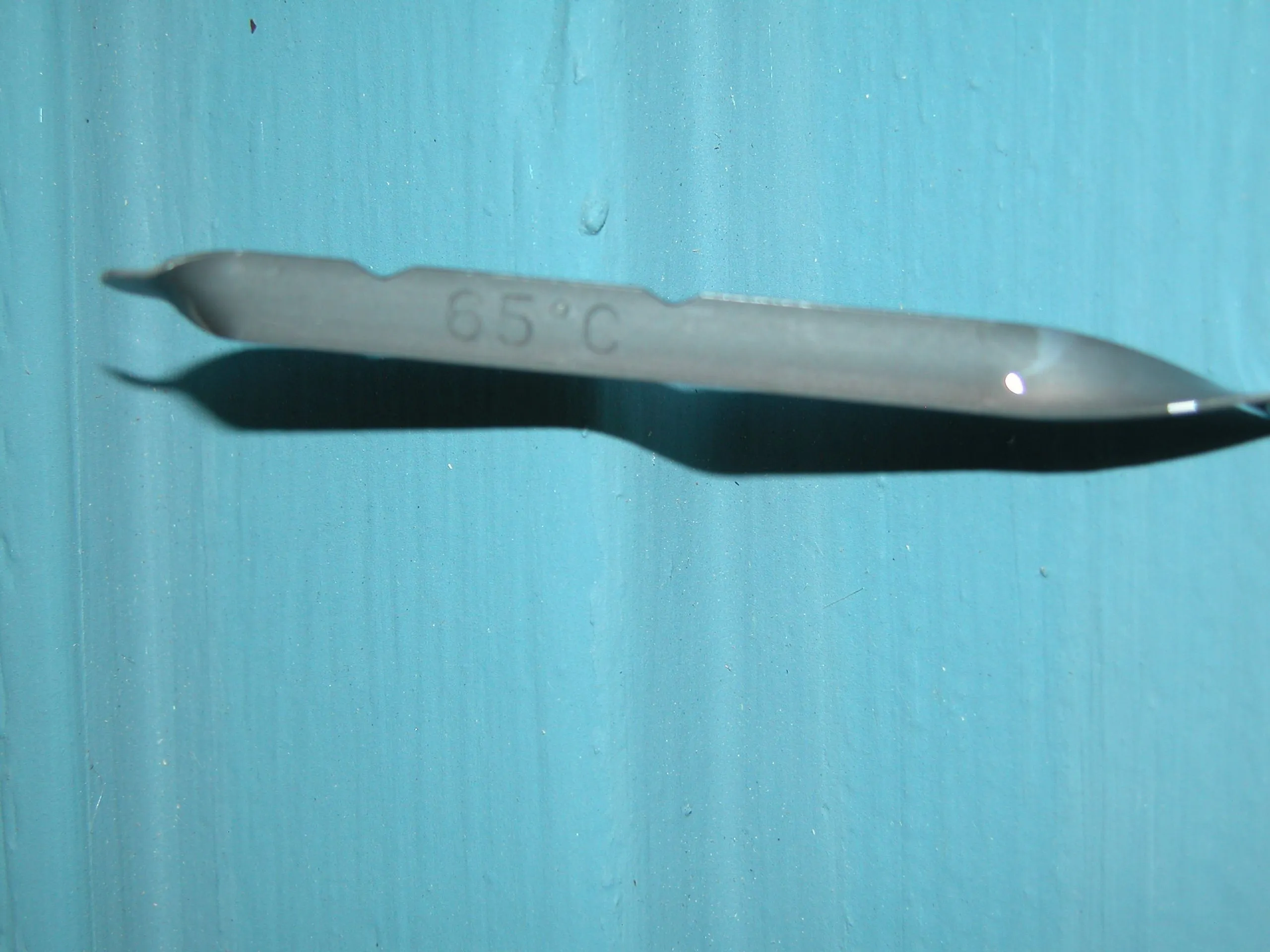

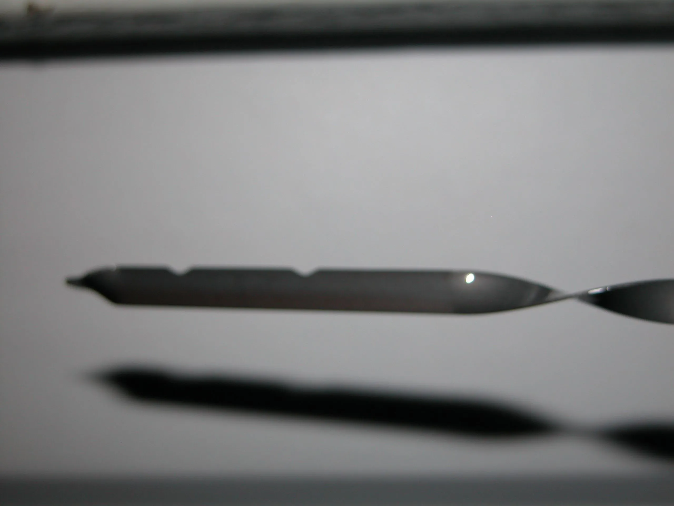

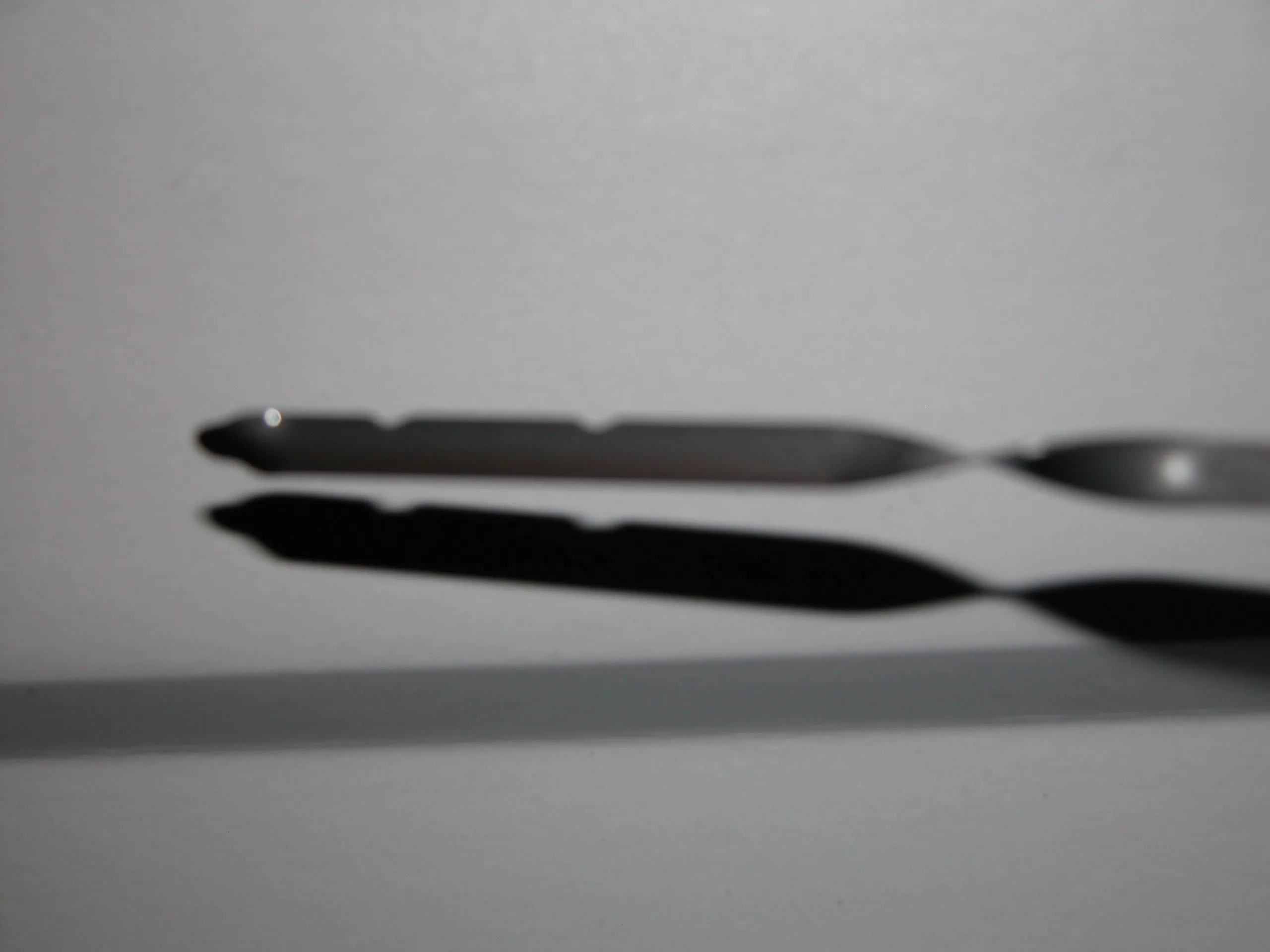

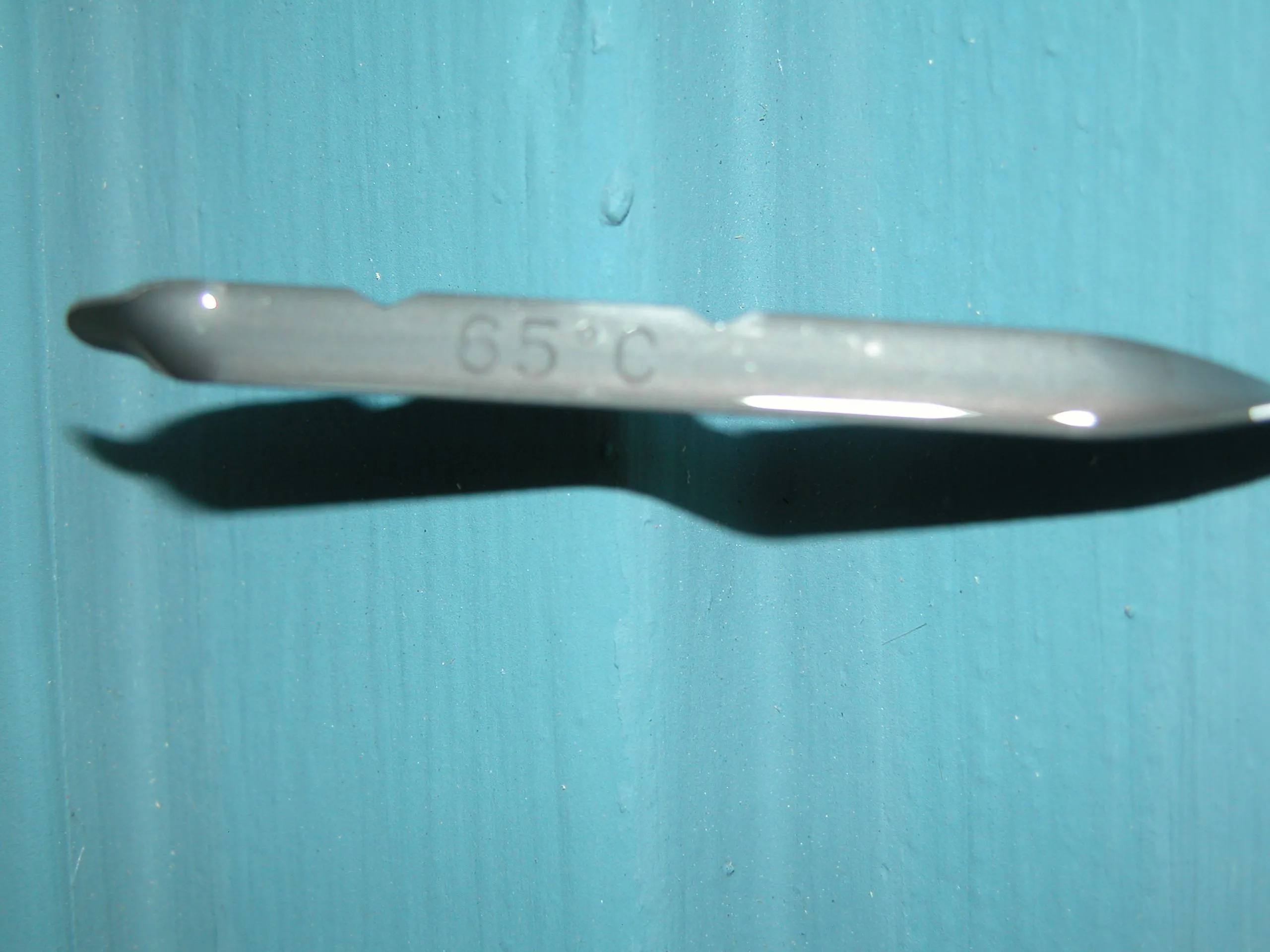

Oh, ok. I'll throw up a pic or two in a bit. Basically mine is waaaaaaaaaaay above the full line.
Edit: all the pics I took. they're pretty terrible and I tried to get good ones but the camera was pissed at me. In the first 2 you can more or less see the 90 degree twist at the beginning, the fill lines, then the 360 bend. The second 2 you can see that it's filled to just the bottom of the 360 by the liquid reflection. The last one has mainly residue it picked up from the dipstick tube on its way out on the 360 bend.

The twist on you'r automatic tranny dip stick is just to add stregenth to the dip stick. The 2 notches below the twist are the low fluid and high fluid mark. The 65c refers to the Tempature of the tranny fluid. Drive you'r car for a mile or so before checking the fluid. Leave the car in park and running when you check the fluid. The fluid should come in between the 2 notches. It appears that you'r tranny is now way over full and needs to have the excess fluid drained out. If it's way over full as I expect it is you could have major damage to it. First drain off any excess fluid if it is indead over full and then drive it. If it shifts as it should you might have dodged a real problem. If it is over full donot wait to drain it. Do it.
Great, so now you know your tranny fluid is overfilled and the symptoms associated with that are consistent with what you're experiencing.
Go to the dealer and ask them to look at the tranny fluid. Tell them to make sure your tranny is undamaged. Make them document everything b/c if your tranny takes a crap later on in the car's life, you know the reason why.
