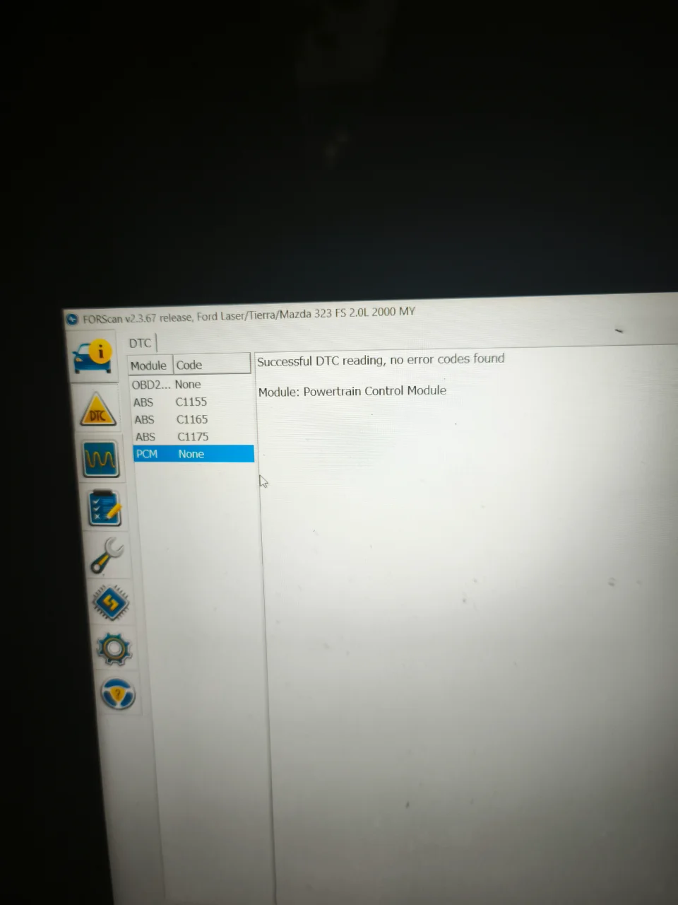

I'm about to abandon all hope. Obd scanner can communicate with the PCM and read live data but it says there are no DTCs except for the ABS at both rear wheels. I tried removing the immobilizer to see if the PCM with throw a DTC and it did.

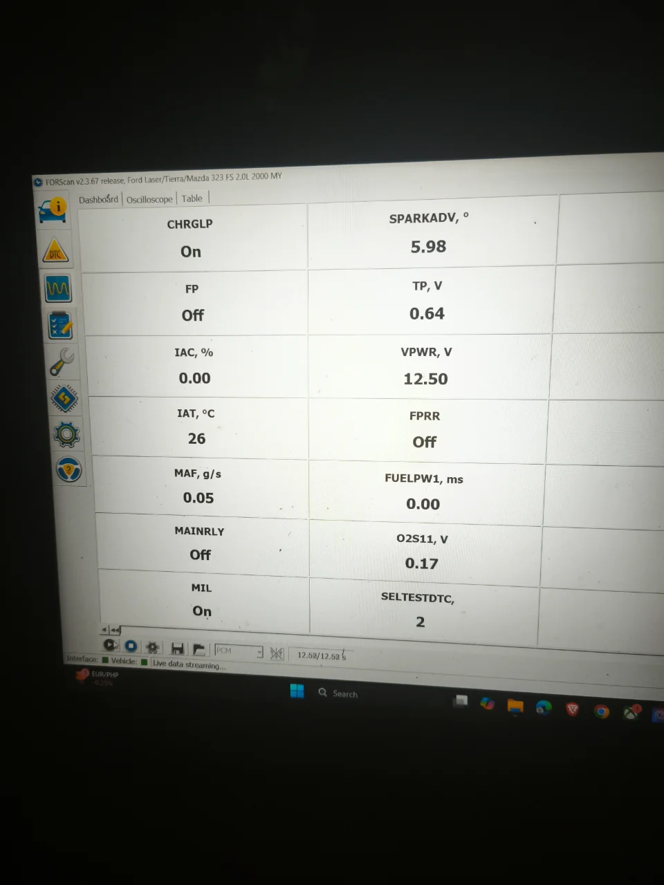

One thing I noticed however, is that PCM main relay was off when I was checking all the live data. This might be the reason why PCM has shut down the engine. Upon cranking the car, IACV is at 100%. I'm not so sure about the MAF reading if it is within specification.
