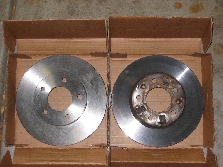

Use 99 and up 626 V-6 model rotors for the front. I can verify this because they have been on my car for 7000 mi now and they work great. plus they only cost me 30 dollars a rotor.
I just put the 99 V6 626 rotors on MSP, they look just barely big enough for the area of the brake pads.

See picture.
I just did the same thing ($ 43.98 for front pair, from NAPA). Part Number is: 86790. Made in USA. Takes about 5-10 minutes per side. Much better, no pulsating and I did it myself!! (I drive hard: stockers were warped and I am not even at 20K miles!). I hope this helps people out there. Do it yourself!!
21.99 at napa. if it doesnt end up working well then its not much money lost.

I remember reading somewhere, too that the 99 626 V6 rotors are directionally vented, too which might give a cooling advantage over the stock ones... not sure if it's true though.
I can't possibly believe Mazda would do that on a grocery-getter family car.
According to my books, the MSP has the same front rotor as the 98-02 626 V6, and the 92-95 929, and they are not directionally vented. You guys seem to share the rear rotor with the 03 Mazda 6.
I didnt think they were directionally vaned.
That's what I thought. I think I remember seeing that at the corksport website. I'd look it up but I'll be too tempted to buy something.
