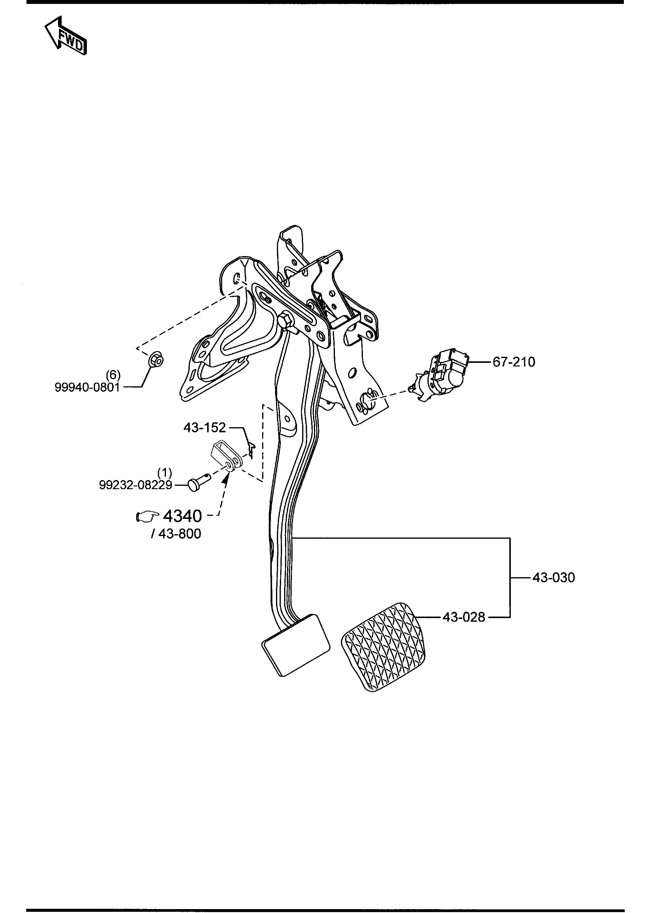

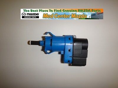

There's only one brake light switch but it has 3 prones on wiring connection.
SWITCH, STOP - LAMP
P/N: BN7N-66-490
