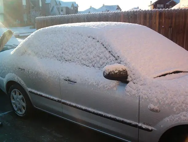

Here's what my car looks like now:

Nope, just stickers as far as I know. I wanted to do the same, but was affraid of ruining something since I have never really read about their removal.

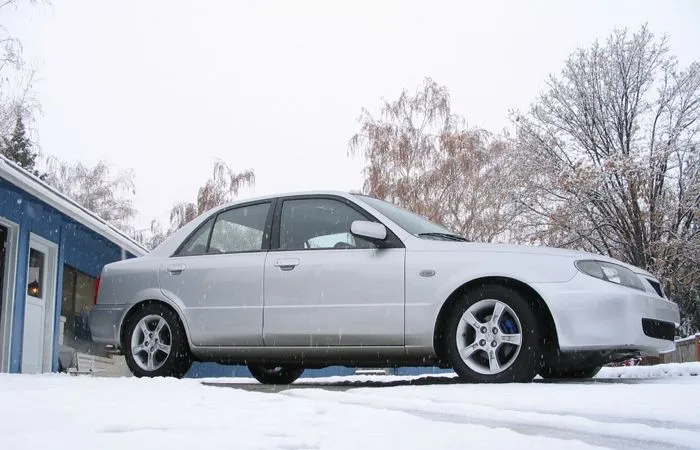

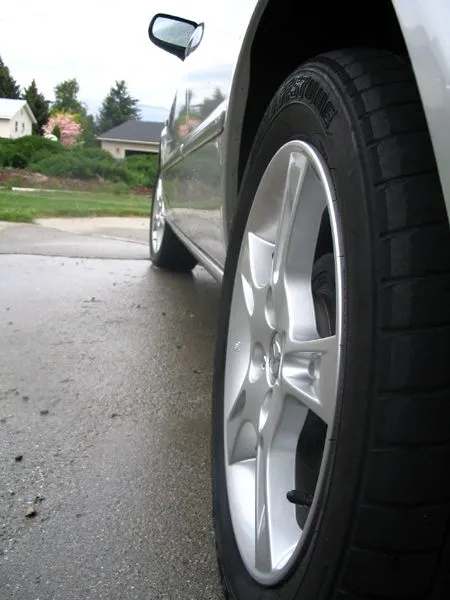

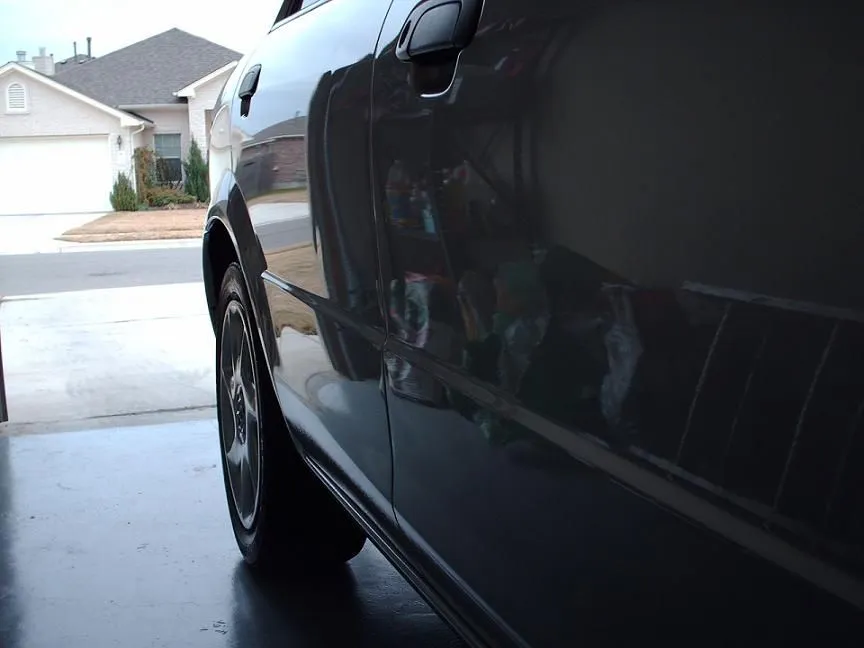

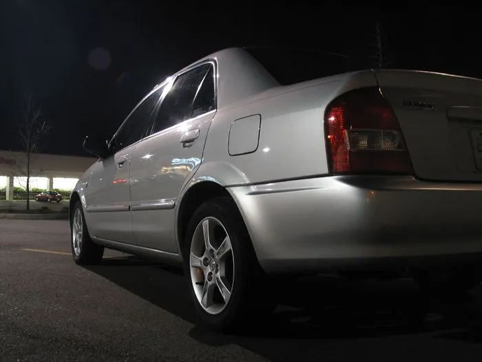

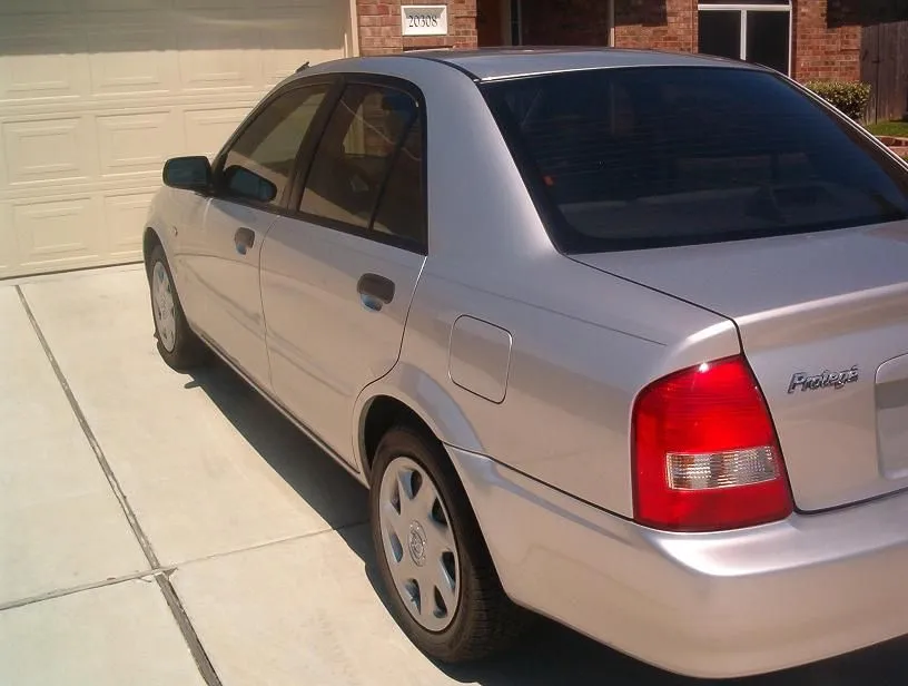

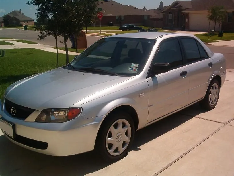

My computer crashed a while back and I lost basically all my old pics of the car with the side moldings on but here's the best I have right now of a before & after:

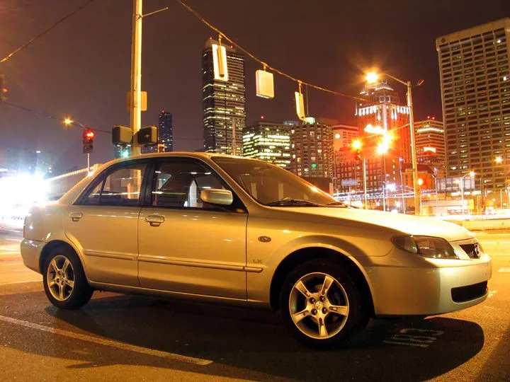

few pic with..

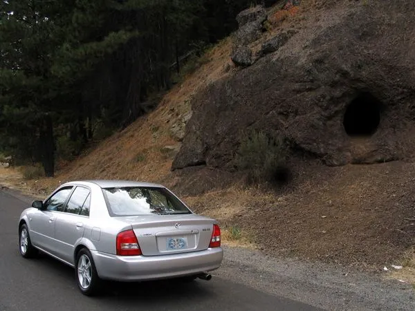

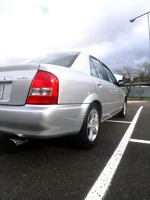

few pics without..
