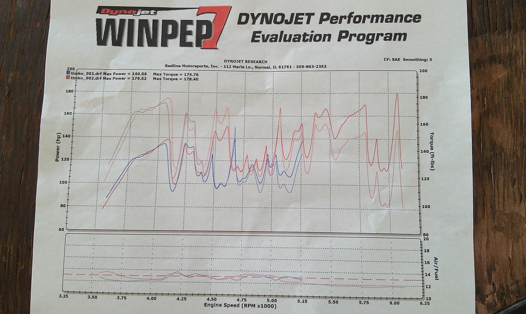

Well, reviewing the datalog with a different mindset allowed me to see a few things of note.
When the boost hits the target range of choice, AFR's go from 11.8 to 13 in places. At the same time, timing starts jumping from 20 deg adv, down to 16 deg adv, and jumps around in that range. Makes me think that the car is going lean due to a fuel delivery problem, and the ECU is trying to do whatever it can to get it to return to the target AFR.

Well... here's the dyno graph for my car. As I've said... the car runs like absolute s***.
