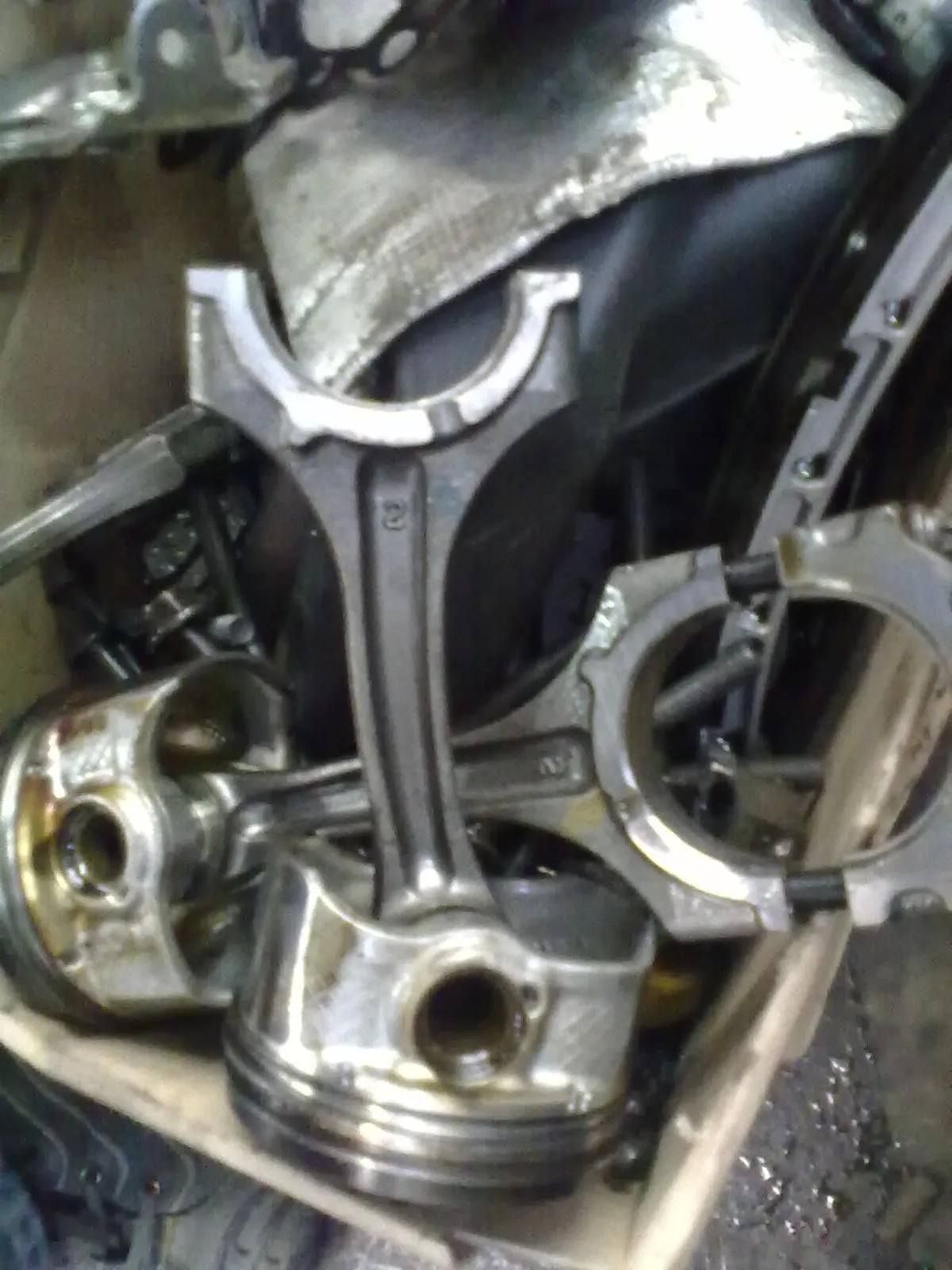

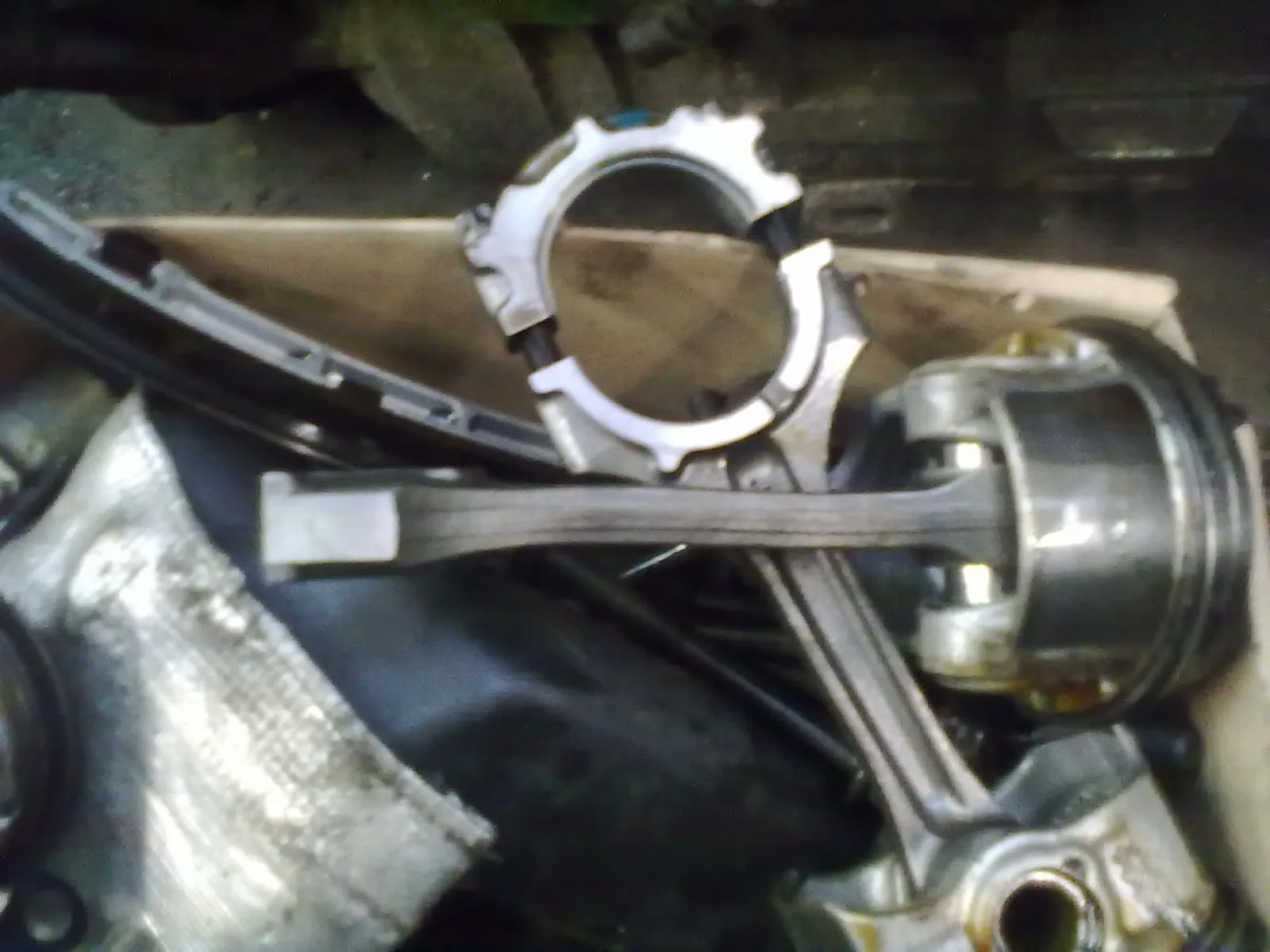

Now the engine is disassembled, I bent a rod in 4th cylinder. Looks like the mirror is fine, so now we are getting out the crankshaft. Balance shafts are already deleted. Rods and pistons are going to me, shall get them by thursday. Will update here also.

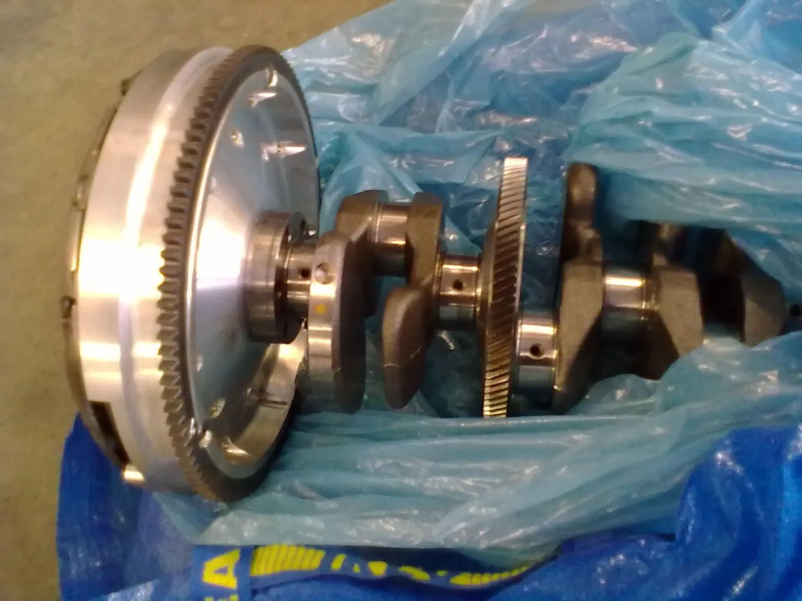

Balance shafts are deleted, so I took my crankshaft along with single-mass flywheel and clutch, and got it to dynamic balancing machine shop. Had to carry it there by myself as no one helped me :(

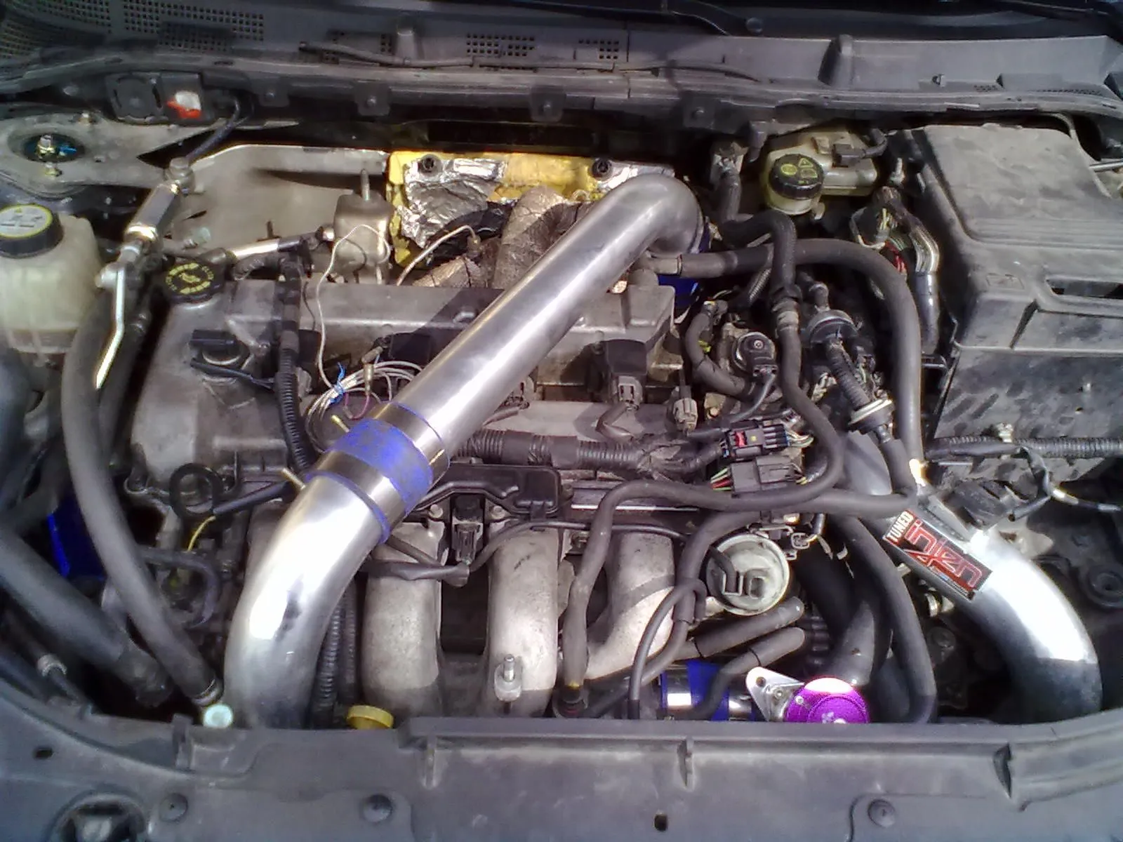

Then we got the motor assembled with all the new stuff - fmic, new aem filter for my intake, thermo-gasket for intake manifold, rewelded also extra-O2 sensor stub to make it fit with exhaust manifold. I know, engine bay is dirty - shall wash it when it gets warmer.
Also put coilovers, not very properly set up so far, but anyway. Really have to make my ass higher, don't like the rear view now.

Single-mass flywheel and BS delete are not so bad! But I properly balanced all the crank with flywheel and clutch.
Also adding photos of two stock rods being bent... Enjoy :)
