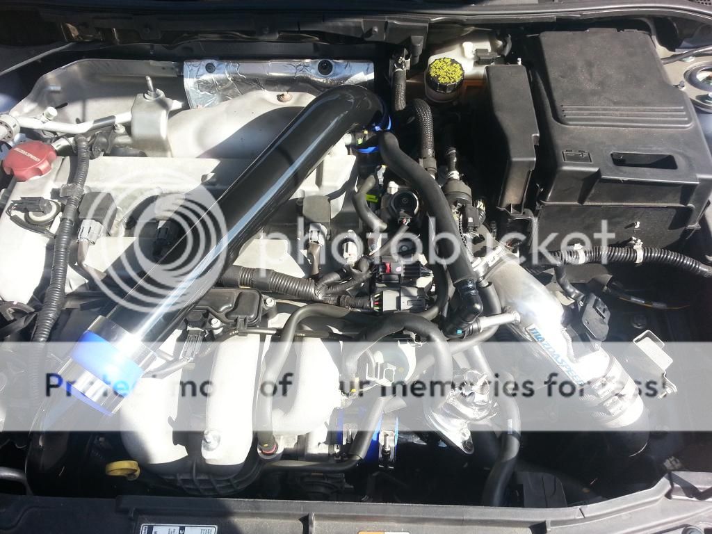

Well longer after owning this kit i decided to install it 2+ years later.And now i know why PG no longer exsist as distributor on here .. first of all Mr. Ken from PG gave cheap chinese clamps no t-bolt clamps...bolts would just over thread themselfs and break..2nd passenger side piping did not reach intercooler and was off by like 4 inches so i had to use a longer coupler to extend towards the piping... piping is tight fitment bracket for intercooler works fine but looks flimsy hopefully it dosnt break.this kit came out longer before there was a professional kits made for the speed 3 with that being said i guess thats what is expected .. But after install i was very impressed by how much more power the car gained 1st,2nd gear have no traction at all i have to litterly fight the steering wheel did not have this issue before install top end seems smoother and power dilivery dosnt just die like it used to.. overall very pleased with performance.

I got the same crap clamps with my M3M FMIC. It's worth it though, makes the car feel much better!
