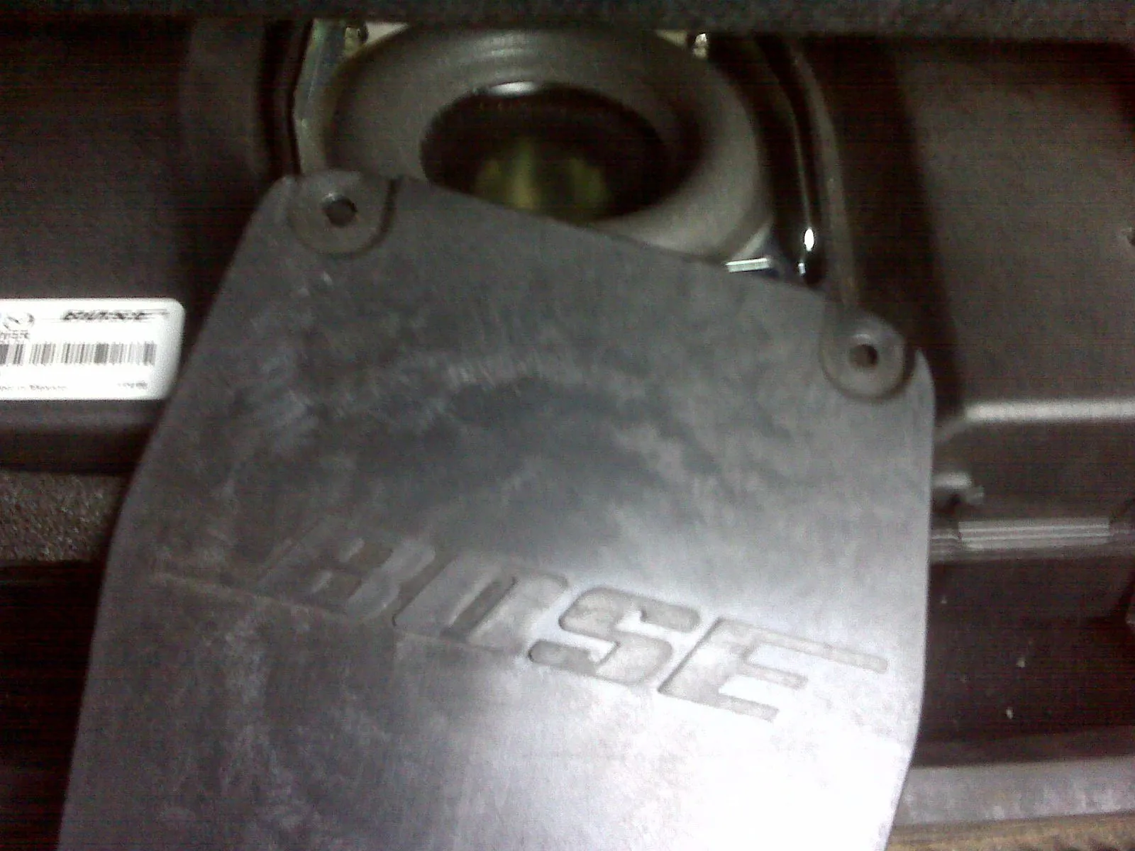

I figured out that I dropped a tic tak (other people might drop change$$$) into the subwoofer system under the passenger seat, that rattle and annoys the crap out of me. But it fell into the opening of the little system under the seat.

It was change in the sub 36 cents lol
8 screws and pull the sub out and get ur change out
dont over tighten the little screw or u will brake them off
