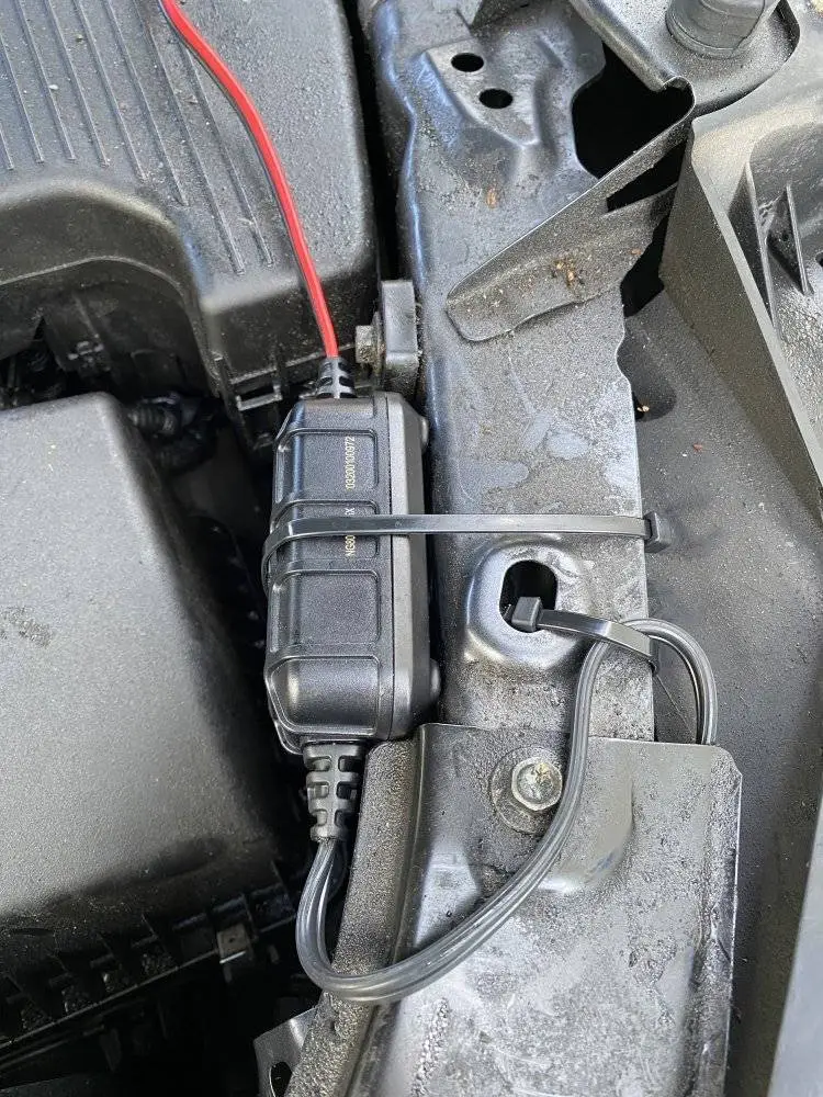

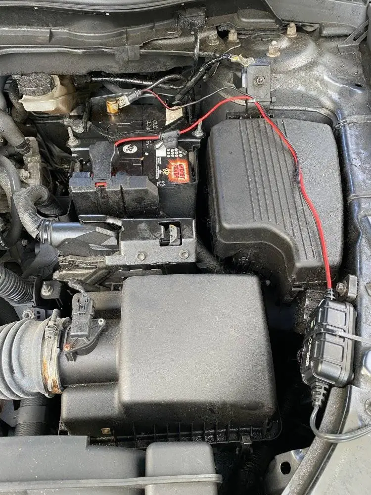

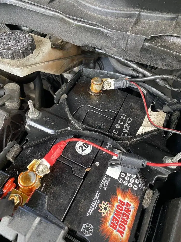

Yes, I direct-mounted it under the hood using the o-rings it came with.
I thought about that but I wasn't sure where to mount it.
So you have the 110v plug sticking out of the grill? That should be a convenient location. Do you have any pics for your installation?

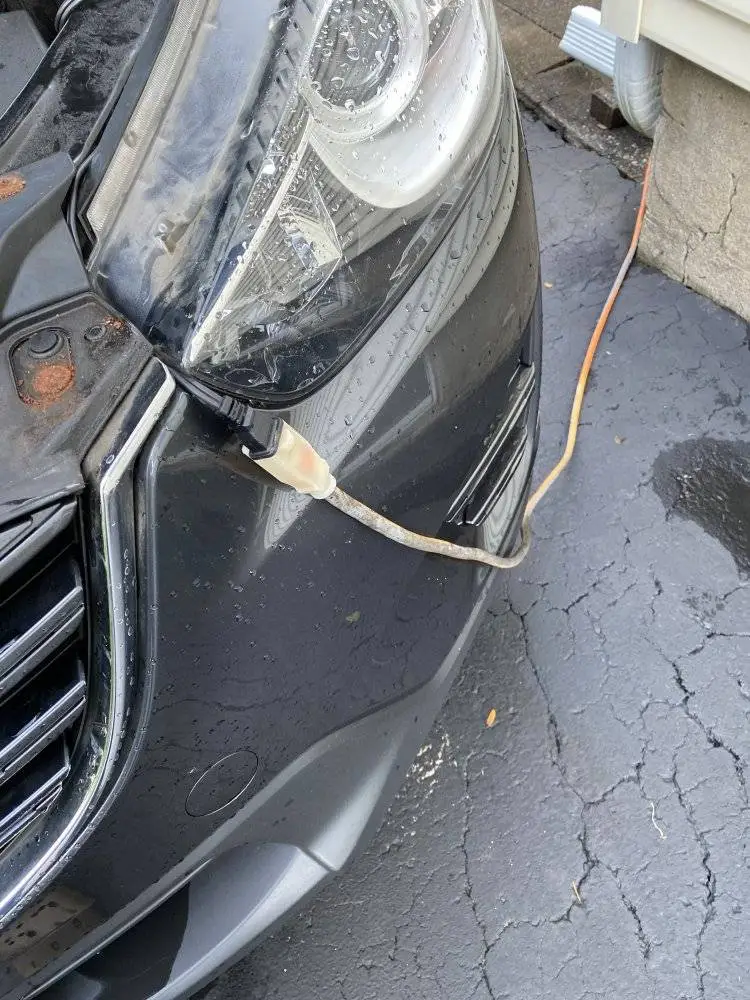

I really wanted to route the 110v plug such that it stuck out of my grill, but I couldn't find a spot big enough to fish the head of the plug through to get it so it stuck out of my grill. So I had to do something a little different. I don't love the plug just kind of dangling there, but its working for now, and not terribly unsightly. One of the NOCO flush-mount ports I previously mentioned would be the ultimate solution here. I'm really not up for cutting a 2 inch hole in my car though, to install it.

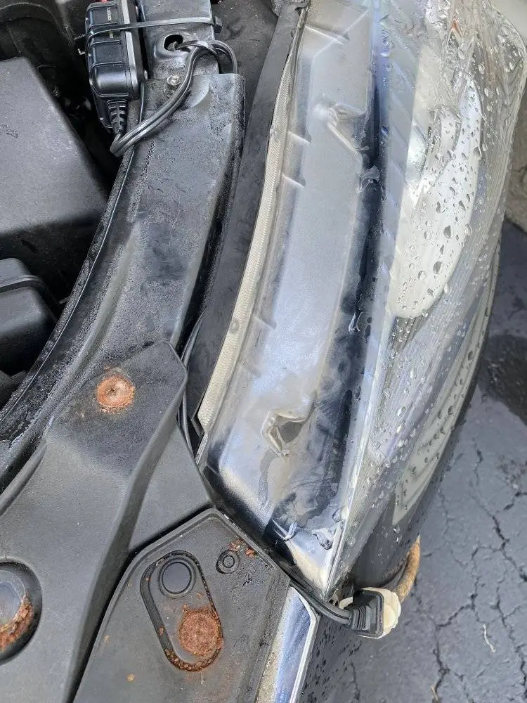

View attachment 304200 View attachment 304201 View attachment 304202 View attachment 304203 View attachment 304204
I guess if the plug doesn't flop around and bang up the paint on the highway. I always carefully try out my modifications and check things for problems.
They have all kinds of cables and mounts on Amazon. I ran a cable into the cabin but I had to remove the battery for access.
I thought about trying to run a cable to someplace on the bumper, but there are other things under there. A lot of trouble.
And drilling a hole is out for me, too.
