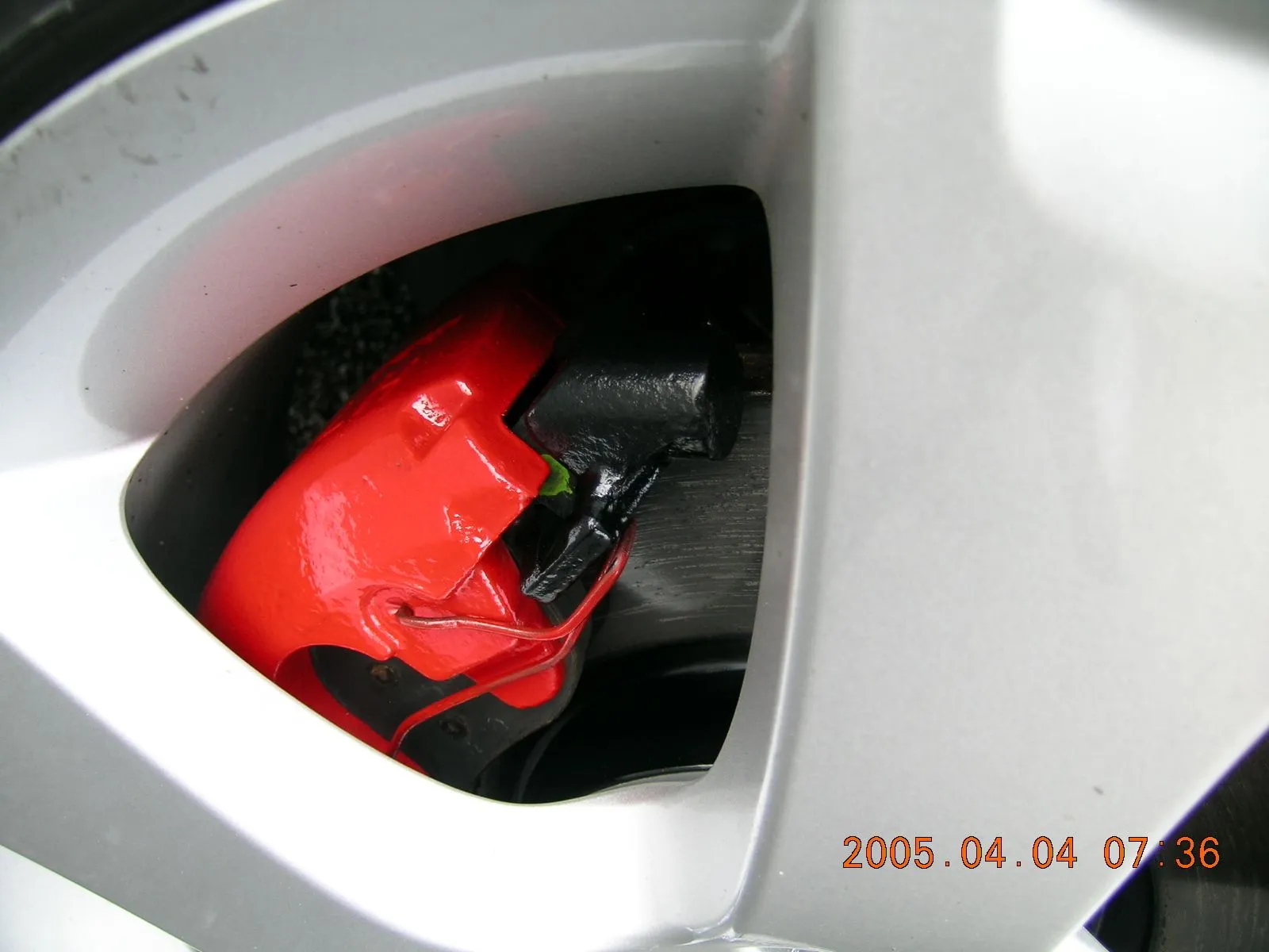

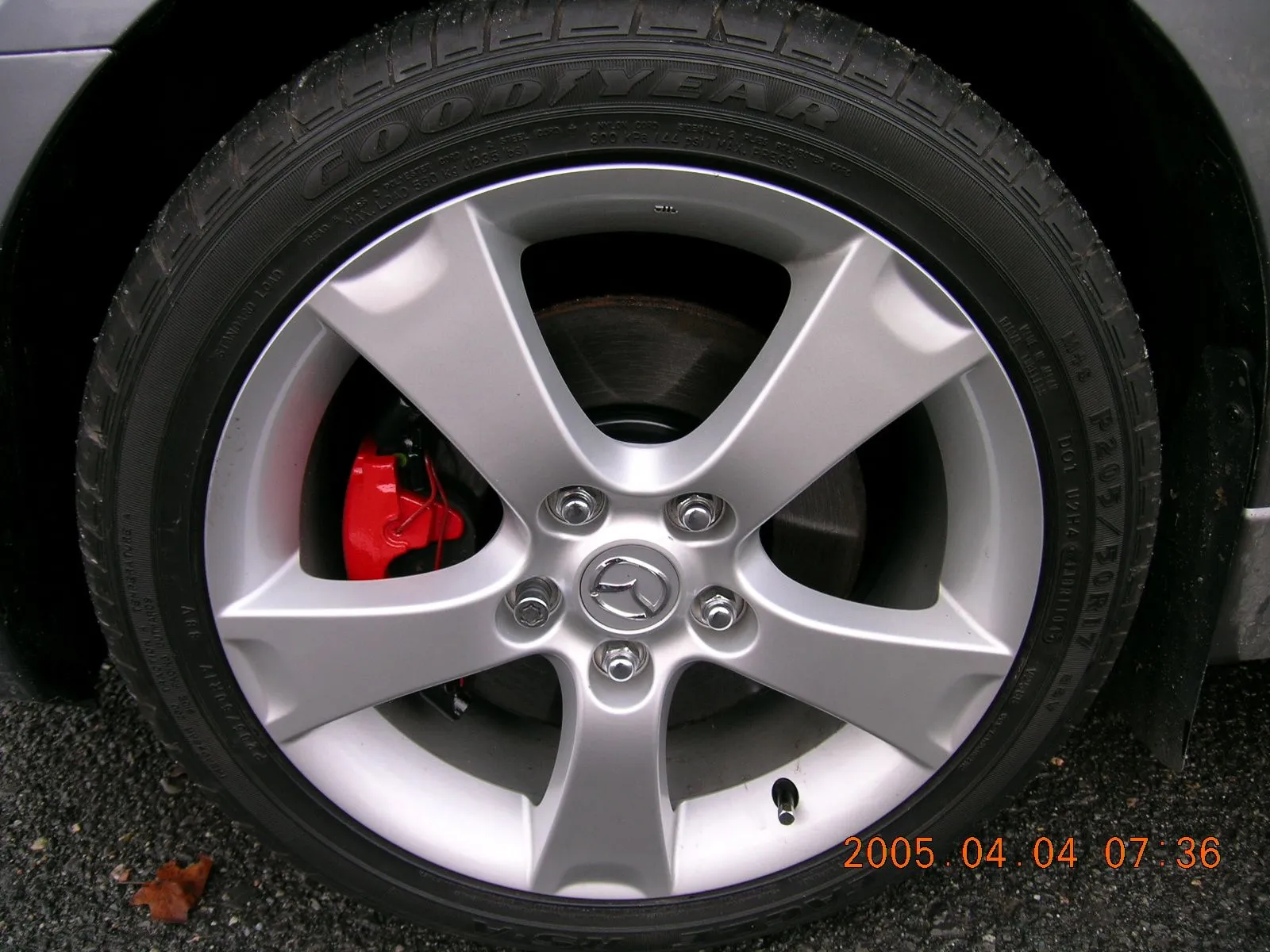

Spent the weekend sanding and painting the front and rear brake parts.
Something I should have done before this past winter season!
Used a paintbrush for the black color (2 coats of Duplicolor Ceramic Caliper paint), and a spray can for the racing red color (4 coats of VHT Brake Caliper/Drum Paint).
Here is the final result.
I hope this will last for a while.
Did you take the calipers off to use the spray paint or did you do it on the car? Curious because I will likely do it soon too.
I did not completely removed the calipers from the car, no need for this, just removed the Calipers from the brake disc. I hanged the caliper to the spring using a rope while I was working on the caliper/pad attachments using glossy black paint.
To remove the brake calipers, find the two allen key bolts hidden inside a rubber tube. Don't remove the rubber tube, just the end plastic cap, allowing access to the bolts. They are easy to undo.
Don't forget to remove the metal clip, which secures the caliper to the assembly. I assume the clip is a safety feature, in case a bolt fails.
Remove the caliper by shaking it up and sideways. It's a bit tight but not hard to do.
You can throw the pads away during the whole operation, they just fall appart once the calipers are removed, except for the front wheel, where the inside pad is clipped inside the brake piston. Just press on the clip to let it go. Easy as 1-2-3.
After I painted the black pieces, I spray painted the caliper. But before that, I covered the whole disc assembly with plastic bags (from grocery stores, perfect size!). I also masked the wheel well using newspaper, and masked the calier piston using tape.
I'm quite satisfied with the end result.
What you think?

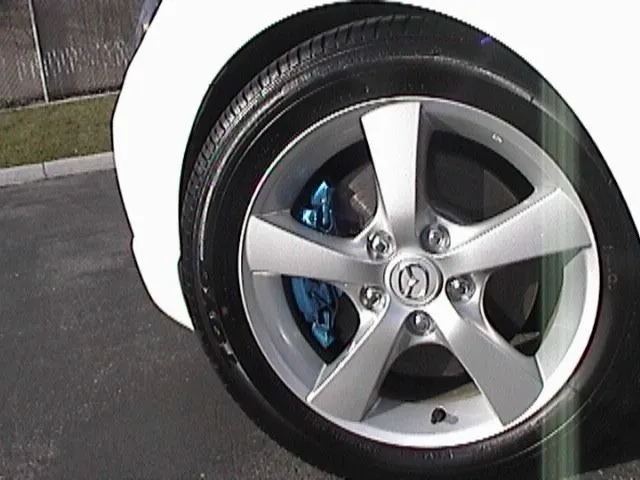

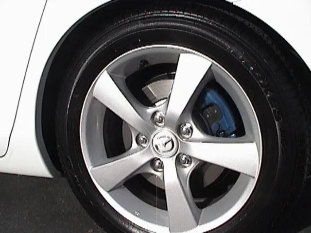

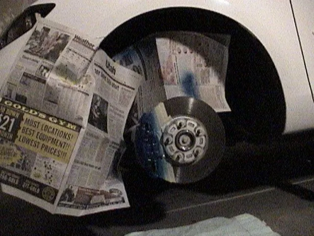

I painted mine a few weeks ago, all i did was take off the tire, tape stuff off, and shoved newspaper in the wheels wells then just used heat resistant spray paint. Worked great

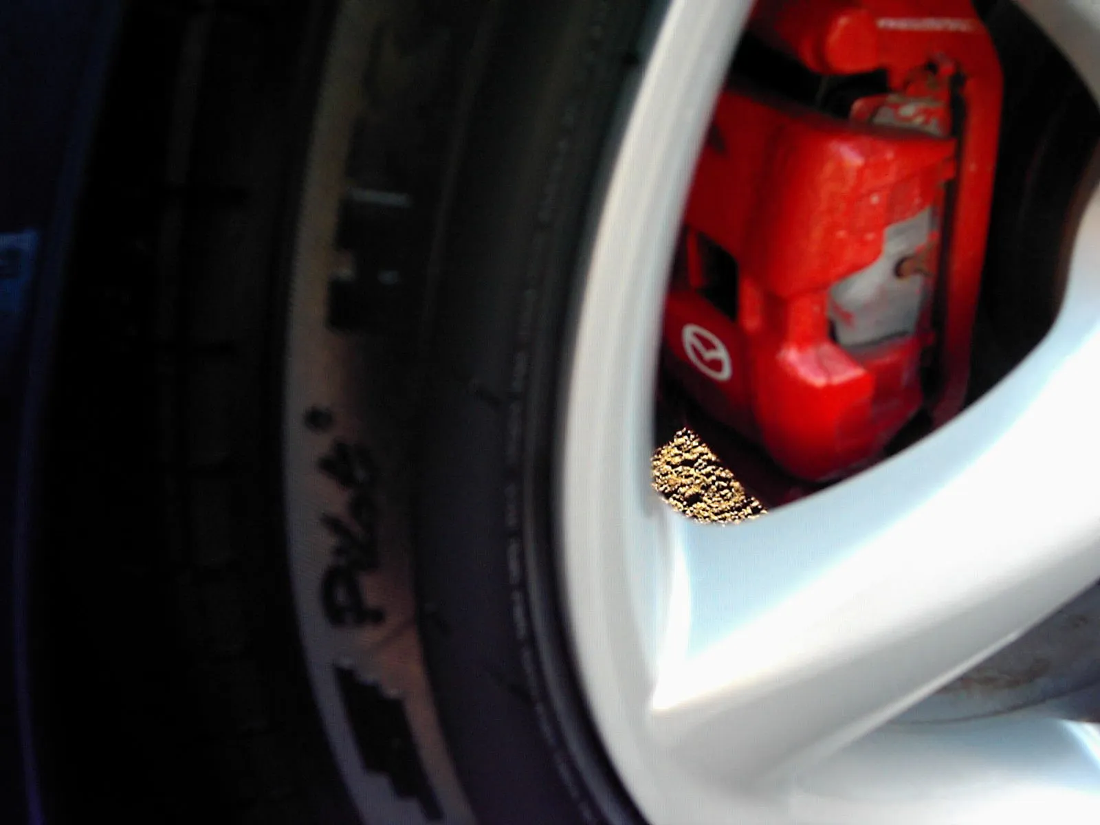

Here is mine.
I used the Duplicolor brush kit(red) amd Hi-temp spray(Black)
Removed the calipers form the disk, and removed the pads.
