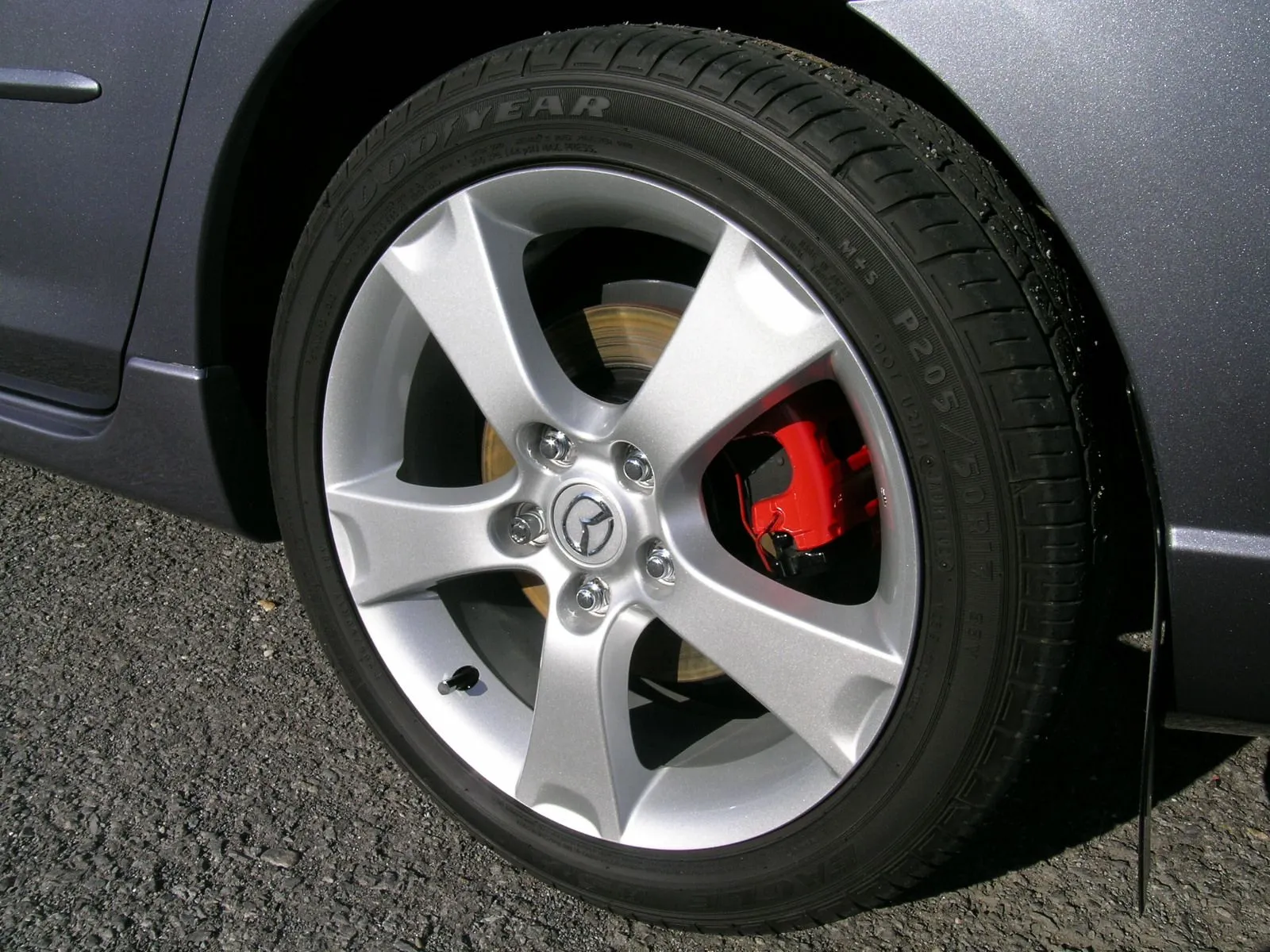

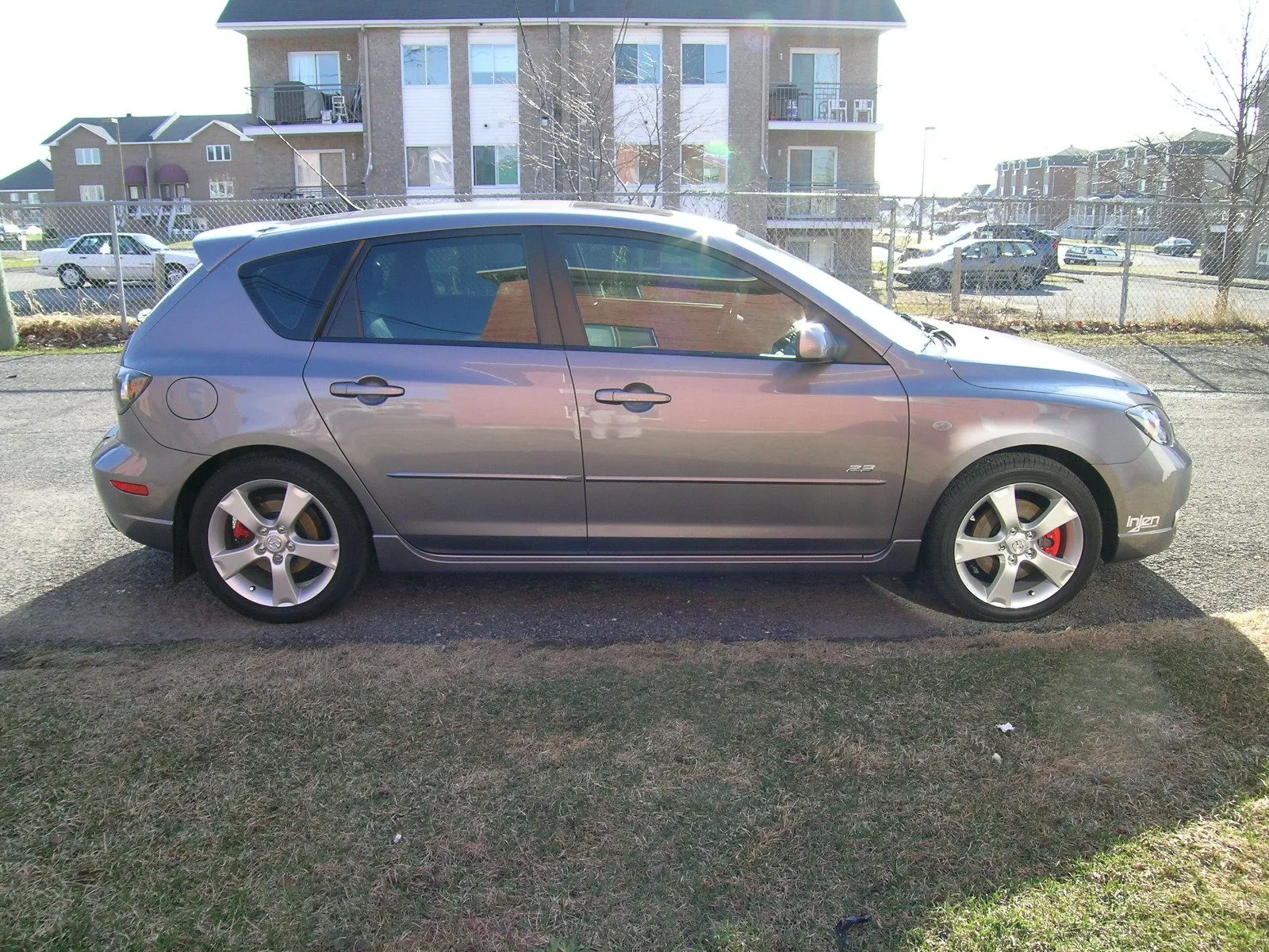

I did removed the brake pads and the caliper to paint to ensure a nice and detailed paint job. Therefore, as a bonus, I guess the paint won't interfere with brake moving parts, as all parts got painted individually.

Actually the caliper doesn't move that much at all. Especially if they have not been removed for the rotor. You will be find as long as the pads are not painted to the cailper. It might be a pain to get off if they are. This is why I removed the pads and the clip when painting mine.
I didn't say it moves a lot. I said it moves. It HAS to move for the braking system to operate properly, the same as any other disk brake system that uses pistons on only one side.
As far as painting goes, if you put paint on two metal parts that are supposed to slide together, then they will not slide and whatever system they are connected to will not work properly. That's ANY two metal parts, not necessarily the metal parts on the brake system of a Mazda3.
As long as these two facts are taken into consideration, then there will be no problems.
