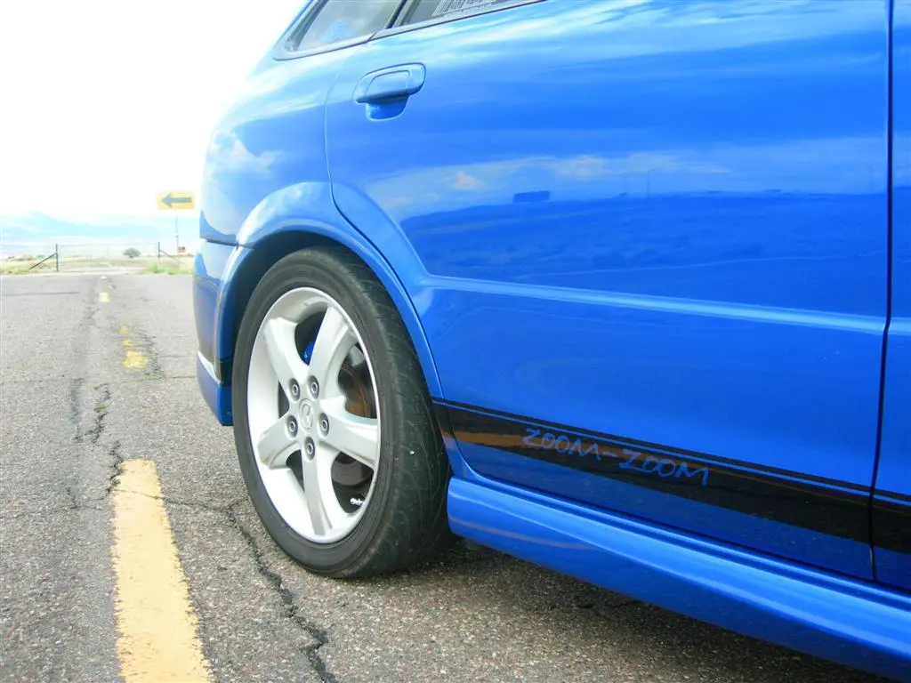

For my stockers I have Yokohama AVS ES 100, 205/45/16

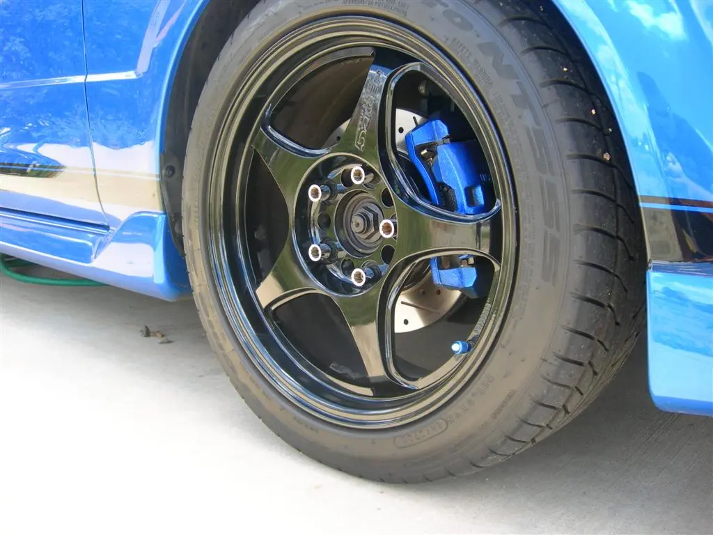

For my 16X7 5-zigen's I have NITTO 555, 205/45/16

215/40/17
nice stiff sidewalls let my car handle nicely and the speedo is almost exactly the same as stock
I forget what the offset is. My car is at the body shop right now or I'd go look. I get a little rubbing on the right rear when the tires are new. but a spirited trip or two up Mingus Mountain usually cures that ;)
