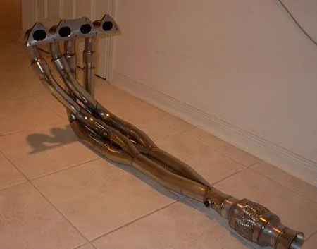

decent set of headers and you're well on the way dude.... of course, have the headers built for the next engine - but leave the runners marginally longer (in line with your current rev range) - That way you just get them shortened slightly when you go all out on FSDEmkII
how about getting a hybrid 4-2-1 designed?
I want long primaries with decent cross sectional area and a big merge collector, right? What about stepping and sequentially pairing the primaries? any thoughts?
