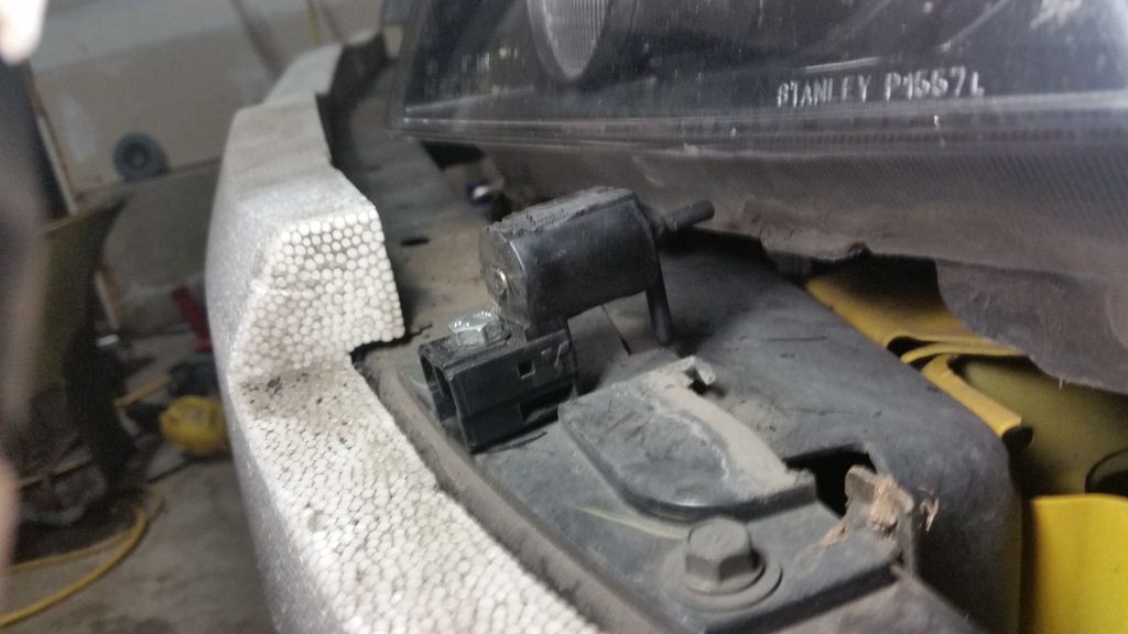

Figured you guys might like this. I had my bumper off last night, and came up with a solution to the broken parts. It was attributing to my bumper sag because both on one side were broken. so I wanted to fix it. It's an old vtcs/vics solenoid, haha.
I'm honestly going to do this because I snapped all of my headlight support brackets taking my bumper off the first time, during my build.
