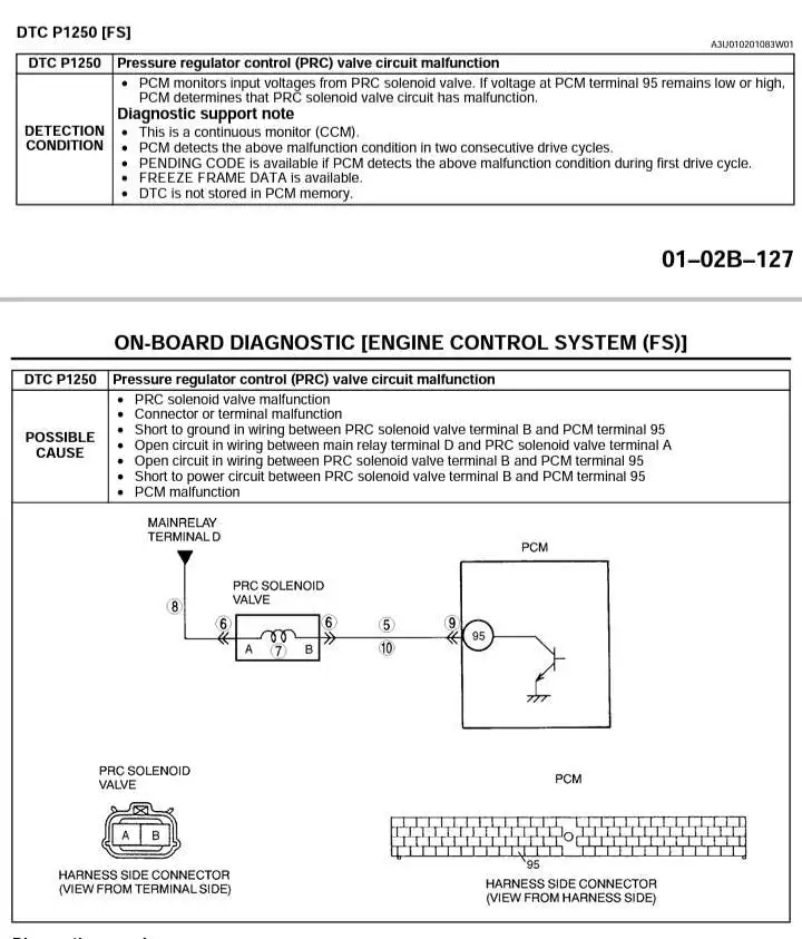

It's probably just your solenoid valve.
The ECU only monitors the valve and it's circuit. The ECU doesn't know if the regulator is working.

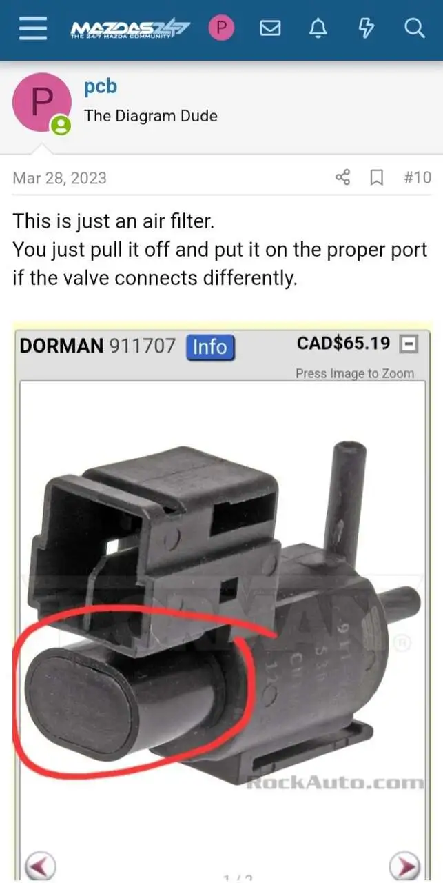

I had the same code and a new solenoid valve fixed it.
It's the same solenoid as the VICS and VTCS that we've all had to replace.
Does it matter if the vacuum ports are in different locations on the solenoids? The fuel one has a port under the connector and one the end, where as the VICS & VTSC are on the same side.
