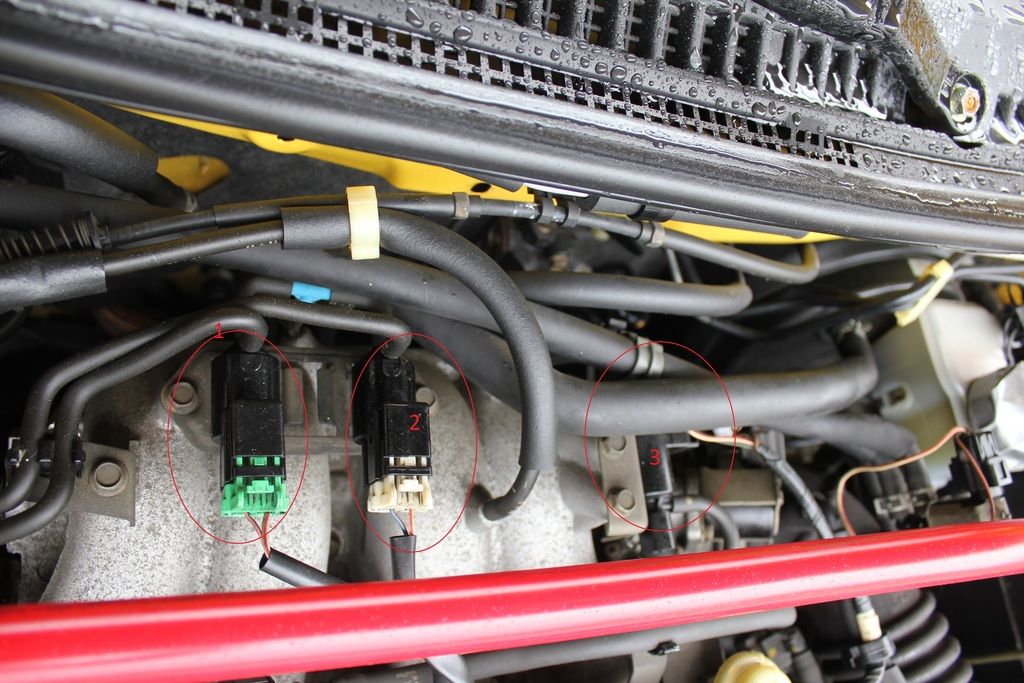

So, what is the PRC Solenoid valve? Is it this part?
http://www.partsgeek.com/catalog/2003/mazda/protege5/fuel_injection/fuel_pressure_regulator.html
Should I be replacing #3 ? or which one?
Sorry if this is a dumb question, but I just got the same code so I will be buying the same (#3 Solenoid) as listed above. But I also have code P2009 VTCS (intake manifold) which would be #2 listed on picture above. So is this same part as #3 solenoid?? They kind of look the same, can anyone re direct me to another Thread or which part number I need for #2 solenoid?? Thanks in advance
I'm pretty sure the solenoids are different but they may be interchangeable (I don't know)
The VTCS and the VICS solenoids are the same.
Quote Originally Posted by Natey View Post
See the green and white connectors right below the red strut tower bar? Kinda center-passenger side?
The white one is the solenoid that controls the secondary intake shutter valve. It's also called an EGR vacuum solenoid. The green one is the exact same solenoid, but it controls something else. Same part tho, if you're in the junkyard searching around either one will work.
If you want a new one, they're semi cheap and you can replace it yourself in 5 min with no tools.

They may operate the same but the connectors maybe different as well as the way they mount.
I'm trying to buy both VTCS solenoid valve and the VICS solenoid valve but I can't find them at my local auto parts store. Both Auto Zone and O'Reilly only have the Dorman Vacuum Switching Valve. Any idea where I can buy them??
If you are throwing the P0090 code, then you need the PRC solenoid valve.
VICS, VTCS, FPR, EGR should all be the same, the vacuum lines are just hooked up differently. I've replaced 3 of them so far. And have two or three spares from parts cars left. The purge solenoid is that one that's different, as it is pulse width modulated rather than just opened and closed
