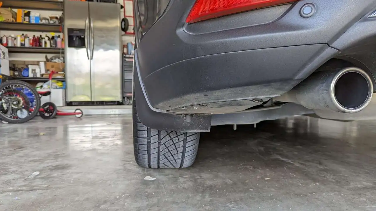

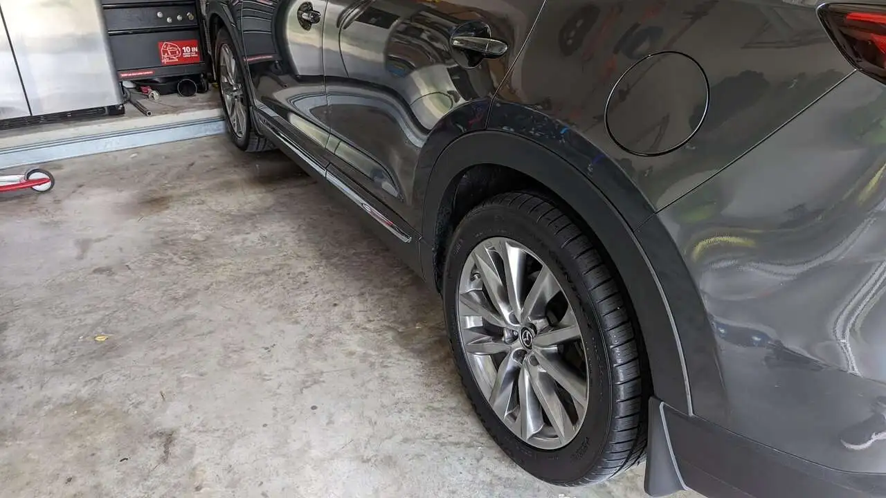

275 45 20. way better traction and handling. same mpg so far. mines a fwd so alot better grip on from stop with these since i don't have a rear diff for better grip, but it's still a fwd......🦼
Interesting. Thats the size I was looking at until I noticed tire/wheel charts pretty much agree a 8.5 wheel is not wide enough for a 275 tire. Yet I noticed you are running Conti dws 06 where the Tire Rack specs for this tire says ok wheel width is 8.5 -10 inches. How long have you had your tires and I assume no wear or handling issues?
had them for about a year now. about 15k miles. no wearing issues. i run them at 36psi. discount tire was ok with installing them on a 8.5" rim.
