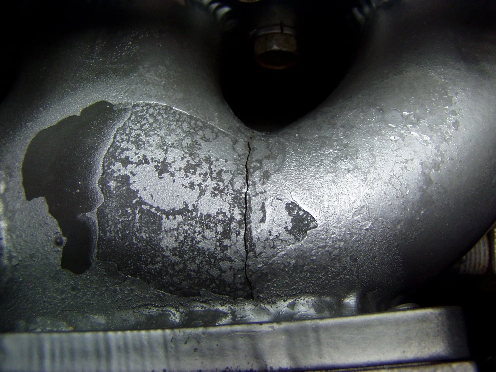

i just took my mani off to get welded...all three main welds are cracked
:( beau offered to fix it for me and have it recoated, but i can't wait and i know he is backed up the ying yang! $70 for the weld+ 120 to get recoated...

update: the fabricator that is welding my mani just called me, he spent 3 hours fixing my mani, he said the original welds were not of high quality and were not V'd out so the weld would hold..(glare) .surface welded..the stress and heat did it in..he redid all the welds, even around the wastegate flange...3 hrs @ $70 an hour..(shocked) .wow! he of course said it would, or shouldn't crack again! pics up tomorrow

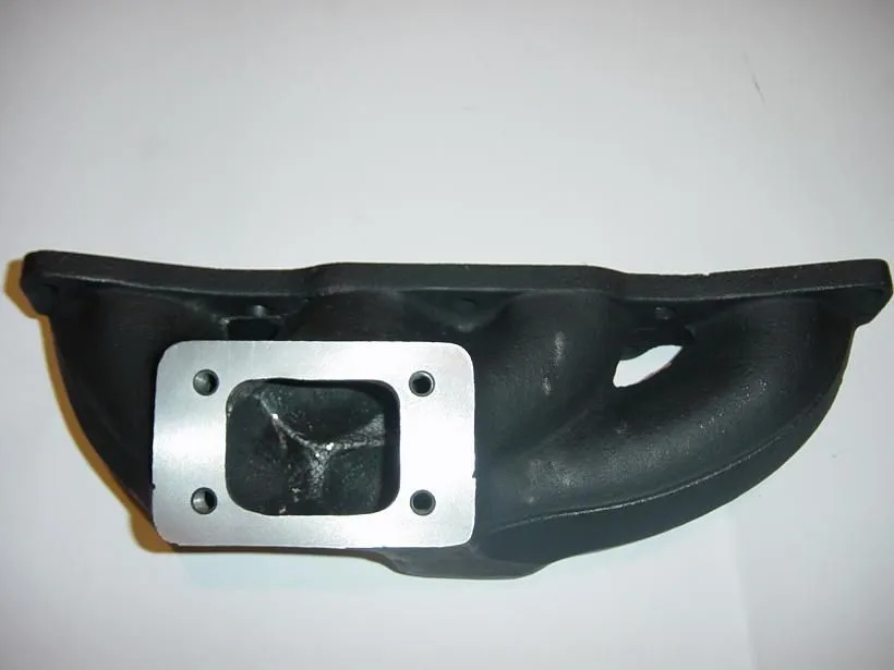

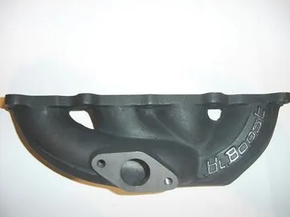

Get our manifold and you will have no issues like that in the future. It has been proven that the only manifold that lasts thru the years is the cast iron one. They do not look as fancy, but will work for long time.
