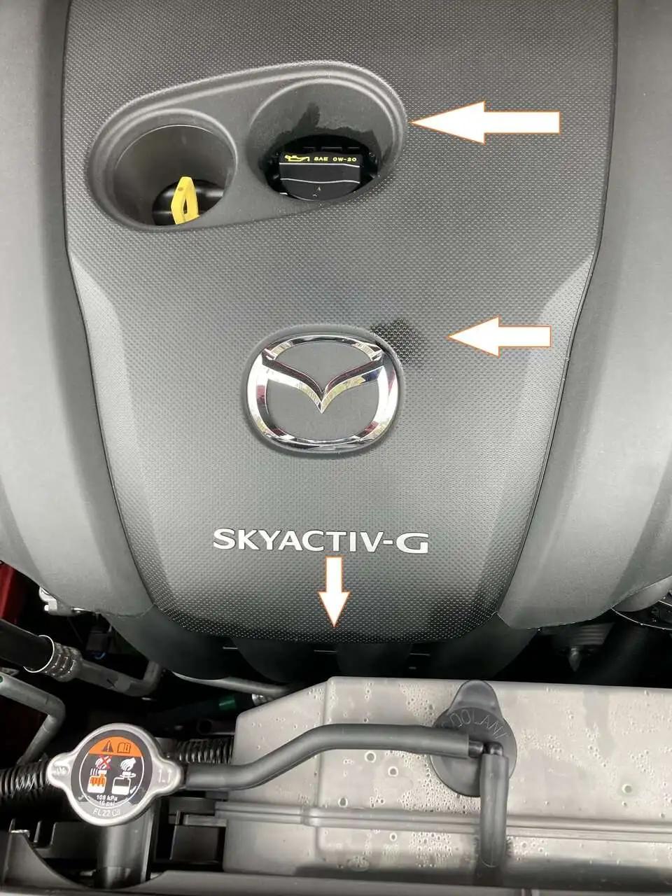

Hello
Just to do some inspection, I opened the bonnet today and saw some oil patches on the engine cover. I checked the entire bay with a flash light and luckily see no oil dripping or leaks.
Total miles on car: 3500
First oil change done at 2500 miles after a 1000 mile long trip.
Any idea, what's going on here?
Did you do the oil change yourself? If not, then the place that did it was very sloppy. Nothing to worry about but don't take it to the same service place again since its likely they just don't care enough to do it right and that's bad news if they screw something else so simple up.

The service person just wanted to make that the O-ring was well lubricated. Why some of us get paranoid over nothing important. Now comes the justification blow-back. LOL

Pull the cover off. Three or four? push-pins anchor it to the engine. Look at the oil cap. Remove it, and check to see if the sealing rubber is intact. Clean and replace the cover (or leave it off if you like a little more engine nose, a bit cooler engine, and an easier view of upcoming oil leaks, mouse nests, etc.

Good advice but personally I wouldn't leave the cover off. It helps keep the top of the motor clean. As for better cooling and more engine noise with the cover off? Negligible.
There are four of those push-pin anchors. While you have the cover off get some grease or some sort of lube (petroleum jelly (Vaseline) works well) and lube up the anchor points. This way the cover will come off easily the next time you remove it.

The spot next to the logo suggests it's just sloppy work. Evidently the chances of a gen 2 normally aspirated engine leaking or consuming oil is near zero.
