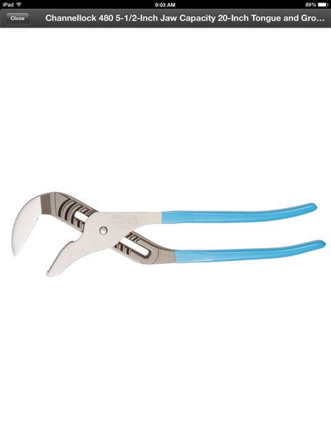

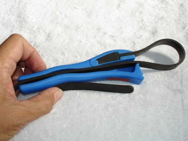

After using almost every custom tool made for oil filters, if I encounter a filter that slips on the custom tools, I go back to my tried-and- trued-
I haven't found a filter it couldn't remove, no matter how tight it was.
Works better than channellocks or flute sockets...
I find that I snap those types on really stuck on filters after a year of use or less. I have 2 or 3 of those types broken in the bottom of my graveyard known as my bottom tool box drawer. Also, it can't get some of those Fords that have filters way tucked up at a weird angle next to the rack n pinion. But, I'm straying a little away from the subject, that should work fine on a CX-5.
I've had to do that several times, too, hehe. Punch it through with a hammer, turn, discard filter.
