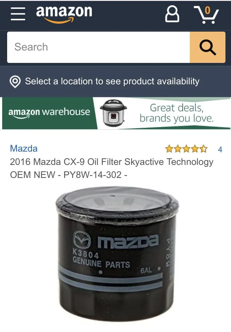

Just a reminder, if you really want Japanese made, Tokyo Roki PY8W-14-302 oil filter, make sure to communicate the Amazon seller first. Most likely you’ll receive Thai made, Denso 1WPY-14-302 oil filter and the seller will claim the PY8W-14-302 has been superseded by 1WPY-14-302.Thanks everyone for all your help. I'm going to try the Amazon part PY8W-14-302.
The picture shown from this Amazon seller is not said Japanese made Tokyo Roki PY8W-14-302 oil filter; but it’s Thai made Denso 1WPY-14-302.Can anyone verify through actual experience that this filter also works for the 2019 CX-5 GTR (2.5L Turbo) ?

See post #9 and #11 above ⋯i bought from that exact listing and they send you the Thailand made. I contacted them but all they say is it's the same part for US market. After all its still valid for our cars, just wish they specify the exact model number instead of lying to people.
