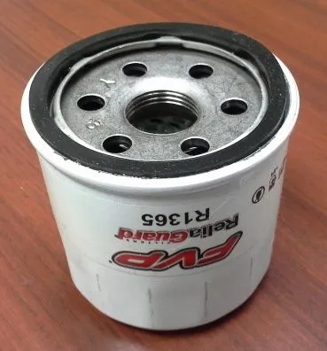

There are lots of comments and threads about this subject, but figured I would start a new one. I was going to do my own oil change so went to dealer to purchase an OEM filter #1WPE-14-302, cause I like using OEM parts. Earlier this year the CX5 was at the dealer for some warranty work, which included an oil change. So while doing my own service, found this strange looking filter attached to my 2.5 Skyactive engine.(uhm)
FVP #R1365. Never seen these before so this is what I found on the web.
https://www.fvpparts.com/products/filters/oil-filters/
Could not find any specific flow rates, etc. but did notice this filter fits on 192 different applications, as per the website. Yep, special app just for the skyactive motor.(unamused)
This might be a perfectly good filter, who knows. The thing that really urks me, is the dealer has signs, posters, advertises that they only use quality Mazda products.
I did discuss with the GM on why the aftermarket filter. His response was that it has to do with costs, and that it's a perfectly good "Mazda warranty approved" filter. The plot thickens, at the time, I didn't know what they sold me, but now looking at the work order it lists the MAZDA PE01-14-302B. So they charge for mazda filter and install the aftermarket.
Dam, I'm going to have another little chat with them. This is the type of great service I've been dealing with over the couple years.
But hey, all you DIY's, you can now buy an approved aftermarket filter for your Mazda's (enguard)

wow.. that's some bulls***.
I'm sure the filter is fine (probably not as good as OEM, but good enough), but the fact that they lied on the work order is really sketchy.
I wonder what they do with the OEM filters they don't use for oil changes? Maybe they resell them online for a nice profit?
@sekmor, I think your decision to do your own maintenance is a very good one. Always try to avoid the stealership as much as I possible can. Just keep those records safe.. As for the OEM or not question. If the car is under any kind of warranty, personally would only use their recommended products if it's listed.

Id report this to Mazda of Canada and see if they can do something on this as Wix 57002 is the only aftermarket oil filter made to meet specifications for SkyActiv-G engines.
I have done all my maintenance since I was 14 years oil but, it is getting difficult now that I am within months of being 80 years old. If sekmor wants to let the dealer do his oil changes then he should demand UpFRONT that OEM oil filters be used. Ed
I normally do my own maintenance work on our vehicles. The CX5 happened to be in there for warranty work, which included engine work. I had just done an oil change before that (with a mazda filter). Sort of a waste so I told them to use the "Mazda" labeled 1L oil jugs, not the bulk generic oil. Didn't say anything about filter since I assumed it was mazda. The work order does say 5 each of #0000-23-0W20-CA. But who really knows what they put in there.
I'd give Mazda of Canada a call. This is very fishy and it sounds like your dealer is pulling a fast one on Mazda and you.
