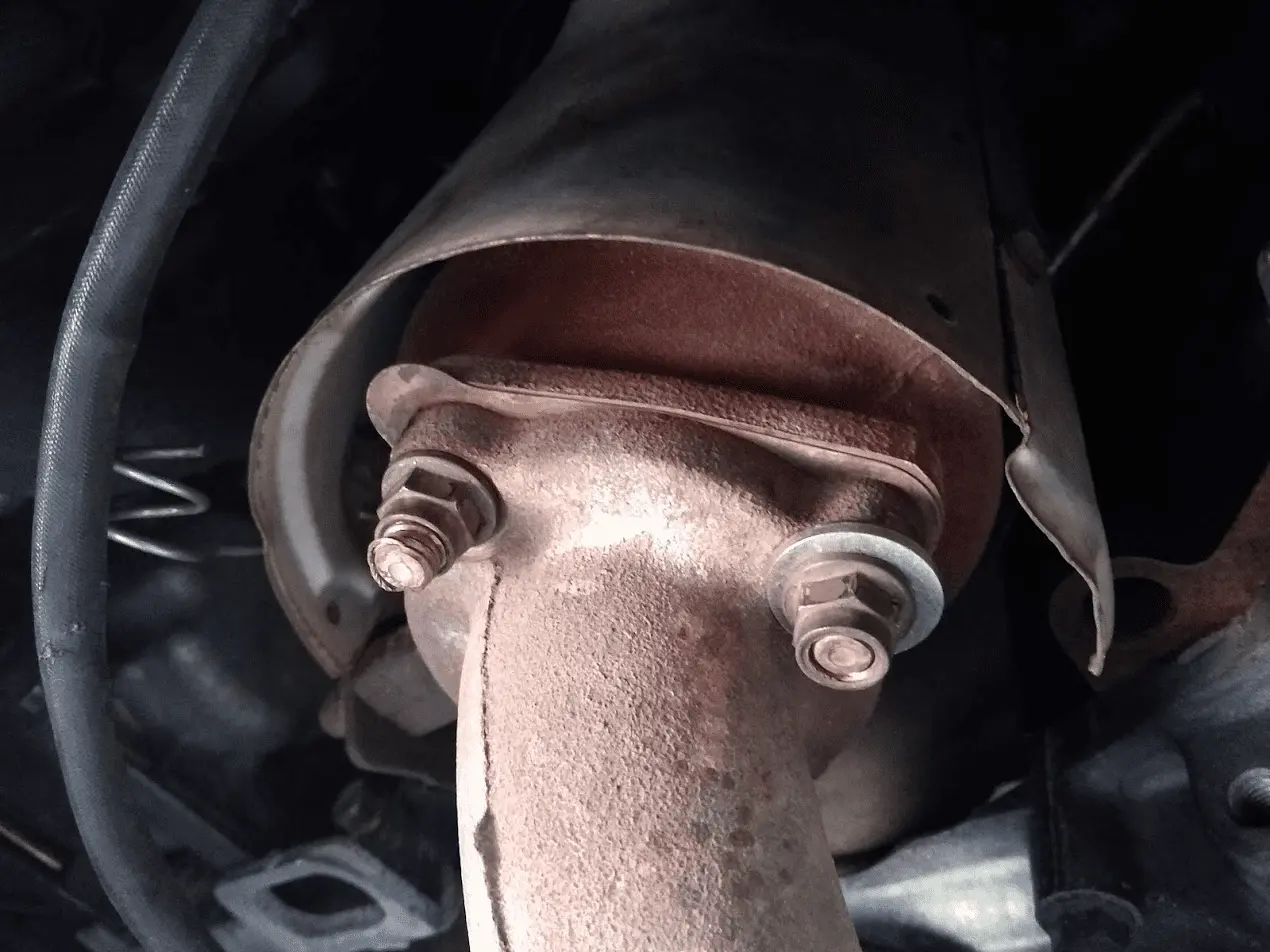

So it has finally cooled down in Dallas, so I put the car on ramps and tried to replace the donut gasket. I really struggled trying to put the gasket on straight, and it looked like removing the J-pipe is necessary to do it properly, at least with the Rock Auto gasket. It was simply too snug for me to slip it between the two end flanges and tighten it up and have it remain straight.

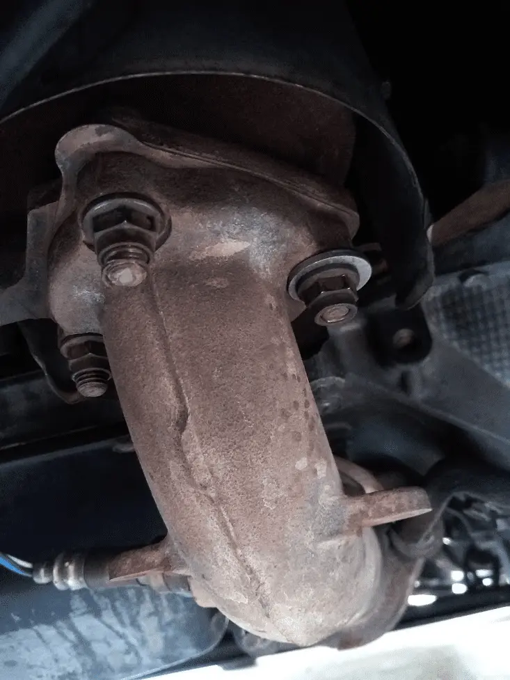

When I went to remove the J-pipe, I looked up and saw something curious: A washer similar to what's shown below on only one of the three "two-piece" bolts. Since Mazda would never have used one random washer and I didn't put it there, I knew it was from the engine replacement and that it was a workaround. When I touched that washer it moved, so I knew that the bolt there wasn't tight. With the engine running and making the weird noises, I pressed the super-duper thin metal gasket just above the J-pipe (shown below), and the noise stopped. I added another washer to keep the bolt from bottoming out in its hole and that allowed the two parts to join flush. No more warbling/duck exhaust noises. I put the original donut gasket back in because it's a little more substantial than the replacement and I had kinda' damaged the replacement trying to install it without first removing the J-pipe. A slightly better repair would be to adjust what I'm calling the "two-piece bolt" to effectively shorten the bolt so that it doesn't bottom out, but I was afraid to damage the threads by doing that, hence adding the additional washer.
The two springs on the other end of the J-pipe that join it to the downstream exhaust: If they had to be fully compressed while tightening to get to their recommended torque values, are they shot and in need of replacement? There doesn't seem to be much flex in that joint with those springs fully compressed.
The other mounting stud that hasn't got the washer with it, has been hammered on! 🤬
Looks like someone had trouble removing the stud properly and just smashed it on instead. Not sure what the third stud (not in that photo) looks like, but that stud could be the only one that is sealing that joint. The other two studs are doing nothing.

Jazzy, the other "stud" looks good (see pic below). I wasn't sure why that stud and the stud with the washer were deformed. Thanks for that probable explanation and also for the word; I didn't know what the heck to call that "two-piece bolt" thingy. I did remove all three studs and their threads were intact and I was able to reinstall and torque them to their 38 - 51 Nm spec, so I imagine the threads in the pre-cat flange (or whatever it is) are also intact. The problem that I could detect is that that one nut doesn't tighten enough on the bolt, so I needed two washers to tighten it down. It definitely fixed the exhaust leak.

The nut on the stud with the washer is probably seized.
That's probably why it isn't threaded on all the way.
It's probably better to use a washer than to bottom out the stud and hope the nut starts turning.
