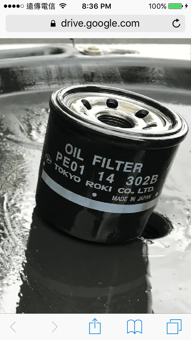

All OEM oil filters from factory on new CX-5 since gen-2 are PE01-14-302B. I believe Mazda North American Operations had decided not importing newer "B" version of Tokyo Roki's filter and switched to Denso's Thai filter for cost reason. Value line PE01-14-302A-MV is a cheaper version OEM filter and it looks not as high quality as Japanese and Thai filters.
Actually there's a newer PE01-14-302B oil filter in Japan used in 2017 CX-5. Not sure if this revised "B" version Japanese made oil filter would be available in the US?
attachment.php
